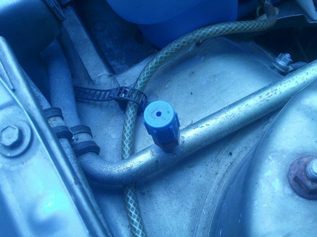

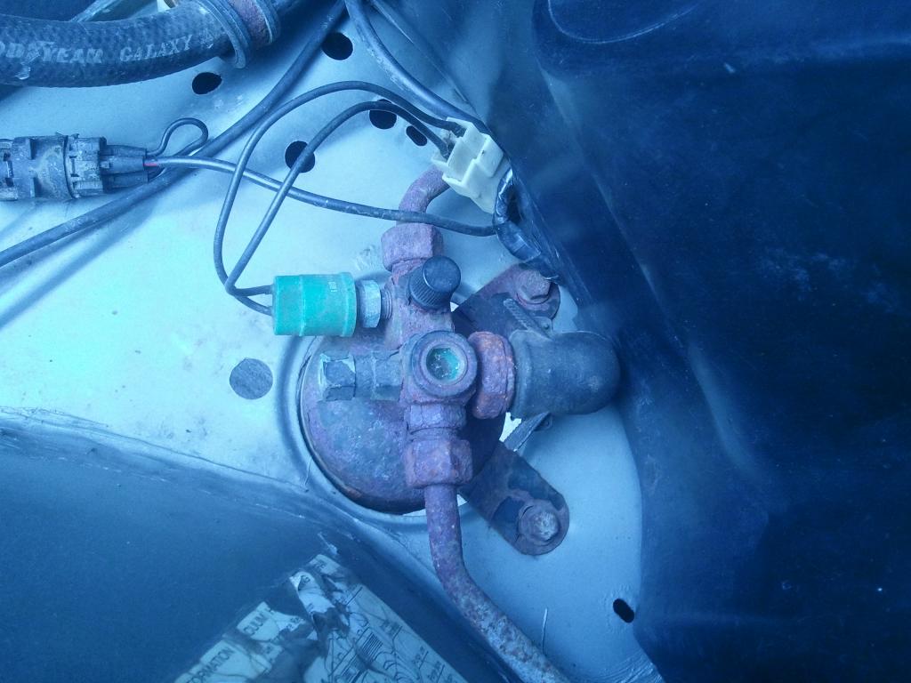

                        #191
                        So I guessing I still have R-12?

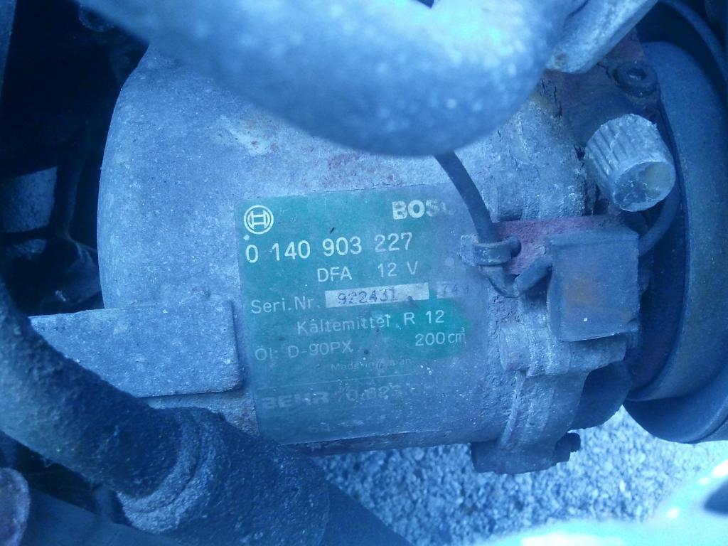

                        Must have missed it saying R-12, or can you use the same compressor?
                        The reason I ask is my ac doesn't blow very cold. If I leave it on fan setting 2 it blows somewhat cool air, but when its on full blast it can't keep up and just blows hot air. Also it seems like the compressor is turning on and off when I'm idling or at a constant rev, at least this is when it is noticeable. Could this be caused by low refrigerant levels or something else? Thoughts?

                          #192
                          Thanks,
                          Ray
                          hmm probably not the right place for Q&A sorry
                          Those are retrofit fittings so you most likely are converted. I dont know what model your car is or the production date but there is a service bulletin that lists the compressors and build date that are NOT r134a compatible. They all say r12 since that what thjey were designed for but mosty have r134a compatible seals.
                          It does sound like you are low on refrigerant so its worth buying a can with a fill hose and hoping that solves your problem.If not then you have too find and repair your leak, replace that nasty looking dryer, vac and recharge then cross your fingers.

                            #193
                            Alright sounds good. I did give the schrader valve a poke and the system, as nasty as it looks, is pressurized. Its an 88' ix not sure what the production date is but I'll check when I get off work. Might run the the parts store after work and pick up a recharge kit and see what happens.

                              #194
                              Thanks for the info!
                              Ray
                              You are on the right track. According to BMW these are the e30 vehicles and dates that are NOT r134a compatible
                              318i 7/85-8/85
                              325e, 325i, 325iC 7/87 - 10/88
                              325ix, M3 All
                              So if your ix still has the original compressor and it's fairy certain it is not suitable for a conversion. Since it looks like its been converted, if the compressor (or seals) were not swapped that could very well be the source of your leaks since the seals are what fails.
