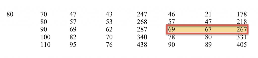

          #64
          This is what BMW said you should be seeing at that temp and humidity. So technically its correct, but kinda shitty. I've found higher revs help tremendously with our old compressors which means they're a little worn out. ;)
          80 is humidty, 69 is the vent temp, and the other two are high and low pressures.
