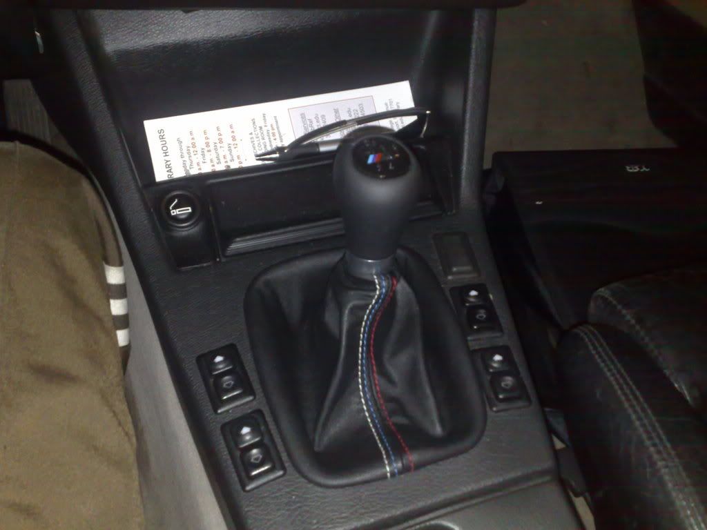

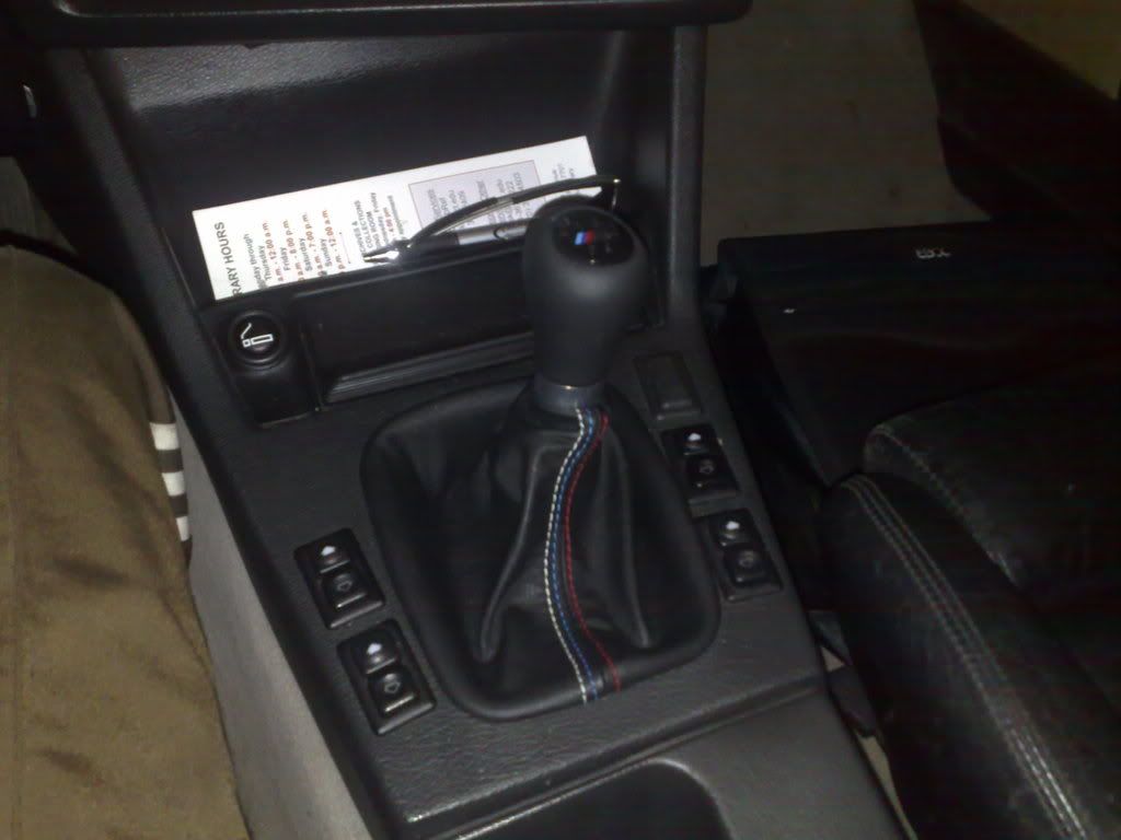

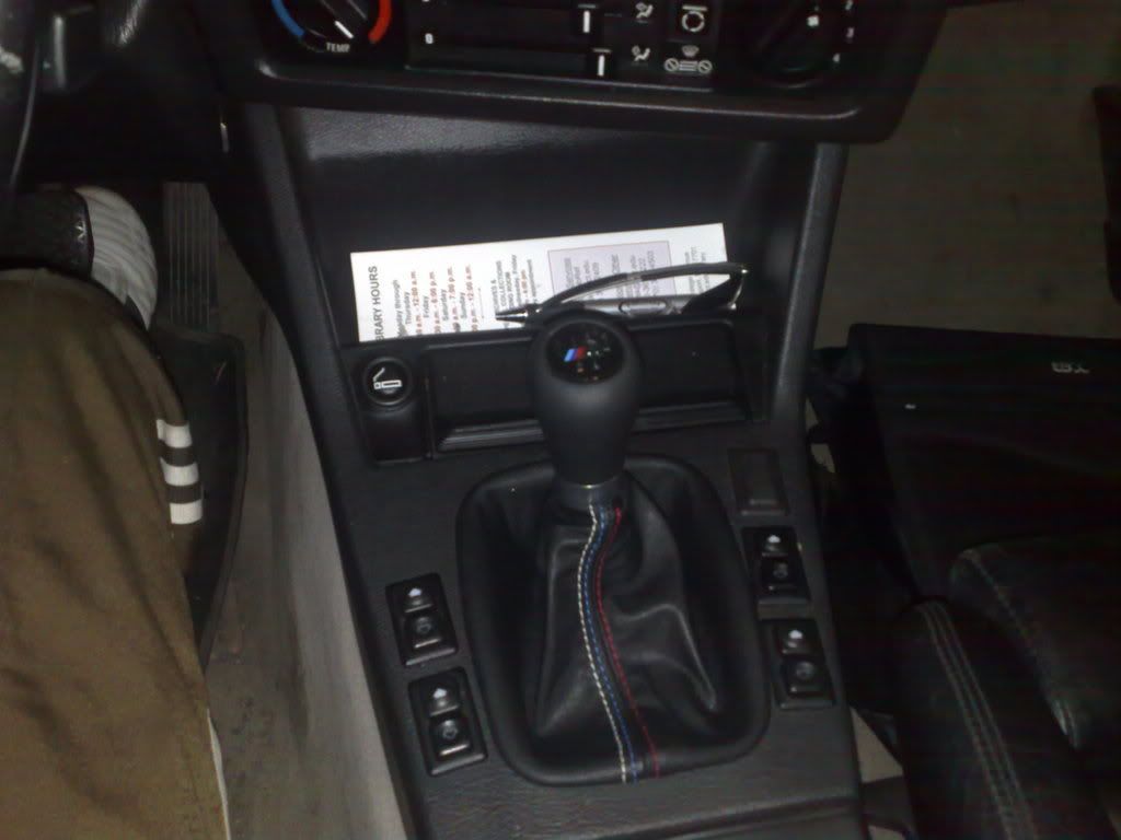

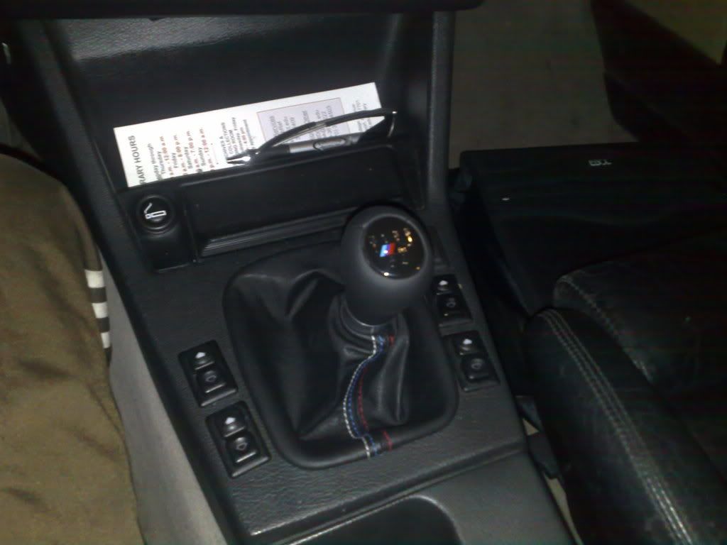

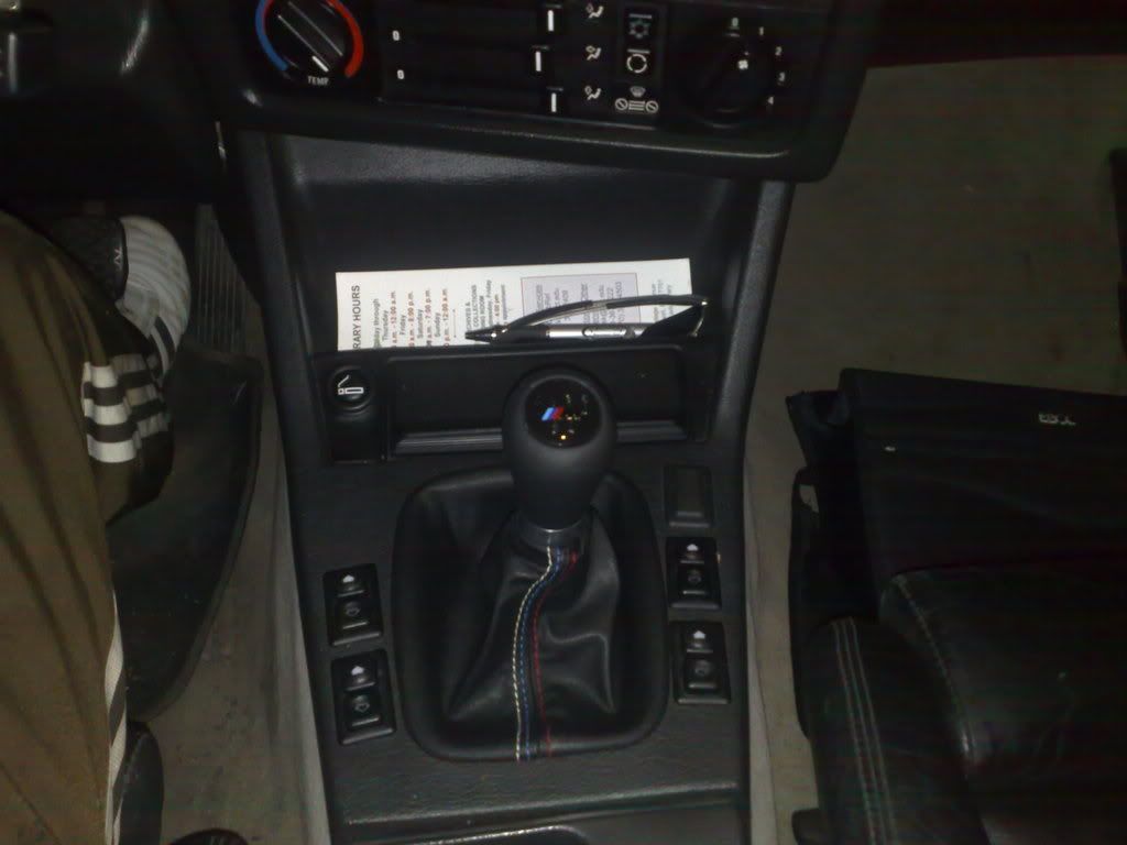

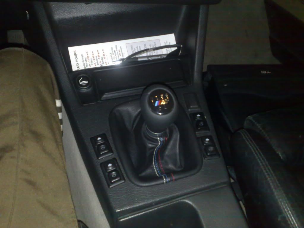

        Snap some pictures of how it looks installed (in the unbent form) in various gears and neutral.
        I will, give me a couple days.

                I think they are, at last the Z3 2.8 since the shifter is all metal and the ball is plastic, looks like if it was molded on the shaft or something.

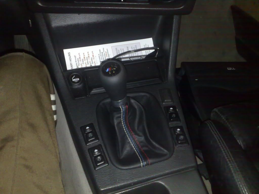

                Here are the pics of mine installed in all gears. Starting from Neutral, first, second, third, fourth, fifth and reverse is the last pic. Took me a while.
                I did not bend the shaft even though I wish I had slightly to the left, as you can see it seats on the right too much but nothing that affects the driving IMO.
                Enjoy

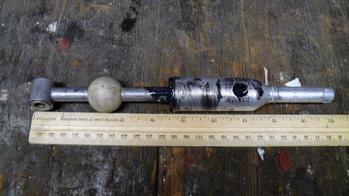

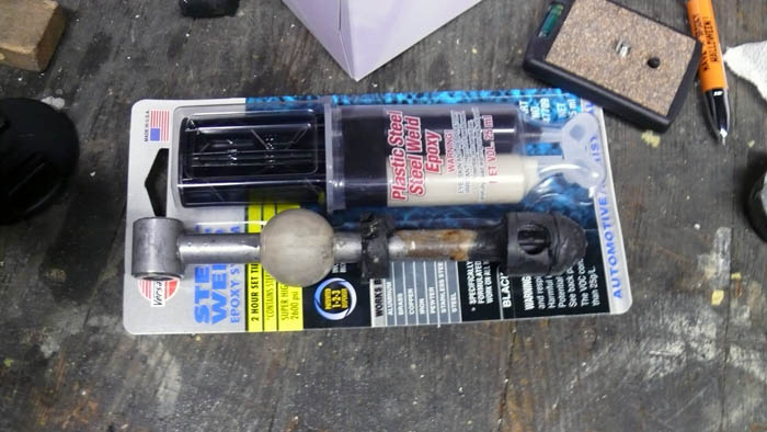

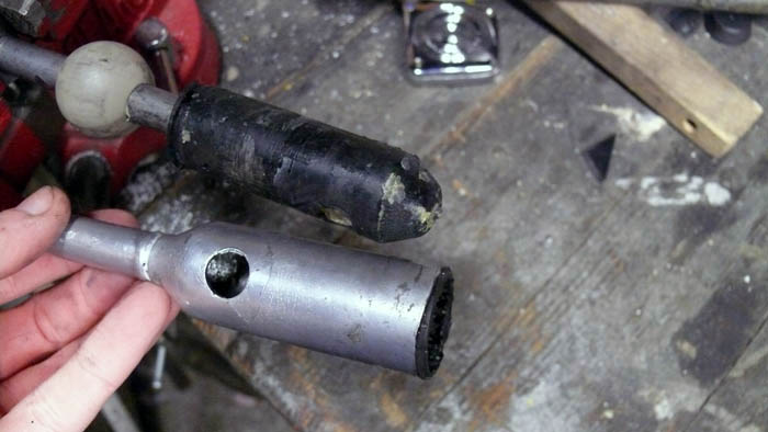

                  Limp lever fix.
                  Originally posted by Sean
                  I'm still running the Z4 3.0 lever (I think?), and love it! I also think it's starting to get a bit loose, the lever that is. Might look into getting another one just to tighten it up again.
                  I had this too using a z3 3.0 shifter, it was also a tad shorter than I really wanted it to be. My main issue was a limp/rubbery feel, not so much slop. Here's how I attacked the issue.
                  For this you will need the following.
                  Limp shift lever
                  Tube of epoxy, anything that is good for metal/rubber.
                  heat gun
                  exacto knife
                  hacksaw
                  vice or pliers
                  Straw or wooden dowel
                  masking tape
                  The culprit, all levers are like this to isolate vibration, the rubber is attached to the rod for about 2cm around the area that has the holes in it, the rest is loose. It is glued into the top part that the knob attaches to. I used a heat gun and a vice to seperate the two, be careful not to crush the end in the vice and mess up your lever, use some wood and grab on the rod.
                  Now choose your weapon, I used a hack saw and xacto knife to cut the rubber, I left the top alone and left a piece at the bottom to help center the rod in the tube while the epoxy sets. I also chose to legnthen my lever while doing this, I used a chunk of the old rubber and some more epoxy in the tube as a spacer, but you can leave this step out. Also at this point wrap the plastic fulcrum ball with masking tape so you don't get epoxy on it.
                  Get some epoxy in there, mix it up with your straw and spread it around everywhere, this will make it much easier to slide the rubber back in (that was a bitch to get off huh?) Don't take too long, depending on what kind of epoxy you use it can set up fast, mine had a 2 hour drying time so I had plenty of time to work.
                  Now the tricky part, slide the rod back into the tube while it's secured in your vice, then fill with epoxy and pack it in there with your straw to get all the air bubbles out. Use the holes that are there to help get epoxy in the tip and get any air bubbles. Fill it nearly to the top, then use your rubber piece we left on the rod to center it, press it down and some epoxy will come out of the holes, clean this up, spread it around on the rubber and end of the rod, then tape up the holes and let it set. Overnight is best.
                  Here we have the final product, a lengthened and stiffened shift lever for only a few dollars and not much effort.
                  No more limp feeling! :D
