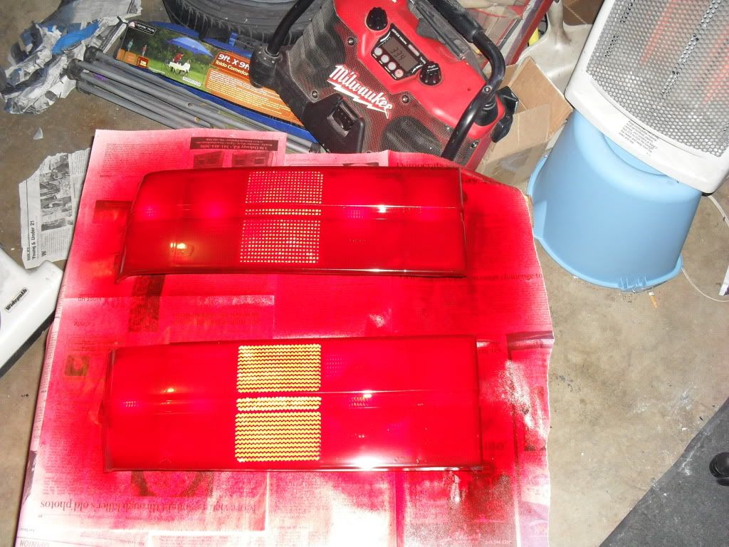

        paint is drying now
        haha that looks weird
        -Andy

          You didn't tape off the black edges? Did you tape off/around the turn signal and give it 1-3 coats to color match the existing red before you sprayed the whole thing?
          Agreed. It looks a bit funky in those pictures.

            the black areas were so faded, yes taped, sprayed them all sprayed
            They look really good on the car

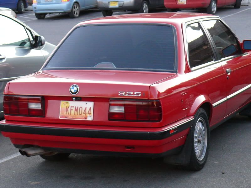

              here she is when i got her
              and now after all red tails using the metalcast red technique
              • dnova89
                • Aug 2009
                • 851
                #217
                not saying your new lights look bad but... i think it's a little too dark of a red, if only there was a way to do it while still keeping the same shade of OEM red... I think I may go with the tinting method if my the red on my tails gets too dark after it's done.
                edit: iono.. the more i look at your pics jintermont, the more i can't decide. one second i don't like it the next second i kind of like it. haha. maybe it's just because the whole car is red that i noticed the difference. probably won't be an issue on my light blue car then.

                    they are a bit dark but its also the way the pic was taken they aren't that dark in person.
                    i still need to do a good clear coat and polish them
