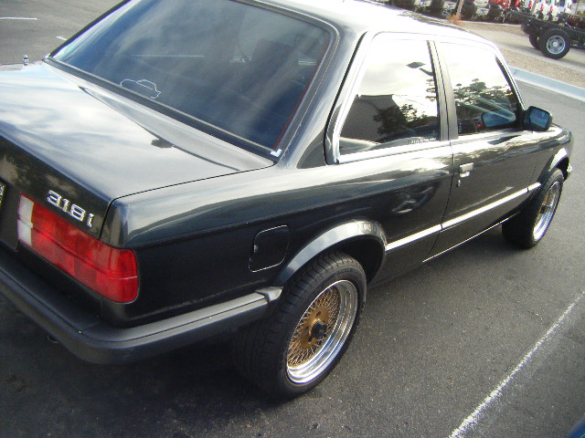

          Here's mine I did a while back. Testor's candy red and I had the touch up guy on the lot shoot them with clear.
          I know the epic ride height, early 318's are monster trucks.

            sorry but i don't think your choice of wheels/tires help, in fact they accentuate it in a
            negative way.
            the lights look pretty clean though.

              Holland, your car looks nice! Needs a drop, but i'm sure you may know that. Did you get those wheels off of Jean?
