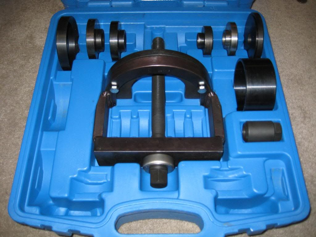

    Ahh this damn job. Awesome write up, however I hit a snag. When removing the hub the bearing feel apart on me, now I am left with the outer ring of the old bearing stuck.
    I have one of these that helped get the hub out.
    I don't have this tool everyone is talking about, but I do not think it will help in my case. If the bearing needs to get pulled out towards you, there is no lip from the inside to pull it out that can pull the bearing out. There is a slight lip in the middle, but I don't think a washer or any plate can pass through the back side in.
    This is what I have going on now, going to try chiseling it out, but I know this MF'er is going to be in there nice and tight.
    Any suggestions on getting the rest of this out?
    EDIT Well I caved in, ended up buying the tool everyone used from HF. The hammer tool I rented above did help, however its not going to help the the remaining job. If I just purchased the correct tool at the start, I would have done it all with that. However, I did have to buy this bearing puller too since the bearing was stuck to the hub.
    $150 and 10 minutes later, I have everything off. It feels great when you have the right tools....word to the wise, buy this stuff from HF and then return it within 90 days. The checkout girl basically said "If you use it once and don't plan on using it again, we have a 90 day return" I then asked "Like a tool rental?" and she goes "No" while shaking her head YES.

        Ok, just finished swapping out one side. This job was not nearly as bad as I thought it was gonna be. The one side took 2 hours, and that's without any special tools. I thin cutting the outer race with a Dremel was the best way for removing a stuck outer race.

          I ended up doing the job on one side, not too bad with this tool...however went to the other side and it was an absolute nightmare. Needed a 50tn press to push out the shaft from the hub.....and broke bearing pullers and stripped the thread doing so. Finally took the whole arm off and got it pressed, replaced the arm bushings while I was in there and put it all back together.
          Let me know if you need any tools, I have this bearing press, puller and a separator from HF if you need to borrow. God speed!

            soon I'll have the "official" rear bearing tool to rent out.
            Renting my rear wheel bearing tool kit. SIR

              Just got this... Feeler for anyone interested in renting from me. U Pay for shipping and $50 + refundable $300 upon return of tools.

                    Cants get the hub off..... used the Harbour Freight tool to wedge it out but I broke the head off the lug nut bolt!!
                    Now I have a broken bolt stuck in my hub!!
                    Have to buy a tap & die set now to drill the bolt out.
                    Still have to worry about getting the hub off..... trying a 3 jaw puller next

                      Got the half-shaft off first then worked with the hub again. Finally came off. Got the bearing off and also ruined the bolt that came with my $100 Harbour Freight "Front Wheel Bearing Kit."
                      The bolt has so many stripped and ripped threads the quality it unbelievably horrible.
                      CURRENTLY:
                      All the old parts are out and the new wheel bearing is stuck, but seated, 1/4 the way in the hole. Not moving at all until I can get a better tool to slide it in.

                        When I did this on my 89 2 door, I stuck the bearing in the freezer when I started. About an hour and a half later after I got the old one out and the area cleaned up, I heated up the bearing area in the rear control arm with a torch. The combination of the heat on the trailing arm and the bearing being frozen was a Godsend. The bearing fell right in. I didn't need a press or anything. Just slid right in.

                              my harbor freight tool broke during the job too, the threads stripped completely. Take it back and they'll either give you a new one or your money back!

                                get a extra hub just incase.
