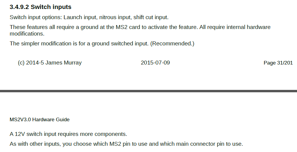

        I actually just wired in my clutch switch with my megasquirt build, as well as got most of the pieces into place for traction control, launch control and flat shifting as well. It will be a little while before I actually test it though, lots of other items on the list at the moment.
        If your car had/has cruise control, and is manual, there should be a clutch switch.

          How did you use the clutch switch for MegaSquirt?
          As you said, any manual transition car with cruise control has a switch on the clutch pedal. Unfortunately, the circuit is grounded when the pedal is up and the circuit is open when the pedal is pressed (the opposite of how MegaSquirt needs it). I'm looking into the following options:
          • Switch to a single pole dual throw (SPDT) switch: cruise control gets grounded until I press the clutch, then MegaSquirt gets grounded. I bought a switch, but it seems too small and I don't like it.
          • Add a second switch that closes the circuit when the pedal is pressed
          • something else?

            I don't think the MS cares, does it? I have not actually configured it yet but I can see the I/O switching. Worst case I should be able to invert it with a loop. (I am running an MS3 ultimate).
            • ForcedFirebird
              • Feb 2007
              • 8300
              Overthinking.
              MS simply has an open to closed, or closed to open parameters. The type of switch is irrelevant. When doing launch/traction, the ECU simply needs to know the condition specified, and act upon it. In the end, it is user-defined.

                Yeah, I figured it shouldn't matter. What does matter, from my understanding, is where the switch is 'tripped' relative to clutch position (and it being adjustable). The factory switch is adjustable. What I don't like is that the bracket holding it seems rather 'floppy'... for example, my switch wasn't working, took a look at it and realized the bracket was bent and it was sitting way back, bent it back and now it seems fine. Not really what I want for a setup beyond basic validation/screwing around, so I will need to fix that.

                  Ok, so you're saying that I use my stock clutch switch, which is grounded with the clutch engaged and open with the clutch pedal pushed. Then I set it in MegaSquirt to say, "turn on Launch control when you see an open circuit, turn it off when you see ground".
                  That's so simple. I overthink stuff way too often.
