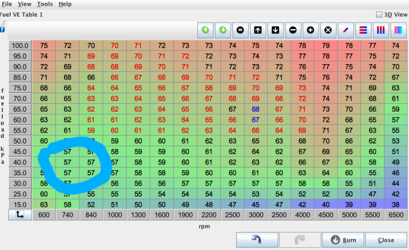

                  Steady Idle tip: In the idle area in both VE and Spark maps, Equalize all surrounding cells.See below Click image for larger version
