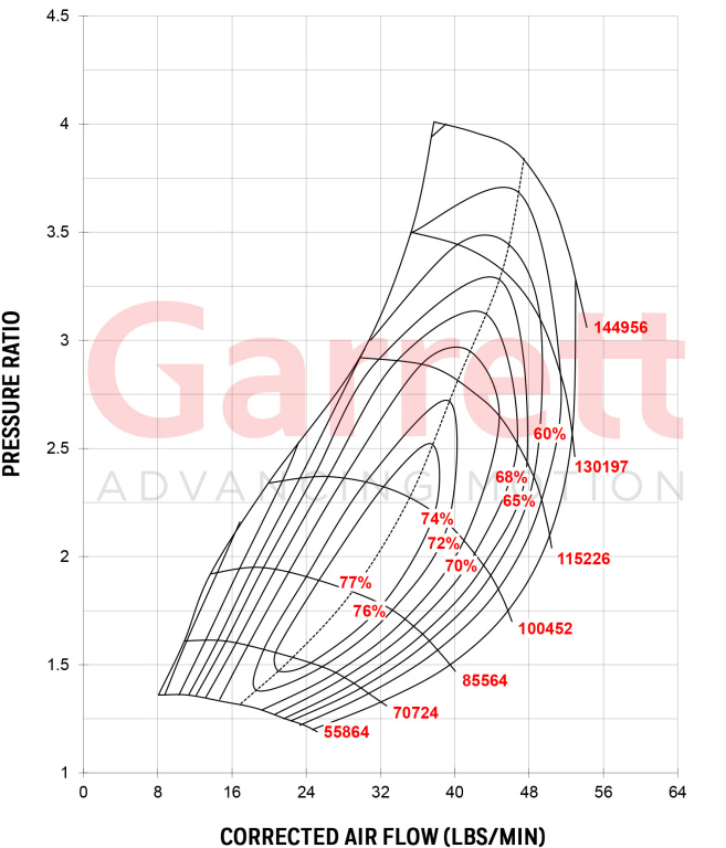

    A GT3076R is way overkill for 250-300hp (see below). The T3/T04E is cheap for a reason, it's a very old design so it definitely doesn't spool as well as modern turbos with improved aero, but your M20 has at least 25% more displacement than the SR20. 250-300hp is super easy, any turbo that will make that without huge overhead will be plenty responsive.
    My turbonetics 60 trim T3/T04E will do maybe 450hp worth of flow, probably less with the .63AR exhaust housing and internal wastegate I have. It starts making boost reasonably quick around 3,000rpm, rolling on in higher gears spool to full boost is occurs in a second by 4,000rpm, and full boost is irrelevant through 2nd since it spins the tires at anything over 13ish psi and revs out very quickly even with my 3.25 rear end. If I floor it at 2,000rpm I'll see positive pressure in a second or so. I previously had a 50 trim with the same turbine, it is the same story but it's a 400hp or so turbo.
    T3 super 60s are the biggest of the non-hybrid T3s and will be super responsive; substantially smaller compressor than a T04E, my inducer is nearly as large as a T3 super 60 exducer. Anything in the T3 size class will work for your modest goals and be quite responsive. TD04 16T, T3 60 trim or super 60, GT2860R/RS, Precision 48XX/5XXX, BW S250 or SX-E? Just pair it with an appropriate turbine and housing.
    Click image for larger version  Name:	GT3076R.jpg Views:	0 Size:	138.2 KB ID:	10087101
    GT3076R compressor map
    Click image for larger version  Name:	T04E 60 trim.gif Views:	0 Size:	13.0 KB ID:	10087100
    T04E 60 trim
    Click image for larger version  Name:	T3 Super 60.gif Views:	0 Size:	8.9 KB ID:	10087102
    T3 super 60

        Thanks for all the compressor maps Varg. Tell me if I am reading them correctly though.

        Using this, and looking at the T3 Super 60 wouldn't that be putting me out on the choke line? For the T04E 60 trim and GT3076R that's right in the sweet spot. Or is my Volumetric efficiency wrong (I just left the default)

          Those numbers seem reasonable enough, in the ballpark at least. Higher VE will lower the boost pressure for a given power output, your cam and turbine will affect this too. I think you'll need more boost than 0.7bar for 300hp (~260-270whp) with a T3, the turbine will hold you back with a 2.5. You may want to find a copy of Maximum Boost, it's out of date on some things these days but the basics remain, including turbo sizing.
          That's also the smallest turbo I listed, and is going to be tapped out at 300hp, so you'll be making that power at a higher pressure ratio as you stray from the peak efficiency range and have a small turbine holding you back, but it'll spool early and fast. T3s spool fast on 2.1-2.3L Volvo redblocks I have run them on in the past, they'll spool super fast on a 2.5L M20 which has a much better head. If you want 300whp you're probably going to want something bigger. The turbo choice boils down to more than the compressor, you can tune your EBR and power band with turbine and turbine housing sizes. I ran a .48ar housing on the aforementioned T3/T04E 50 trim when I had my M42 and it was plenty responsive despite the low compression ratio. The 60 trim with a .63ar housing on the M20 is perfectly sized to make my turbo M20 responsive enough that I don't have to downshift all the time and still have a traction limited car capable of low 12s on high boost.​ It's basically the same turbo with a different turbine housing being used on a 1.8L and a 2.5L successfully. The compressor difference is pretty small.
