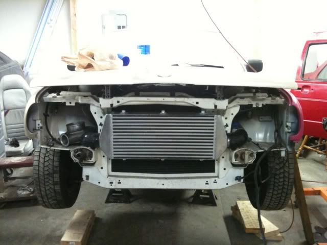

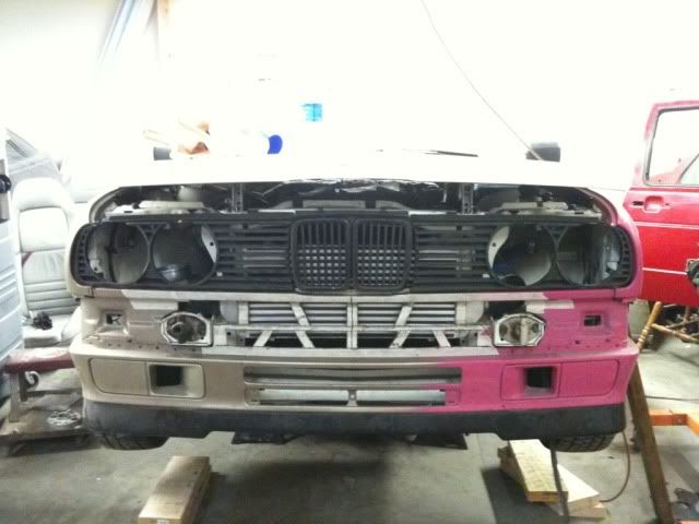

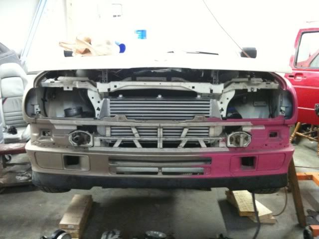

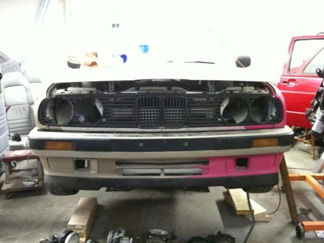

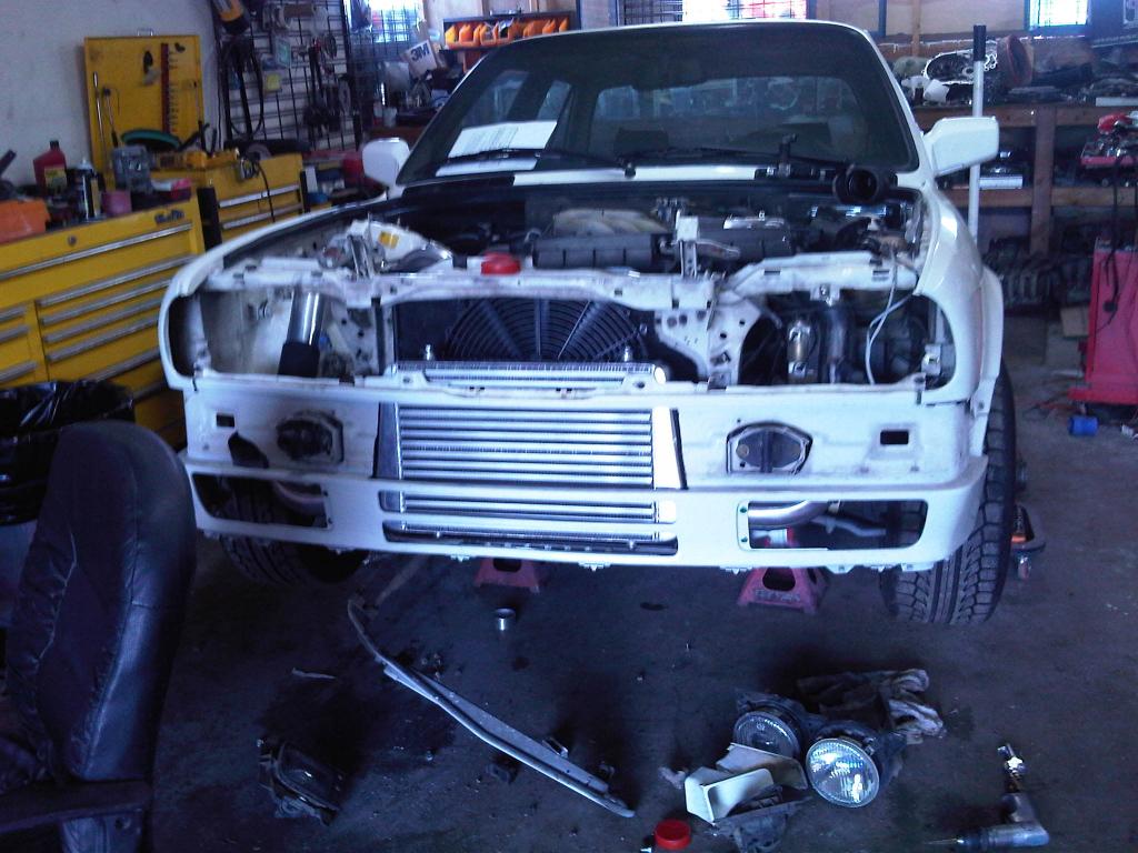

      here is a few crapy pic of my set up

        hey_you, honestly dont even kick around the idea of smic's, they would be so small, they would just cause a restriction and you would spool slower, i looked into the simc, because i have a small turbo, and figured i wouldnt need a fmic. wrong.... get a nice small fmic, paint black, install, be done, and no one will know untill you let off the acc pedal...

              if your running 2.5 in pipe it will fit right under the head lights if you take the front bumper you dont see any intercooler piping

                My coolers getting welded today, by this weekend ill install it and show you how much room is in there, once you remove the condensor nd fan, you'll see how much space you have.

                      nice.. how do you fit it with AC?

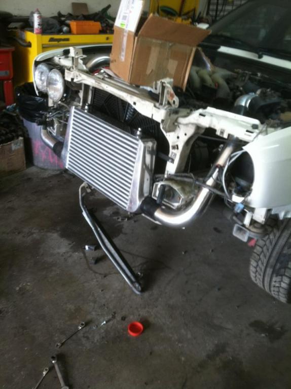

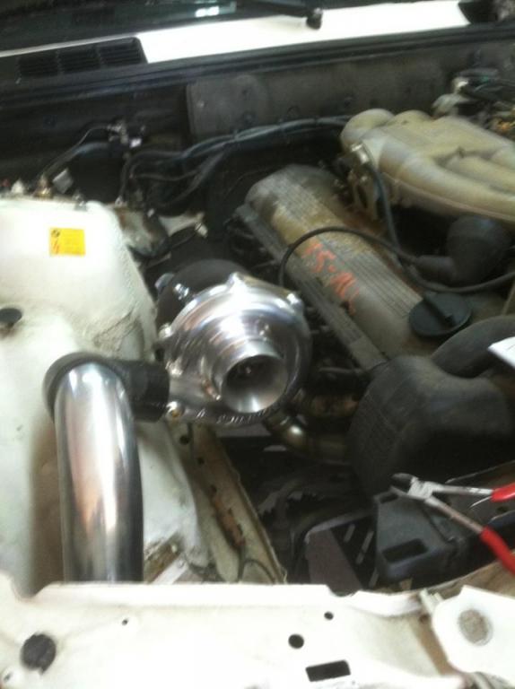

                        I don't have AC, but mine comes nowhere near where the compressor would be. Might interfere with the condenser and lines though.
                        I was thinking of keeping AC in the next car I put this motor in, but that's a ways off.

                          Similar to mine,except I retained AC.

                            I also made solid mounting tabs. It's just sitting on the outlets for mock up in those pics. I was also able to fit a 14" spal fan with a ~2" depth between the radiator and intercooler.

                              was thinking about getting a 14" thin mount in place of the aux fan, but still not sure there is enough clearance with the ac lines and condenser
