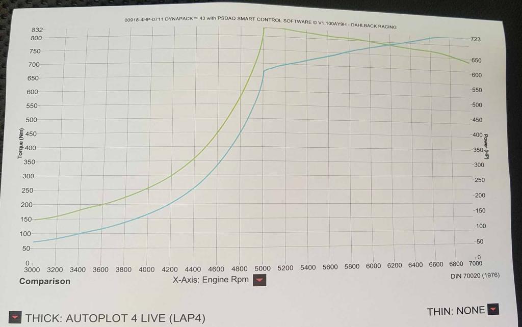

        #258
        Originally posted by bl0mgren
        in sweden :)
        Whoa! More info of that engine please!?
        That must be new m42 record.
        And since i`m here, i might as well put my dyno results here.
        Here`s what you can achieve with stock m42 apart from arp head studs.
        Turbo: Garret gt2860rs
        Maxxecu engine management
        Fuel re85
        Hub dyno
        -89 e30 320i brillantrot m42b20 turbo, street / timeattack
          Fuel re85
          Hub dyno
          Onnea! Thats impressive given the stock bottom end and smaller turbo. E85 doin work!

            #260
            You are way up north, is that considered Lapland there? Probably not, but close. Furthest north I have been is Jyväskylä.
            Kippis!
            Thanks! Re85 sure is THE fuel for turbo cars. :)
            Spool on that turbo is very nice, and i think is safe to say that garrett has reached its potential.
            Unfortunately i managed to toast my rod bearings during a burnout so the engine is done.
            But that is a great excuse to go for forged iternals isnt it?:D
            Altough the region i live is considered northen finland, its not quite lapland yet, we're missing the tundra and the reindeers :D
            Kippis!
