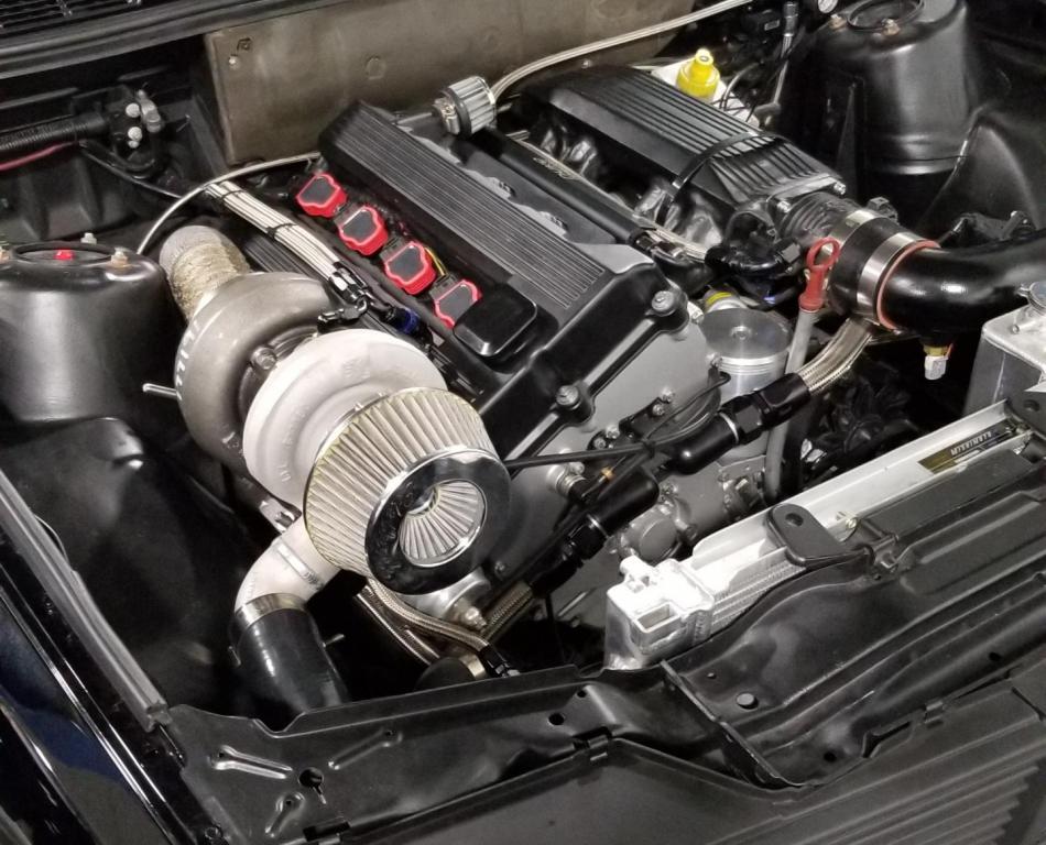

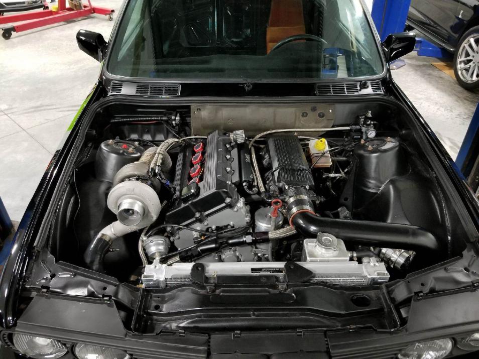

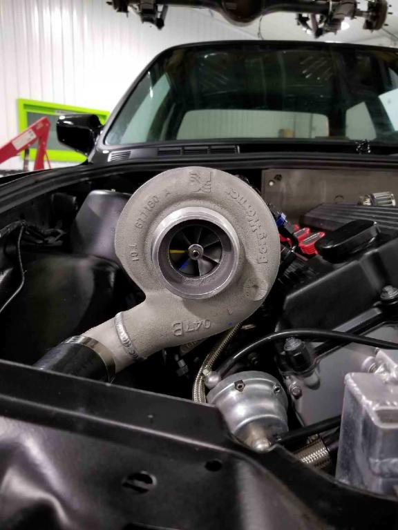

                Thought you guys might like to see this:
                18psi 265whp
                1986 Garrett turbo wouldn't blow any harder than 18psi.
                We placed a new Borg warner s200sx on to see what it would do! Will run it HARD next week. Near 30psi.

                    #249
                    Here are the down and dirty specs:
                    1991 BMW 318is
                    M42
                    Ms3 Pro
                    Bored/Stroked to 2.0 liter
                    Bottom End:
                    86.5mm Wiseco
                    m44 83.5mm Crank
                    Stock forged early model m42 140mm rods
                    ARP 2000 Main bolts
                    ARP 2000 Rod bolts
                    VAC coated Main Bearings
                    VAC coated Rod Bearings
                    Head:
                    Supertech dual valve springs, seats, and retainers SPR-H1000D/BM, SEAT-BM50, RET-K20a2/t2
                    Supertech 6mm black nitride coated Intake valves BMIVN-1030S
                    Supertech 6mm Inconel exhaust valves BMEVI-1030S
                    Supertech Keepers KPR-6S-7
                    BMW oem 6mm valve guides
                    VW 48gram Lifters p/n 050 109309
                    Cometic MLS 86.5mm .098" gasket
                    ARP 2000 Head studs
                    Audi red top Coils
                    Nuke fuel rail
                    Bosch 044 high pressure fuel pump
                    Surge tank w/low pressure fuel pump
                    Land Rover 3" throttle body
                    Meziere elecctric water pump
                    Mishimoto radiator
                    1995 M3 zf 310 transmission
                    323i throw out bearing
                    m5 240mm clutch & UUC light weight flywheel
                    1st Turbo:
                    1986 Ford Turbo Coupe Garrett T3 .63/.63 W/Modified Turbine
                    Compressor:
                    56mm Inducer
                    61mm Exducer
                    Tim 84
                    Turbine:
                    56mm Inducer
                    61mm Exducer
                    Tim 84
                    Manifold fabbed from two OEM m42 intake manifolds to create this:
                    Highlights:

                      #250
                      330whp/281 @ 25psi
                      Was hoping to run closer to 30psi and 350.
                      • JRW21
                        • Aug 2009
                        • 190
                        #251
                        Last run set for tomorrow going to run 28-30 psi!��
                        ..wish the m42 luck!

                            #253
                            Dyno Run #3 340whp/299 torque 26psi: 80lb/hr injectors @ ~90% duty cycle
                            Thats it for now, going to put this thing back together and drive it! However, its killing me not to upgrade the injectors to push further!
