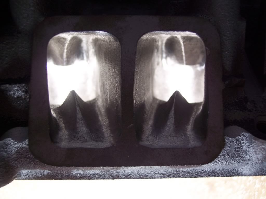

                              On the contrary, I completely understand the concepts of boost, here is an example of the head I went from to in my Firebird.
                              Stock intake flow is about 127cfm at max lift (.400")...
                              To about 225cfm at max lift (215cfm at the same .400")...
                              And both units ported (147cfm and 250cfm respectively)...
                              Again, this thread isn't going in the direction I expected. I was hoping for a discussion on static compression and boost...
