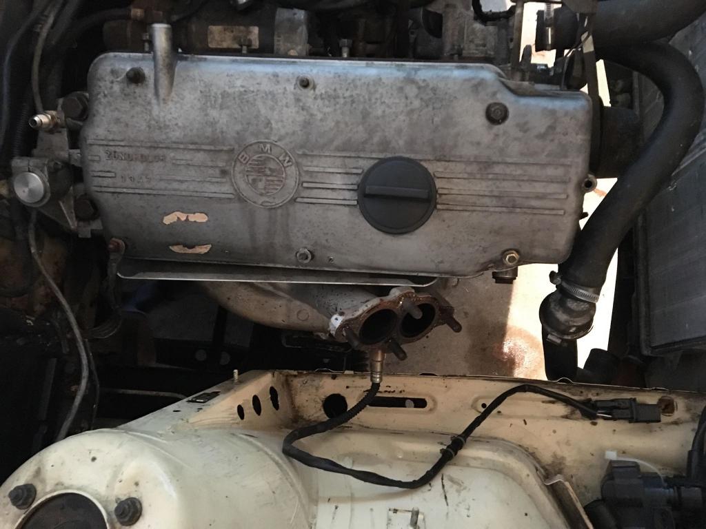

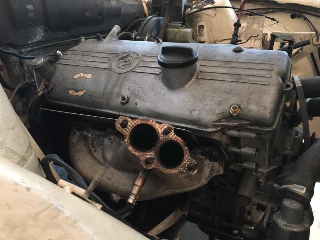

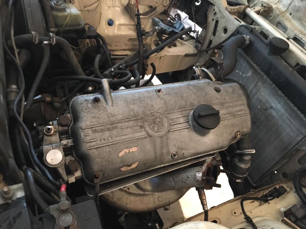

    I just thought I would document here that I'm flipping my M10's exhaust manifold and throwing on a T3 flange. It's not gonna be pretty, but it's gonna be cheap.
    Here's a quick photo of the manifold post flip, just for those interested in doing a similar route.

    cool idea. can you get to the spark plugs easy enough?

      we'll see... I'm most concerned about #1 and getting a spark plug wire there. The gasket was just for test fitment, I believe it's best to cut it up or flip it to the bottom as well. gonna have to play with it.

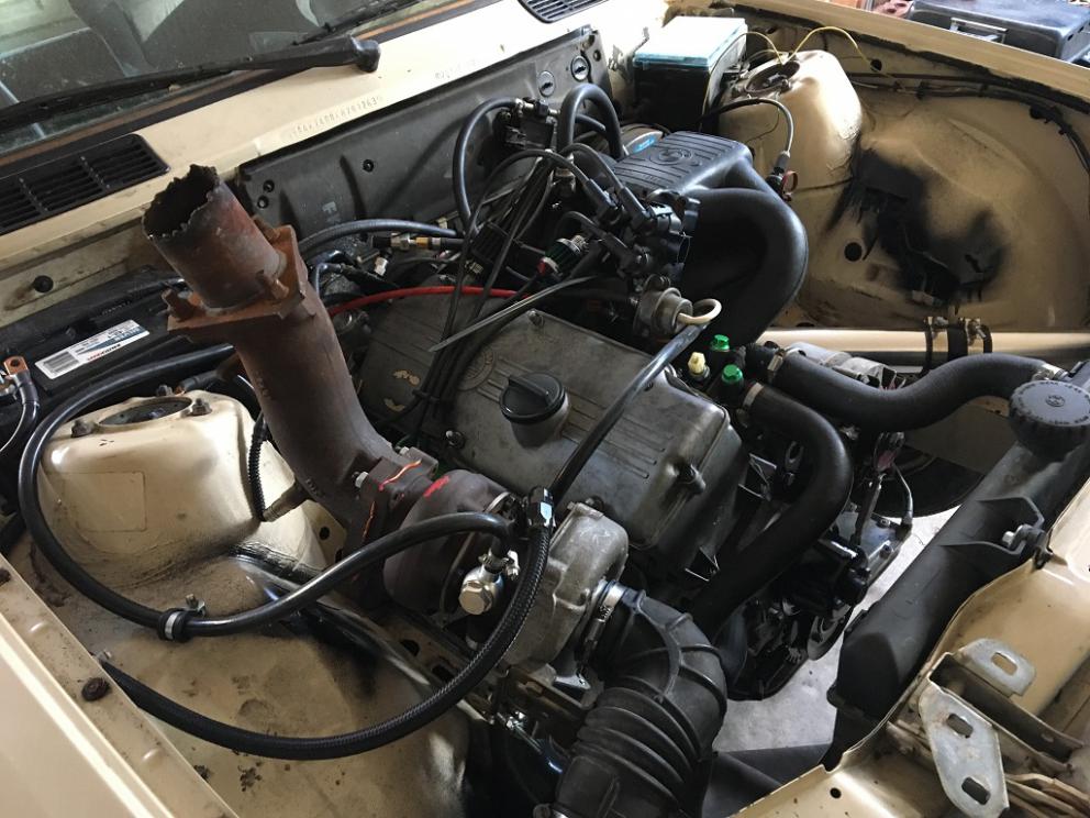

          Little update. Turbo installed and extra equipment. It's not great in terms of clearance to other pieces, but it does clear the hood without my current exhaust setup.
          Compressor outlet elbow is hitting the wheel well because of the design of this turbo--compressor outlet -> 2.25" adapter -> 90 deg silicone elbow. Nonetheless, it still looks like it's gonna work. Oil drain returns to the lower timing cover.

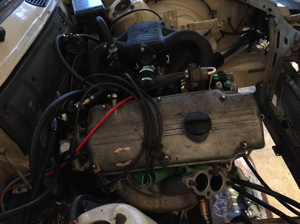

          Getting to the #1 sparkplug is impossible with the manifold on. I ended up just flipping the factory exhaust gasket. I've added fiberglass sleeves to protect against heat to the ignition wires. We shall see if they are effective or not. I believe once I have a coil or wire fail I will be moving to coil-near-plug GM coils.

                  How's the exhaust manifold nut access? It's one of the worst parts about my M20 turbo setup, some of the nuts are so obstructed I can only get a quarter turn on them at a time.

                    it's not bad. the worst is for sure around the collector, but not horrible. There's a pass through in the casting to get a socket + extension on pretty much any of them. Might have to change extensions, but it's not that bad.

                        Another update--it is possible to access #1 spark plug without removal of turbo or manifold. It's a pain and you need to use a 1/4in drive ratchet because a 3/8ths drive is too big, but it works.
                        The alternator was backfeeding and keeping the car running. I added a diode and removed the rest of the cluster. Got everything wired in, including vehicle speed, fuel level, and e-fan. Finally I'll have a cluster that will have an accurate odometer ;D
                        I'm dealing with oil leaks and turbo oil feed too big/return too small. I have a 90 degree -10AN on the drain, so I'm swapping that to a 45 deg turn from the turbo and another 45 on the motor. Hopefully that fixes much of the oil smoking on decel after boost. I probably went too big on the feed side, it is a -6AN, which I might change to a -4AN, and possibly a restrictor if it needs it.
                        Moreover, my crank sensor is right at the edge of the toothed wheel, so it sometimes loses RPM sync, momentarily stops the motor(spark cut), gets RPM sync again, and keeps going after shooting a huge flame out of the turbo up pipe. That's my priority to fix this weekend if I can manage to bend the 02again timing sensor bracket about 3-5mm without breaking it. It's billet aluminum.
                        Hopefully I'll have another video of it driving soon, I only have tuned a little fuel out of it below 4k RPM. It pulls strong with very little timing and only 10psi before running into overboost cut. I'm trying to be very careful with it until I sort out all the issues. As y'all know, it's pure chaos when everything is happening, so it's great to not have to worry about the engine bay catching on fire from oil being sprayed all over the place.
