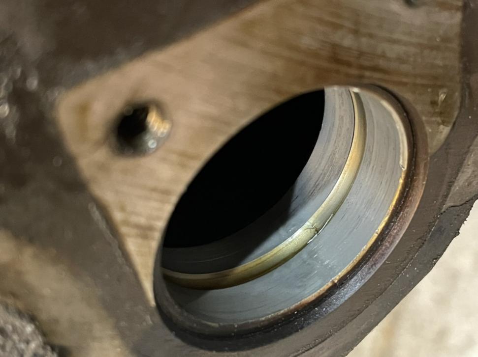

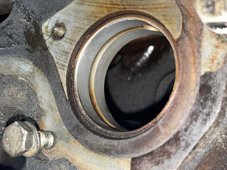

          IE 2.9L Ultimate Street Stroker pistons, 84mm crank, spacer/bolt/washer, ARP main studs, and Molnar rods ordered! Took a peek at the donor short block today, it’s oily/crusty, but should clean up really nice.
          ForcedFirebird the intermediate shaft bearings looked to be in good shape (see attached), but will definitely defer to your advice on whether they should be replaced.

            Can't tell by eye, unless they are totally wiped. Check the clearance on the intermediate shaft, but in all honesty, why would you rebuild and NOT change them? It's a few hundred bucks that could potentially trash a couple thousand in parts.....in about .000001 seconds.

                  Ones I’ve seen fail have flaked / spalled and some have worn through. If clearances are too large the oil pressure will be lower as the oil “escapes” too quickly out the bearing (the oil pressure is actually the back pressure)

                    The intermediate shaft is at the front of the engine, right next to the oil pump - If the tolerance is loose, then you are going to starve the rear of the engine.
                    Stock bearings are a stamped steel ring with cast babbitt, there is no indicator that they have worn.
                    Front bearing should measure <1.496" (38mm), rear <1.437" (36.5mm). The rear is kind of a pain to measure, I use a telescope bore gauge and lots of patience.

                            This is on an engine that has done a bit above 100k miles on 3.1L stroker reusing the intermediate shaft bearings (not sure how many km on the original block) but they were mint no visual signs of wear at all despite signs of the owner not changing oil very often, unlike another block where it has flaked apart and you can visually see wear patterns after 125k miles with regular oil changes.
