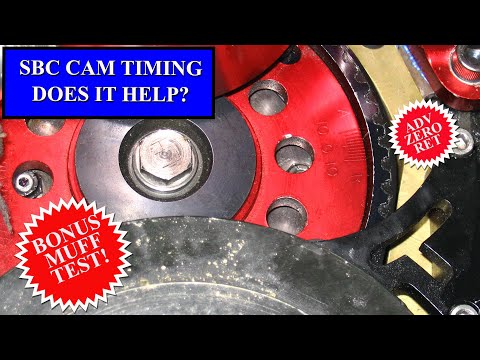

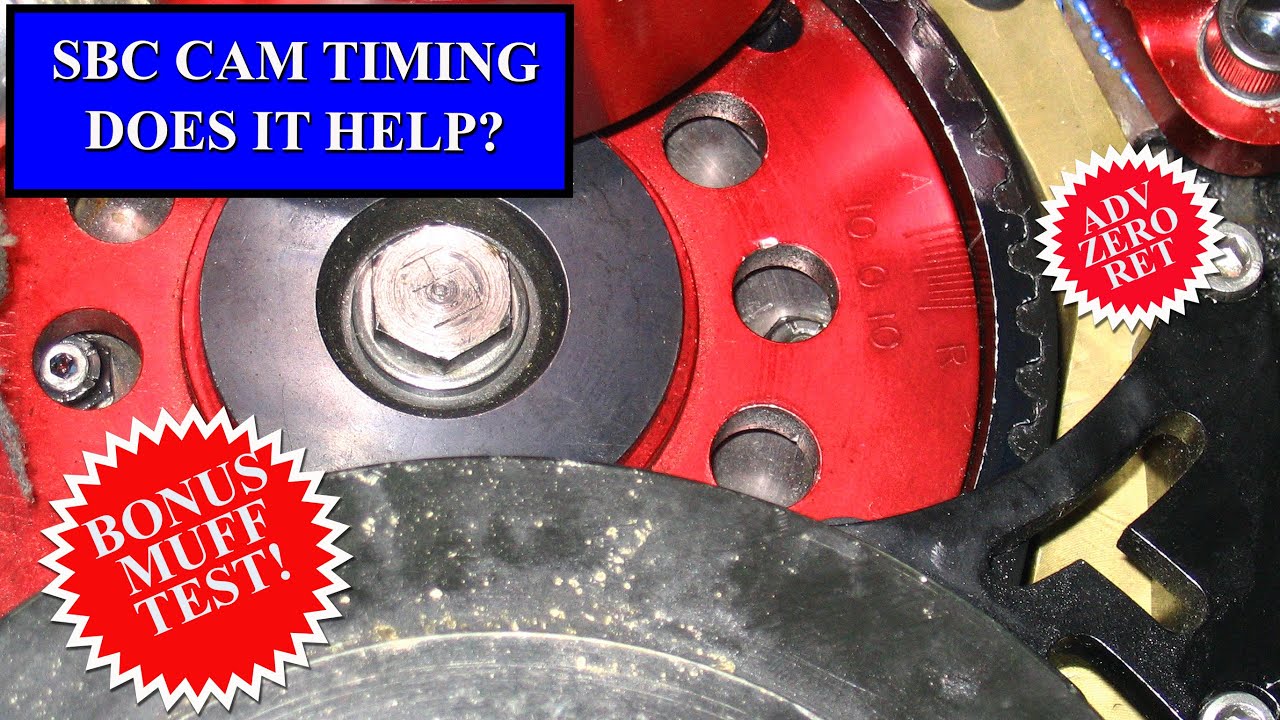

                              Originally posted by ForcedFirebird
                              Have you done the math on that? Yes, it does retard the timing a bit, but my examples put down 180whp without messing with the cam gear. That's about 35whp over a stock b25.
                              If you rotate a cam to advanced, the peak power won't move very much, but your power curve will move higher in the RPM range. If you retard the cam, peak power will have a slight LOSS, but the peak curve will move lower in the RPM range. That being said, my examples of the junkyard budget stroker builds would make MORE peak power if I was to advance the cam. ;)
                              Did not do the math on it, but just did - maybe about 2deg? (I'm making assumptions about cam sprocket diameter). So, pretty minor.
                              I trust your dyno results much more than any heuristics I've heard, but I always heard that advancing the cam moves the powerband lower, also seen in dyno tests in the video below - warning, GM content ;)
                              Although for a 2deg difference in this case, probably doesn't matter much lol.
