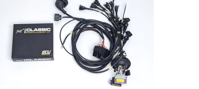

                              What's wrong with your stock harness? Are you planning to use PNP DME ?
                              Obviously that harness doesn't replace the entire car harness, just DME to C101 from what it shows. I use PNP DME with ITBs and successfully modded oem harness to remove chasis ground from all sensors (just like Rama did in his ECUmaster harness). All it took a couple of splices in OEM harness as there are plenty of wires and done. Reversable as well if you ever go back to 100 % OEM setup. No need to remove/slice the entire engine harness as well, All ground connections for sensors are 7-10" up from DME connector, everything is easily accessible. OEM injector harness already have all temp sensor conductors separated so no need to mod that. Just a few splices by DME connector and done. Best part it is free, looks 100% oem and easily reversible (my goal with this e30 project). From what I found, every sensor (except oil level sensor) has it's own sensor ground conductor going all the way back to DME where BMW bunched them all up and connected to the chassis ground conductor from the strut tower. DME connector has a sensor ground pin (don't remember which one..have to look at my records) which is isolated from chassis and perfect to land all those sensors (IAT and coolant temp). Done...
                              Basically everything what Rama offers here in the link below (only for OEM DME) and 100% using OEM harness
