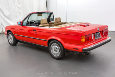

                            has anyone seen a big bumper vert with the air bag wheel?
                            have read that the north american verts did not get small bumpers until the air bag wheel, while coupes got them earlier. apparently, there was a back log of parts that bmw wanted to clear so they used them on the verts to reduce stock, only switching when the vert cars went air bag.
                            • reelizmpro
                              • 9558
                              Yes. This is a 90 325iC. The airbag, since it was required by law at the time took precedence.
                              Click image for larger version  Name:	image.png Views:	0 Size:	146.4 KB ID:	10115513​
