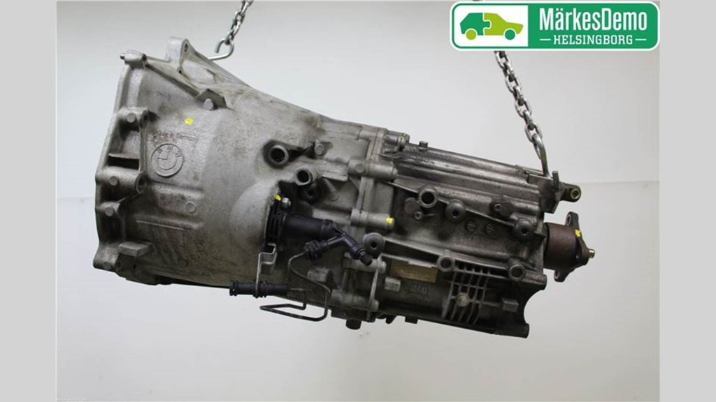

                          • hasa
                            • May 2013
                            • 307
                            Click image for larger version  Name:	61682756.jpg Views:	0 Size:	126.3 KB ID:	10115492
                            Front part should be the same (except the tilt angle). So taking DZ bellhousing and bolting it to BZ back side should solve the tilt issue. Input shaft distance is the same, so it is another issue to be fixed.

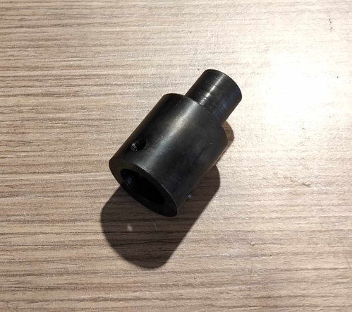

                              Input shaft adapter for DZ and BZ 6 speed gearboxes, is allowing a much wider varitety of clutches to work with the DZ/BZ by extending the input shaft to the standard length of a ZF 5 speed. This input shaft adapter is made to factory specs and has the correct clearances to fit straight on and uses the factory sized spigot bearing.
                              this has been used before to extend the shaft. not the most elegant solution though.
