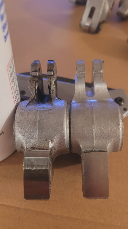

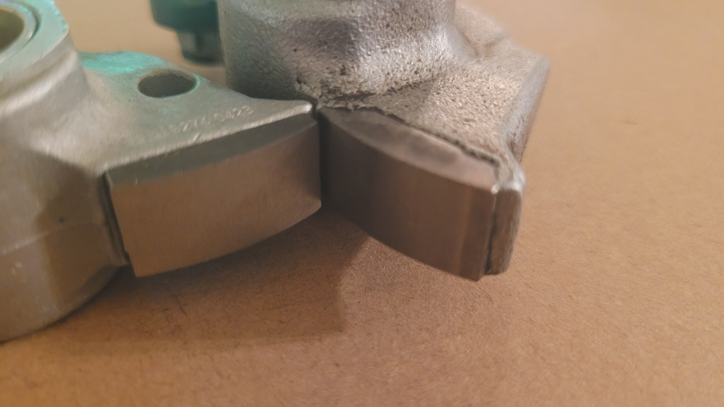

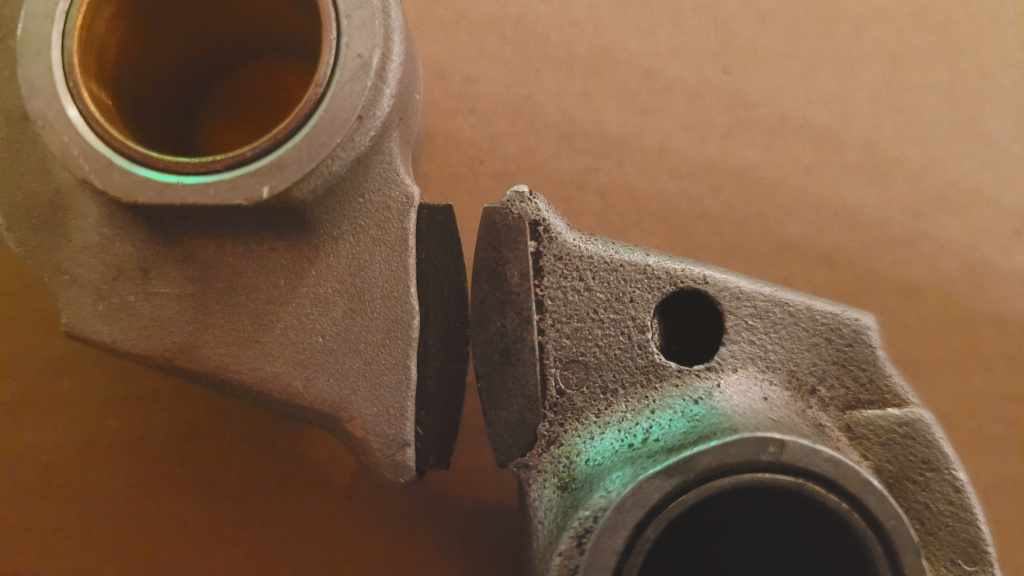

      Originally posted by zaq123
      FEBI HD and regular FEBI has the same geometry and similar rocker pad length. FEBI HD pad is of a horrible quality compared to regular FEBI rocker. A lot of voids on the side of the pad which affect the pad contour on edges. So basicaly should one use HD body rocker so it won't break and just have this rocker pad destroy the cam? I'm e little sceptical about those FEBI HD rocker pad quality. Regular FEBI rocker looks to be of a much better quality. I also confirm what digger said about pad surface, my finger nail was filed down on FEBI HD pad surface vs regular FEBI noticeably faster, indicating rougher finish of the pad surface. IE HD pad surface finish in that regard was more similar to regular FEBI.
      Great info & pictures. Thanks.
      I'm glad to see the Febi HD and regular Febi have a similar rocker geometry at least. I'm hoping the geometry would be more of a cam killer than the pad surface.
      The head I'm building will have new Febi HD, new billet IE 272 cam, & new OEM valve springs so assuming things go well can check and report cam wear with that combination later.
      Comparing what I assume are the original old OEM BMW rockers and the new HD Febi, from the one photo I have (attached) looks like the old OEM pad is longer and bit wider. Note this one rocker is particularly worn - llooks like it was running with a broken old-style head bolt near this valve for a while which has destroyed the valve/rocker/cam. Not sure on the side profile, will check in more detail when I get home. Might be a moot point because from what I'm reading those old style OEM are NLA and got replaced by the regular Febi and other variations at various points.

        #48
        Nevermind. Looks like Febi HD pad and original old OEM BMW one is pretty much the exact same width/length. Profile also looks pretty close plus or minus some wear.
          i was able to source a set of OEM rockers for $40 each and their pad quality is best out off of all above mentioned. They come with eccentrics and new hardware as well. So $40 is not a bad deal. I ordered a spare set to keep around since they were 20% off so I hope I still get OEM and not china Febi again. Also just an observation, regular current FEBI china rockers have thinner area where eccentric ears are and the groove cut deeper towards the bushing.. which makes them weaker than OEM imo.
