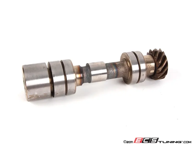

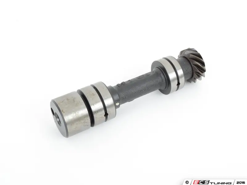

        Intermediate shaft/oil pump should be different/spin the other way. Oil pressure relief also likely different. Might need an extra hole drilled for oil pan (or plugged/ignored, I can't remember which way.
        Not sure the best route for what to change over as far as the above.
          Do tell more. I've only dealt with the M10 1980 direction change- didn't have a clue that the M20 also changed...

            From a few sources:
            Originally posted by nando
            the ix uses a different oil pump and intermediate shaft gear. you'll have to remove the oil pressure regulator from the RWD block. there's nowhere to put a dipstick for the ix.
            best bet - remove the internals from your RWD block, put them in an ix block.
            Originally posted by 77320i
            For us ix people though the oil dipstick is in a different place, the oil pickup is at the back and not the front, and the intermediate shaft that drives the oil pump is geared different and spins backwards (WTF why? Can someone explain?) so realistically, the best option is to swap in 1988 SETA pistons, rods and the crank.

                The intermediate shaft doesn't reverse but the oil pump and the shaft runs the opposite direction because the gear on the intermediate shaft is different.

                      the intermediate shaft must be switched, or you will not get any oil pressure.
                      also the oil galleys for the ix pump are different, I'm still not 100% sure the pump will bolt to the non-ix block and work correctly.
