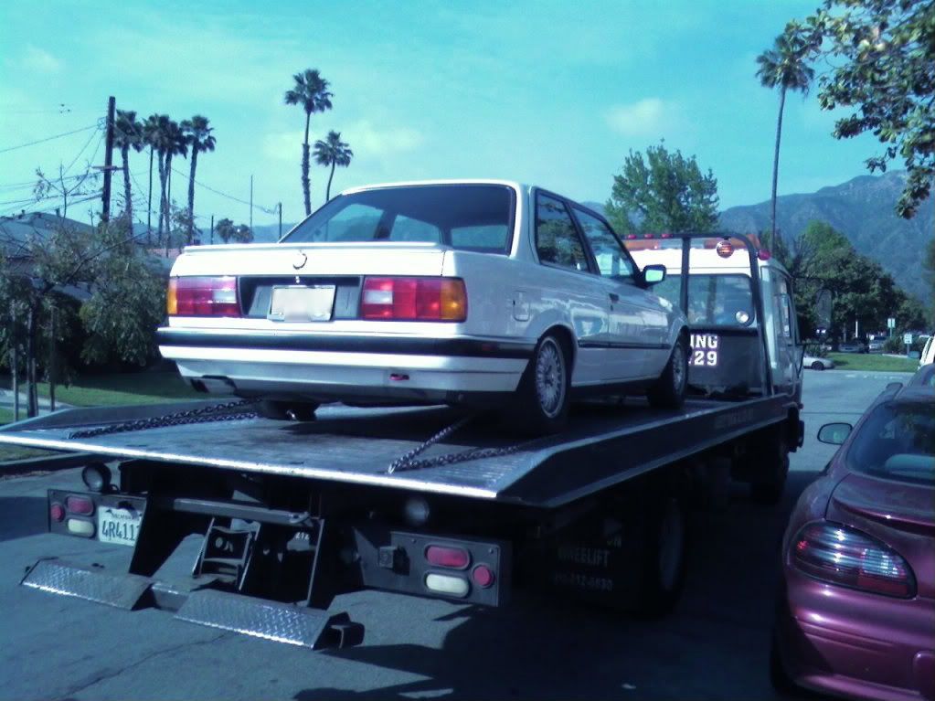

                          Here some pictures of the head and the manifold.
                          Manifold before i powder-coted it black.
                          Exhaust almost scraped the asphalt.
                          And Here is one picture of the engine bay:
