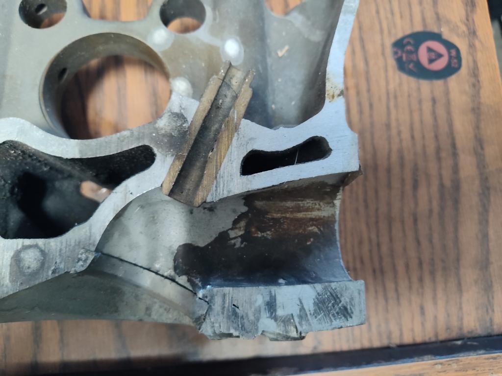

    welding ports (for relocation) requires probably unused raw head?
    • ForcedFirebird
      • Feb 2007
      • 8300
      #182
      Not at all. I've welded used heads, oil pans, thermostat housings etc. The bigger issue is the water jacket just above the port.
              Okay, I only listened some talks on pit. People say that the contaminated oil and other residuals in the casting are problem for the welding process. Specially for the exhaust side.
              Is it problem for engine cooling if one welds the coolant chamber closed and lift the port (specially the inlet port) ? I assume that it is required if one tries to achieve the CFM needed for best power above 8000rpm on a stroker M20.
