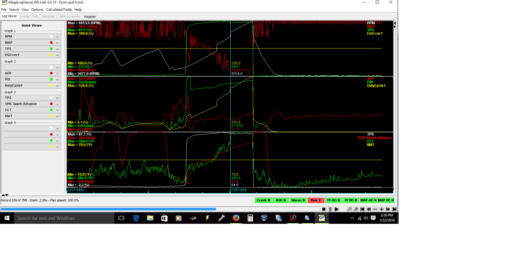

                It's not over yet ;) Injector DC was 100% by ~5k. You can see the AFR's go lean after there, at 7k they were at 126.6%. Not sure I want to try 24lb and all the 33 and 36's we have didn't pass a flow test.

                          It does. 100% duty at 5500 and you can see the graph go lean after. :(

                              I'd get 30lb it didn't go any leaner than 14 so probably doesnt need the 126% pulse width duty that was used/requested in the tune.
                              The only reason for higher would be to ensure the injection event happens entirely within a window on the intake stroke when doing injection timing in relation to cam duration

                                It did go over 14 a few instances. Looking through the logs now. Was wondering why we got a stutter a couple times at high RPM. We only did about 7 pulls and a couple of them weren't full. There's a couple places the duty was much higher and the AFR's spike as if the injector just stopped firing.
                                EDIT: Found one log to be at 146.2% DC lol
