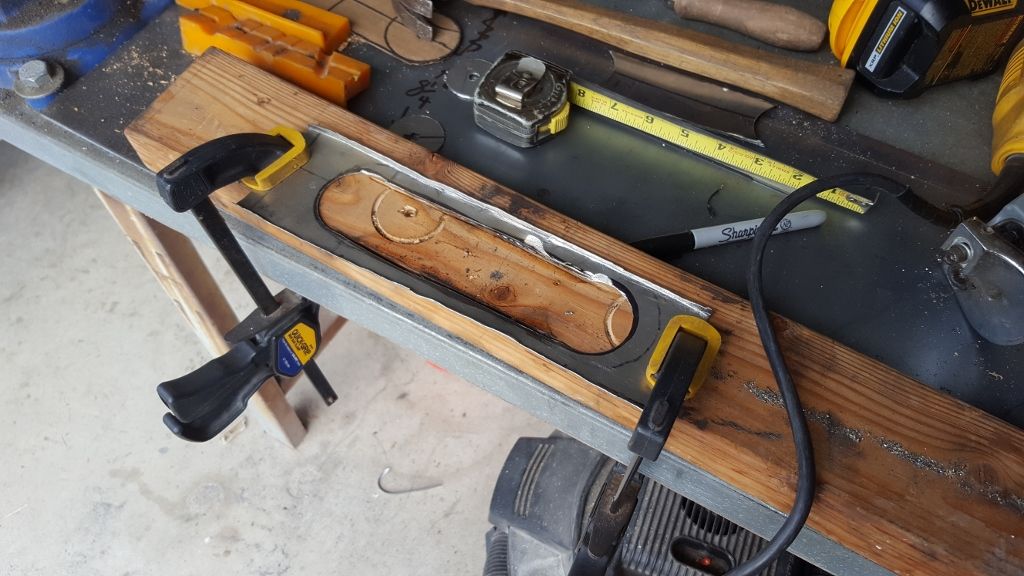

    Intercooler intakes
    Time for more airflow to the intercooler and radiator.
    Bumper cut. But I don't like the raw plastic edge look.
    Air duct fabrication in progress.
    Getting better at welding.
    Finished product looking really good.
    Mounted in the bumper. Will look even better painted. Calling it a day since it's 80F in the garage again.
