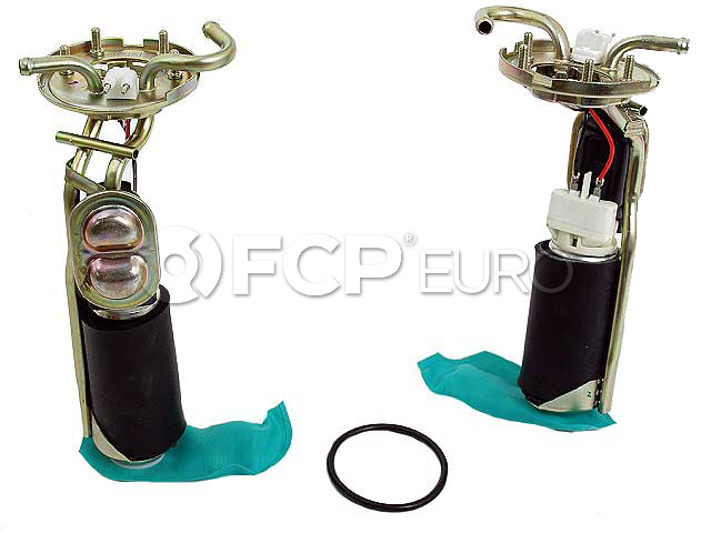

      Yeah, that little hump in the line is the pickup for a venturi pump, here's a thread that shows what it looks like in detail . If undid the return line at the tank and fuel pressure returned to where it should be that's a good indication that the venturi is the restriction, maybe clogged from sucking up silt in the bottom of your fuel tank, but that tank looks clean to me. Try feeding some steel wire down the return line to unclog it, if that doesn't do it the internal line and venturi itself might just be too small for the volume of return flow you're producing with that big pump. A possible solution would be to get the sender bracket from a car with a crossover pipe style tank and split your return line between the existing venturi line and the return line fitting on the sender bracket.

          This part has a return tube in cars which have tanks with a crossover tube on the bottom of the tank (like mine).

            oh interesting. looks like they used the same cap for the weird late model tank
            and just plugged it up. link to where i can order one?
            also i was thinking of drilling and bulkheading a 5/16 elbow on the top of the driver side tank and just Y to that one..

              Thanks for that suggestion the 318is return fixed the issue.
