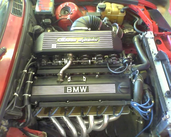

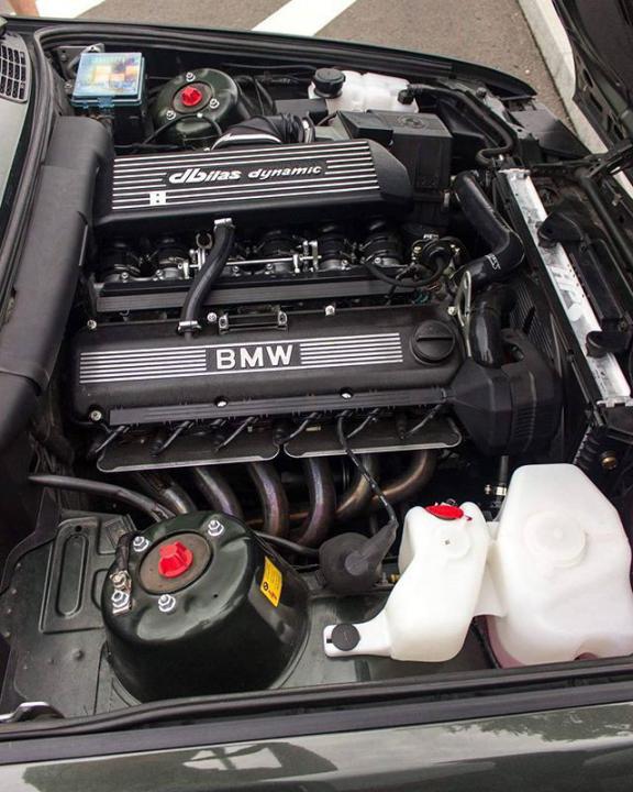

                Not necessarily true, but definitely optimal yes. Dbilas Dynamic in Germany makes (IMO) the prettiest ITB setup for M20s. They aren't cheap (~2000eu), but the OEM+ style of them really gets me. They have a plenum with a single inlet boot to attach to a stock AFM, and for an extra 300eu they offer a chip for the stock ECU to make a claimed 20hp. They also sell cams for M20s and chips for those, so I imagine it might be possible to get a chip capable of both? You could obviously go to a standalone further down the line and delete the AFM too.
                ITBs:
                With MAF conversion:

                With AFM:
                  ITBs:
                  https://dbilas-shop.com/en/intake-tr...2v-m20?c=11055
                  Click image for larger version  Name:	dbilas-m20_tumblr_ltwqthmw4i1qij36ho1_1280.jpg Views:	0 Size:	83.6 KB ID:	9890950
                  With AFM:
                  Click image for larger version  Name:	bd632b6efbead69e334e2aa267aa9b70.jpg Views:	0 Size:	72.5 KB ID:	9890951
                  yeah have a mate that runs MAF with Miller WAR in conjunction with the RHD itbs seems to work ok. Can be done but there are several standalone plug and play options so it doesn't make much sense with anything else.
                  the dbilas ITB kit looks nice but performs horribly
