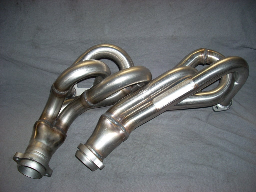

            they are 304 to, not 400 series. yeah the collectors are not nice look kinda huge, but neither are the remade RD ones compared to the originals
            http://www.bimmerfest.com/forums/pic...ictureid=28911
            https://www.iemotorsport.com/wp-cont...S-5-scaled.jpg
            https://www.e30zone.net/e30wiki/imag...e/P1010040.jpg
            by eye the originals look like smaller collector size?
