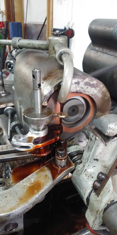

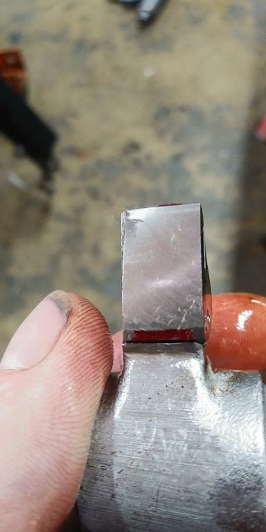

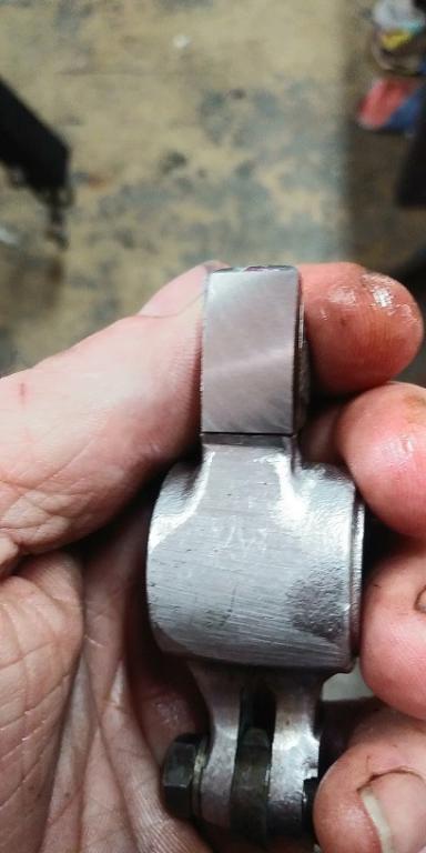

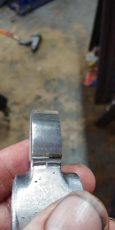

                            Even though they "look" good, they need to be refinished for a new cam (and technically if you change them from lobe to lobe).
                            It's hard to capture since so little is being taken off. Tried using some layout dye but the coolant in the machine washed it off the pad for the most part.
                            Used rocker (m30, but same concept):
                            Click image for larger version  Name:	20200527_124409_1.jpg Views:	0 Size:	26.0 KB ID:	9928341
                            One brush on the grinding wheel:
                            Click image for larger version  Name:	20200527_124049_1.jpg Views:	0 Size:	32.5 KB ID:	9928342
                            Second pass:
                            Click image for larger version  Name:	20200527_124254_1.jpg Views:	0 Size:	33.4 KB ID:	9928343
                            And the Souix machine:
