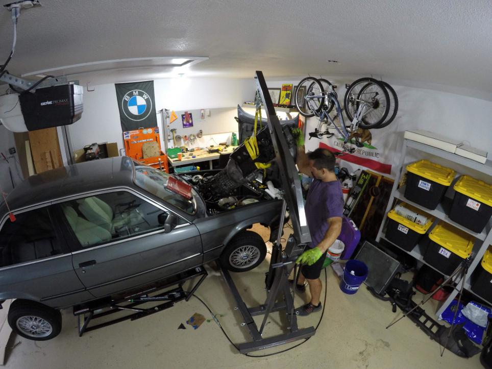

                    I thought I'd provide an update on the this situation.
                    Long story short, it does appear to be the timing belt tensioner pulley. There's no obvious play in the bearing, but rotating by hand reveals the movement is a little less smooth than the new pulley I have. The reason I say it appears to be the pulley is that my repair plan snowballed drastically to the point that the engine & trans is now out of the car, the head is at the machine shop, and I'm tearing down the block for the same treatment. I was burning a lot of oil (at least 1qt every 500 miles), and she failed smog. After changing plugs and cleaning & sealing the intake she failed again. I've been wary of the head gasket and the bottom end (specifically rings), as I know the head was rebuilt by the PO, and the bottom end wasn't touched. I thought if I'm tearing the front apart and taking the timing belt out, I may as well go all the way rather than come back in a year and do it all again.
                    Wish me luck.
                    Here's a little action shot...
