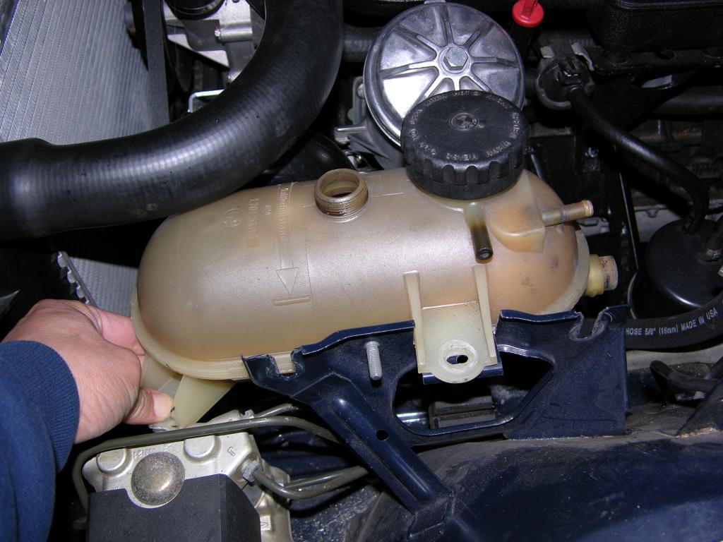

Lower radiator hose and overflow tank issues
The lower radiator hose is not reaching the radiator. I needs to be about 1 inch longer. I did order the e28 hose which is suppossedly longer than the e32 one but no luck. Any suggestions? What did you use?
I also need suggestions where to locate the overflow tank. I have an 87 so placing a later model tank on the driver side runs into several problems. In some locations the outlet is blocked by the ABS lines or if moved more towards the driver it is blocked by the air filter housing bracket.Comment
Used an e28 535i hose and it fit, it was longer than the e32/e34 hose.Mtech1 v8 build thread - https://www.r3vlimited.com/board/sho...d.php?t=413205
OEM v8 manual chip or dme - https://www.r3vlimited.com/board/sho....php?p=4938827Comment
I tried that, didn't work for me. I had to splice on about 2" of extra hose. BTW make sure that if you go this route, buy real actual coolant hose splicing nipples from an auto parts store. Don't just use PVC or something like that. They will get soft when hot and come apart, stranding you on the side of the road.
Ask me how I know.Comment
