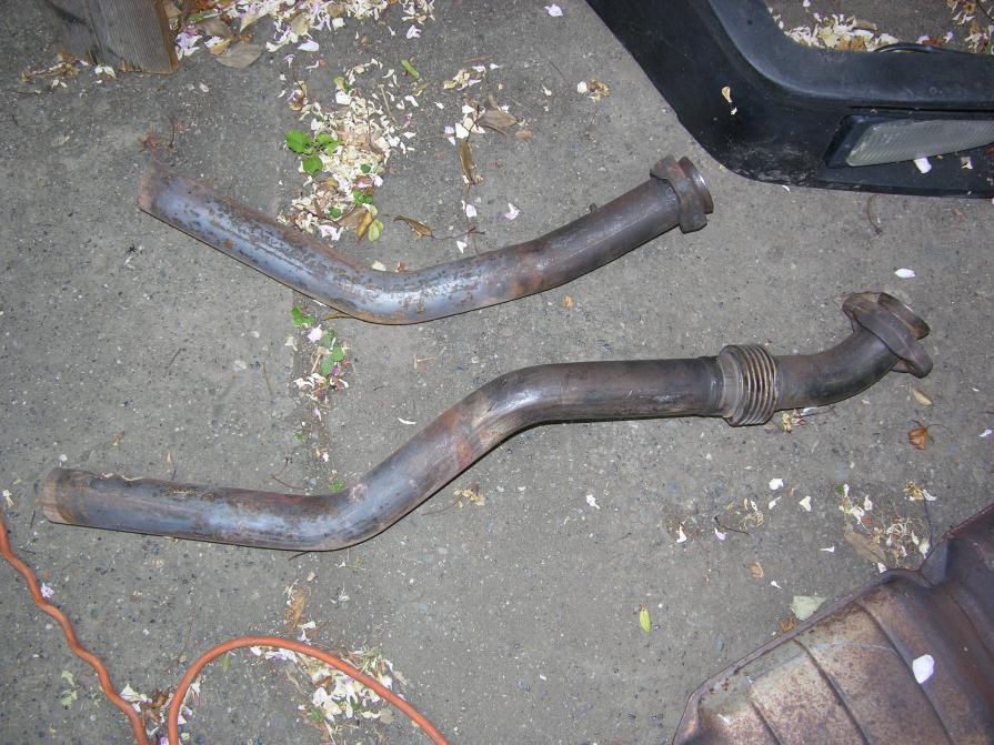

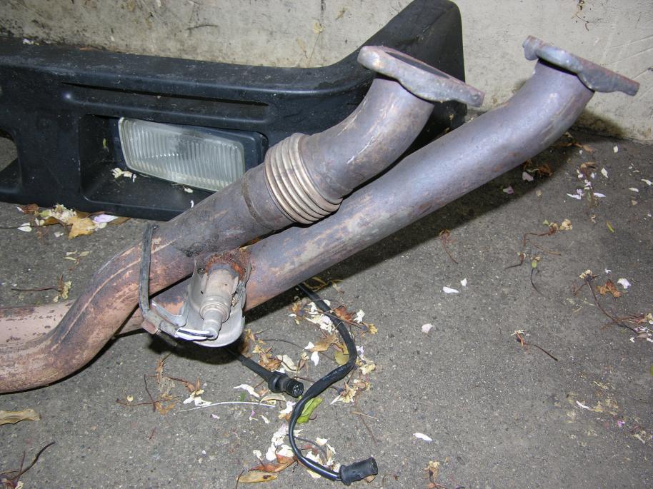

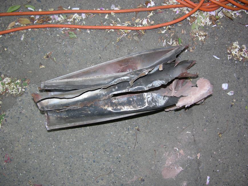

                  Cutting the M30 downpipes
                  So I took off the insulation of the downpipes and then cut them a little long. Its going to take several cuts I think to get them to fit the 325i exhaust but I will be screwed if I leave them too short.

                  The horror, the horror
Name:	insulation downpipes.jpg
                  For now I will be using the 325i exhaust but somewhere down the road I would like a nicely done system.
Name:	325i exhaust.jpg

                      Originally posted by bataangpinoy
                      bump. im actually looking to do my exhaust as well, but i will use e34 downpipes and graft it to the i exhaust.
                      and bump for good info.
                      That is what I'm doing. But the downpipes are from an e32. I'll be posting more pictures soon.
