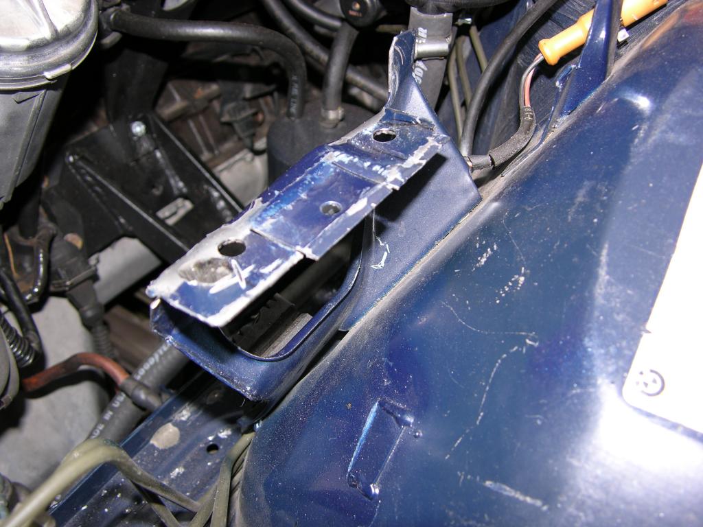

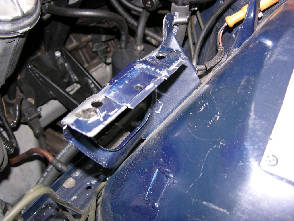

                    Originally I was going to use the early year tank but the location I found was below the top radiator hose. After a few days of fiddling I finally was able to come up with a way to secure the later years coolant tank but it took a lot of work to get it secured in that location.
                    I modified the bracket where the air filter was located.
Name:	modified bracket.jpg

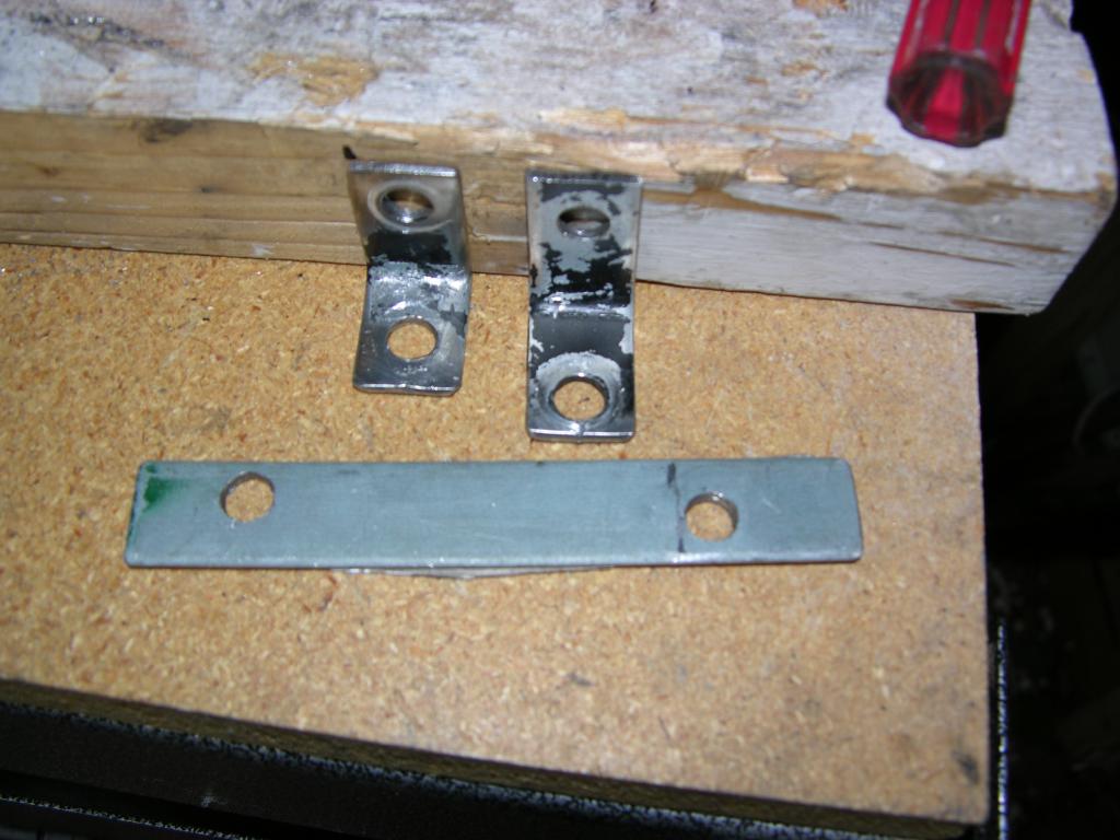

                    Then had to fabricate some L brackets and a flat one.
Name:	L brackets.jpg

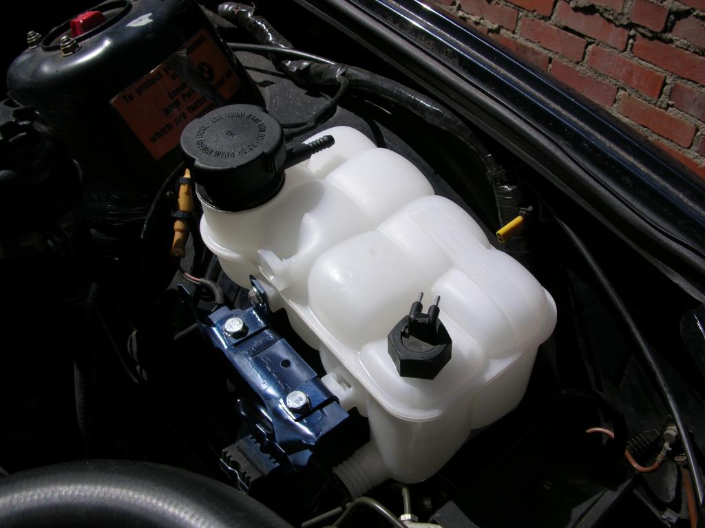

                    After some painting I bolted the tank. I'm not 100% happy how it looks but it will do for now.
Name:	overflow tank bolted.jpg

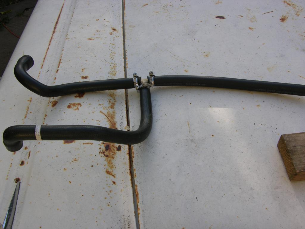

                    Using a 3/4 T fitting I got the heater and overflow hoses ready.
Name:	overflow tank hoses.jpg

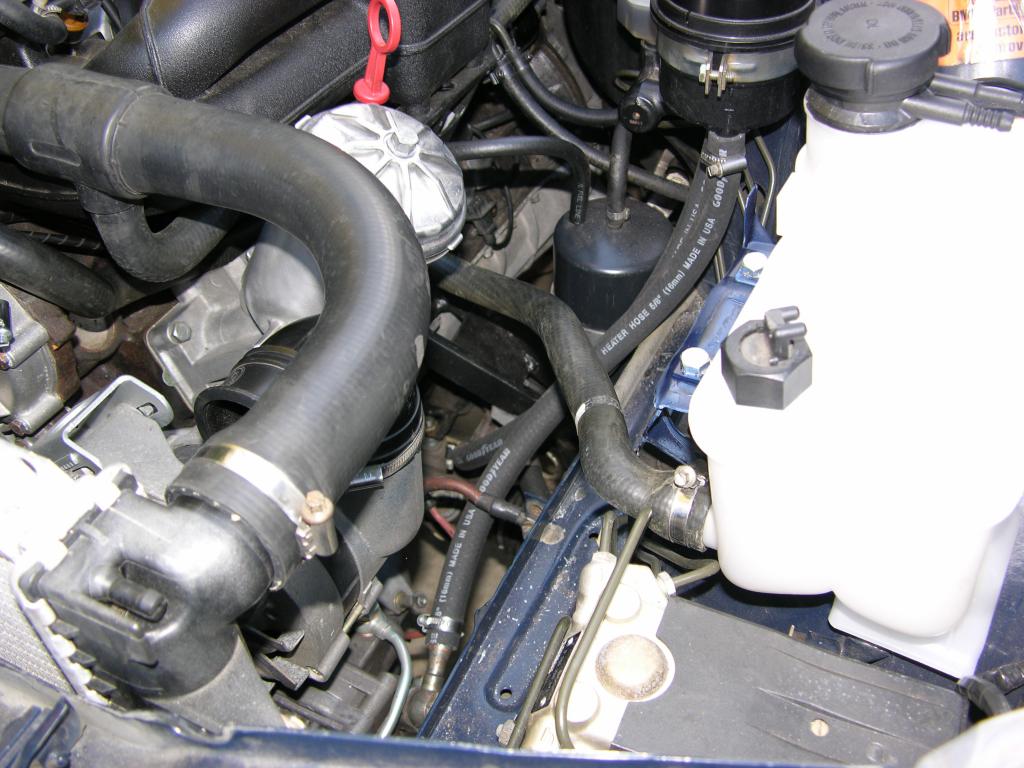

                    Here is the end product. Only the lower radiator hose needs to be modified.
Name:	coolant tank connected.jpg
