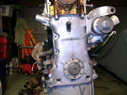

      Finally I was able to get back on track with the project. I was able to find a rental company that had an impact wrench gun rated to 475 ft pounds so I was able to get the "Jesus" nut off. Even then it took several tries to get it off.

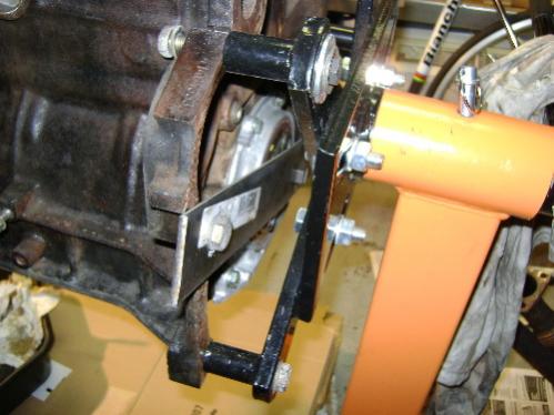

      I made a tool to hold the crankshaft from turning. Cheap but it works.
Name:	crankshaft holder.jpg
      I'll be replacing the plastic bits tomorrow.

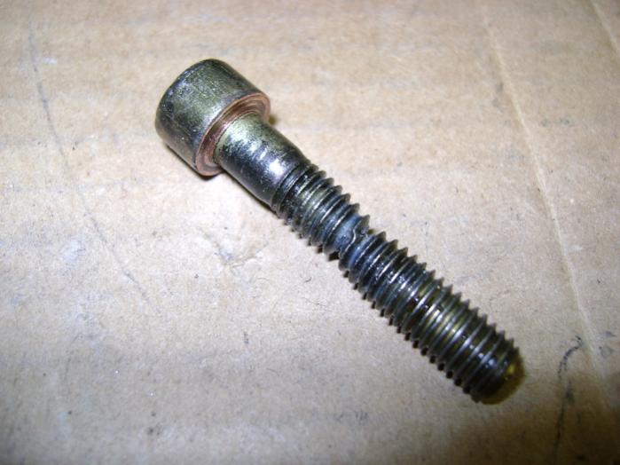

                I broke the bolt that holds the camshaft adapter. There is a $.49 copper washer between the bolt and the camshaft that you are suppossed to replace everytime you torque the bolt so I spent half a day driving around looking for it.
Name:	camshaft adapter bolt.jpg

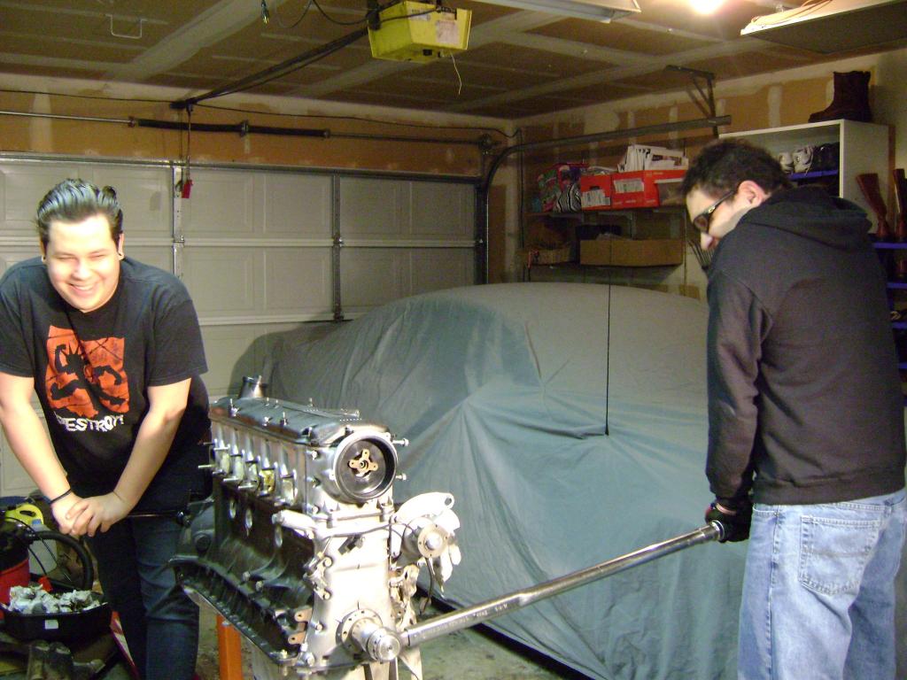

                  So I rented a torque wrench to install the crankshaft nut. That thing was so huge it looked like something out of a cartoon.
Name:	Cranking the nut.jpg

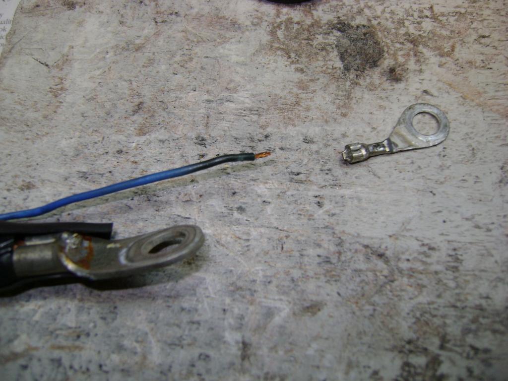

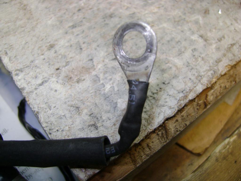

                  While installing the wiring on the alternator I discovered one of the connectors was broken. A little solder, shrink tube and the soldering iron took care of that.
Name:	broken connector.jpg
Name:	fixed connector.jpg

                    Awsome progression on this project dude! It looks great so far.
                    Curious, why are you wearing sunnys in the first picture of post #53? Maybe you should have just turned the lights out i it was too bright? lol.
                    Keep the pics coming!
                        They are actually Bolle's with lenses that turn dark with sunlight and clear inside plus they have a prescription. I use them as my safety glasses.
