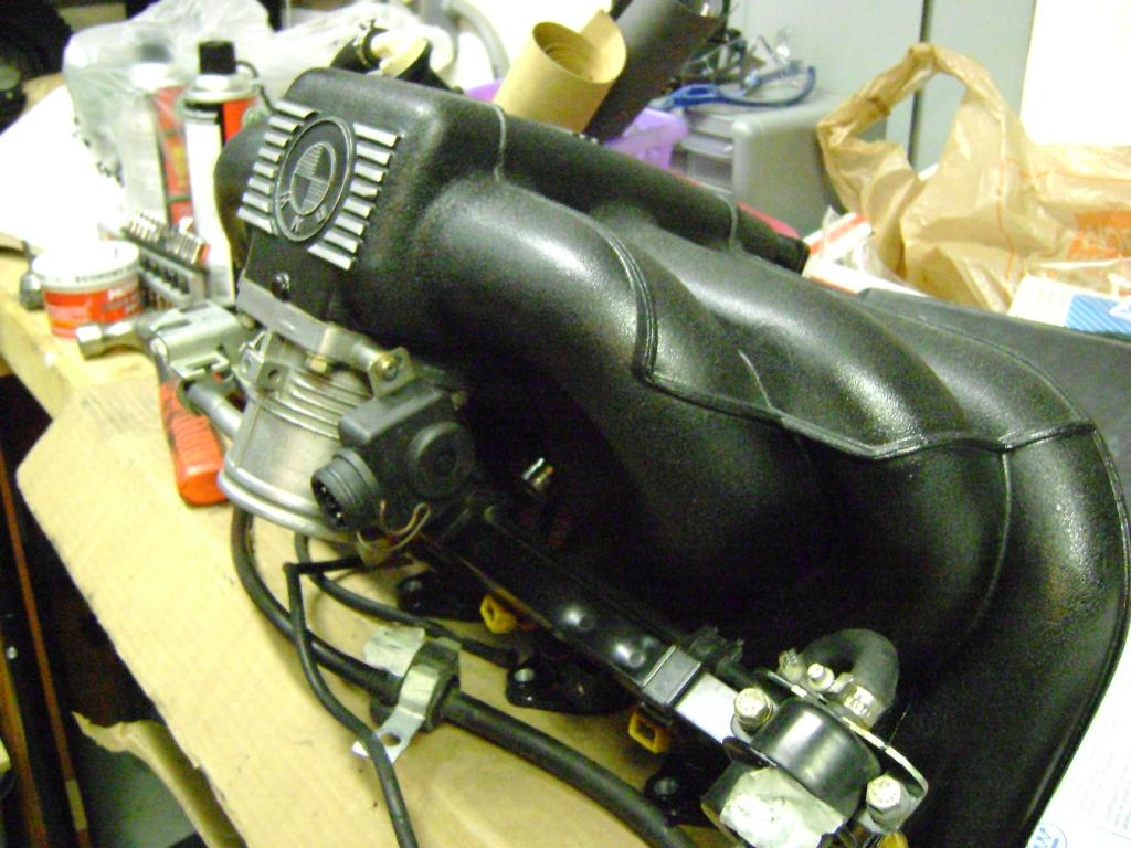

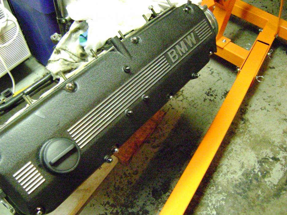

    I painted the valve cover and the intake manifold with crinkle paint. Looks good I think.Click image for larger version

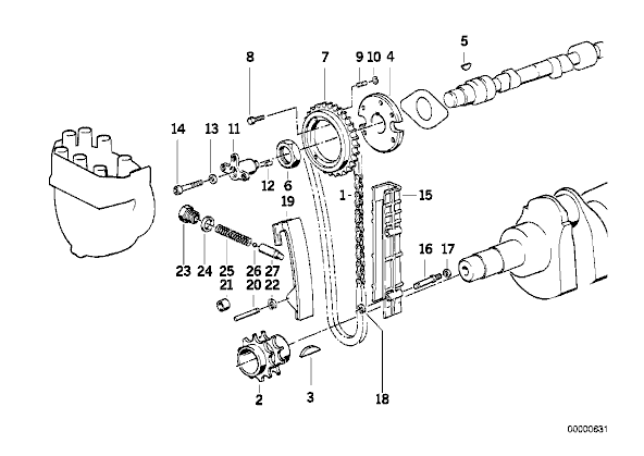

                      Couldn't find a clear answer to this. Can you remove the rails #15 & 19 without pulling the chain?
                      • yert315
                        • 2734
                        With all the work you will be doing to replace those rails, pulling the chain is nothing. You have to remove the upper and lower timing case covers, which also means removing the crank nut on the front.
                        • george graves
                          • 19998
                          crank nut = ungodly TQ. And reverse threaded too IIRC
                          Originally posted by Matt-B
                          • Brian D
                            • Mar 2006
                            • 832
                            Nope, standard thread direction. I wailed away for about 5 minutes with a good impact gun to get mine off.
                            1973 Bavaria
                            • weaksauce
                              • Apr 2009
                              • 550
                              i tried mine with an impact, and also with a 3 foot cheater bar. i ended up bending the pry bar i was using to lock the crank in place.
                              • Jean
                                • 18228
                                Had no issues with that, locked it at the back/flywheel area and used air gun.
