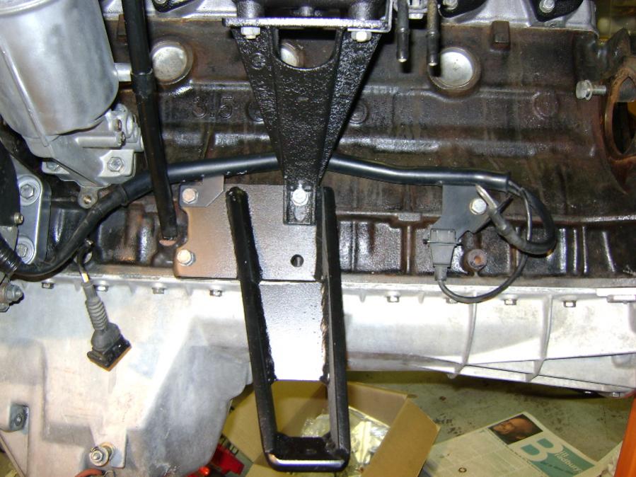

More updates

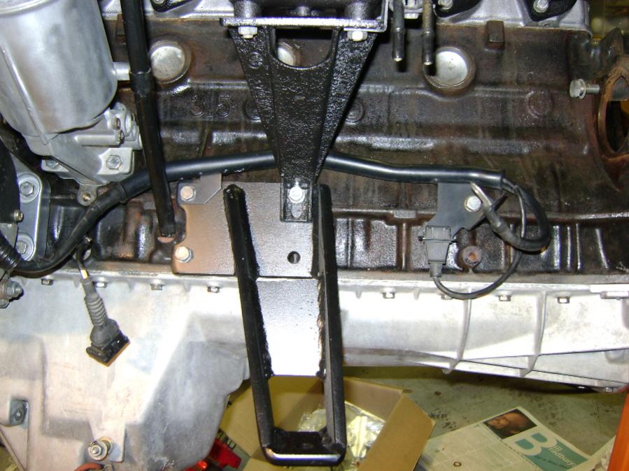

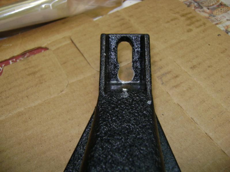

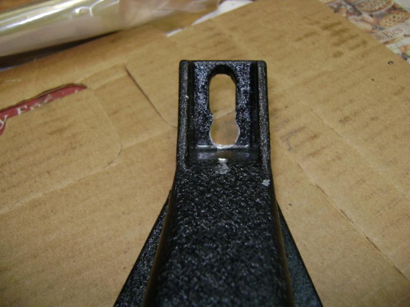

I had to modify the input manifold support to use the motor mounts. Just needed to enlarge the slot where the motor mount bolt goes plus a little bit of grinding.

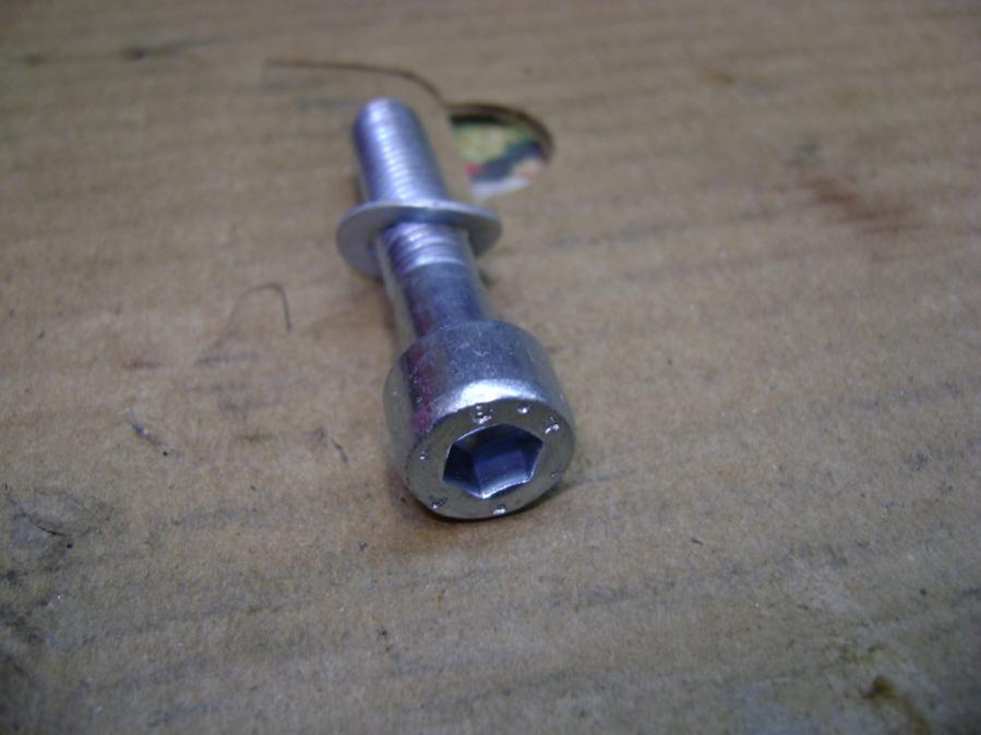

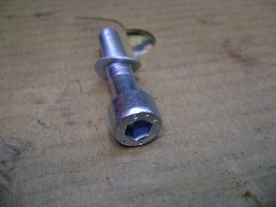

Switched to a socket head bolt to be able to attach the support.
Looks like an OEM set up.

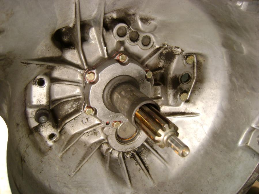

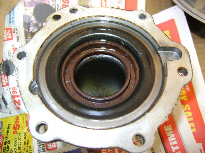

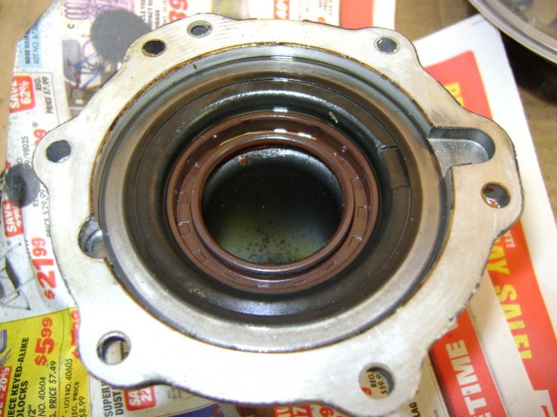

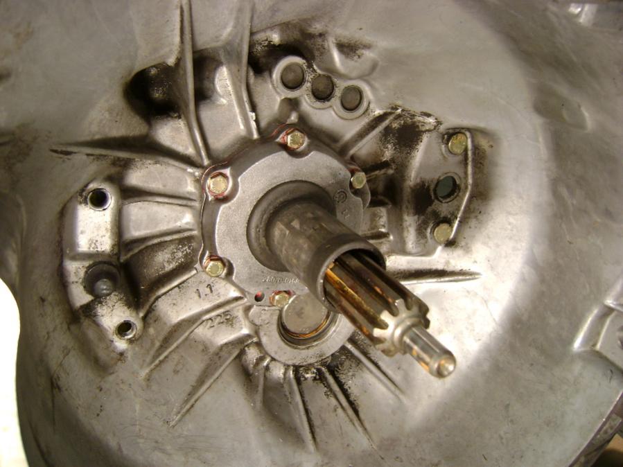

While I'm waiting for the Z3 shifter I ordered from Blunt I started replacing some of the transmission gaskets. I did the input flange but I don't think I'll be doing the output. I might regret it but I'm running out of time and patience.
The rear one at least you can do w/o removing the tranny IF you have to do it ;)Mtech1 v8 build thread - https://www.r3vlimited.com/board/sho...d.php?t=413205

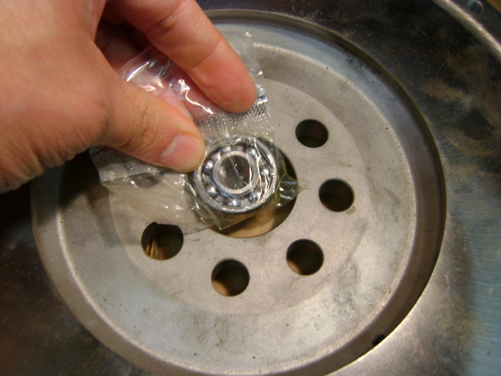

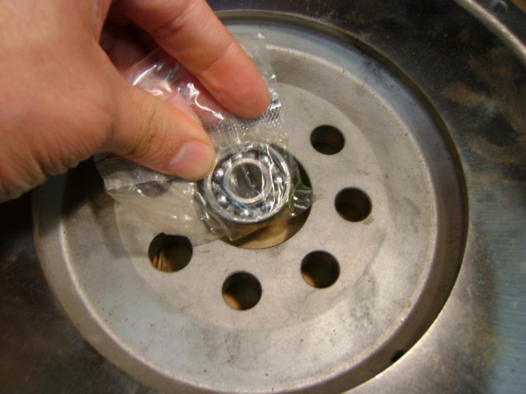

Wrong bearing too
