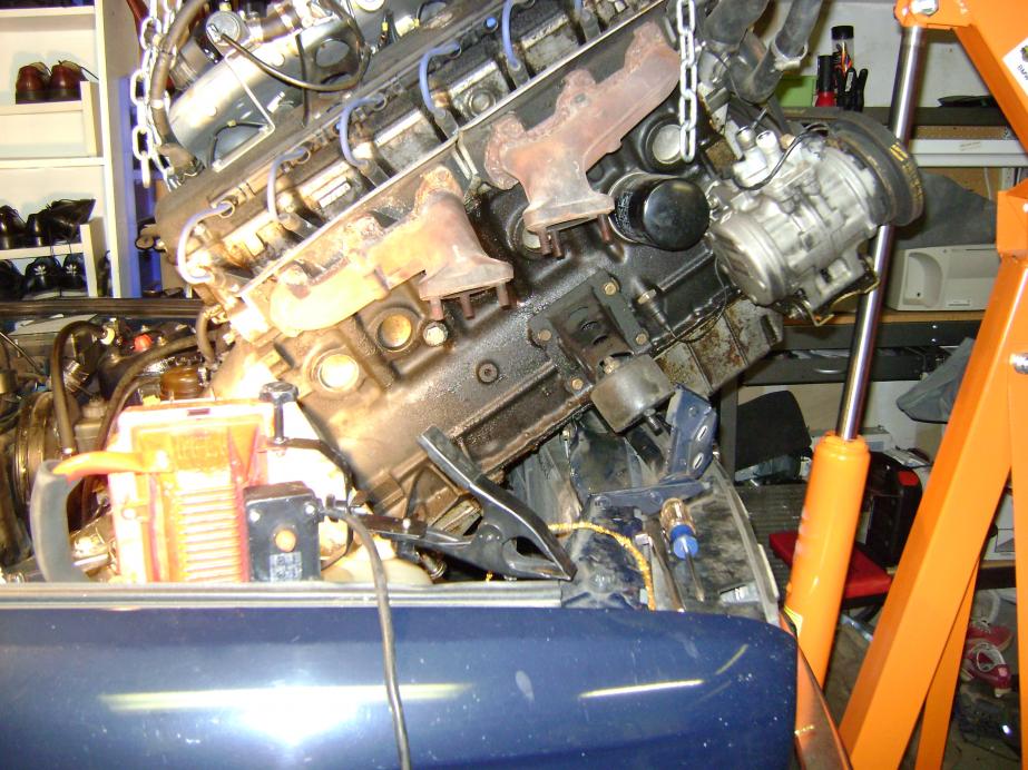

      Pulled the engine out
      Progress has been slow because I'm moving to another house.
      I got the engine out even though I made some rookie mistakes. I got the engine hoist to its maximum lift but the engine wouldn't clear the front of the car. Until I remembered to lower the car from the jackstands. :roll:

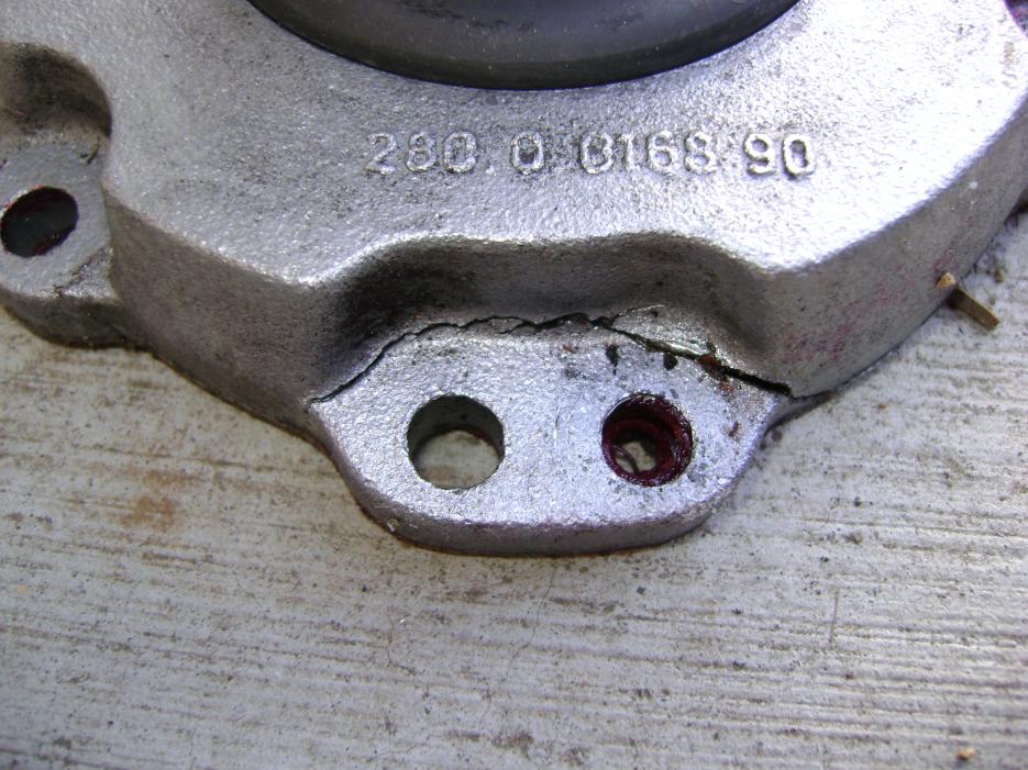

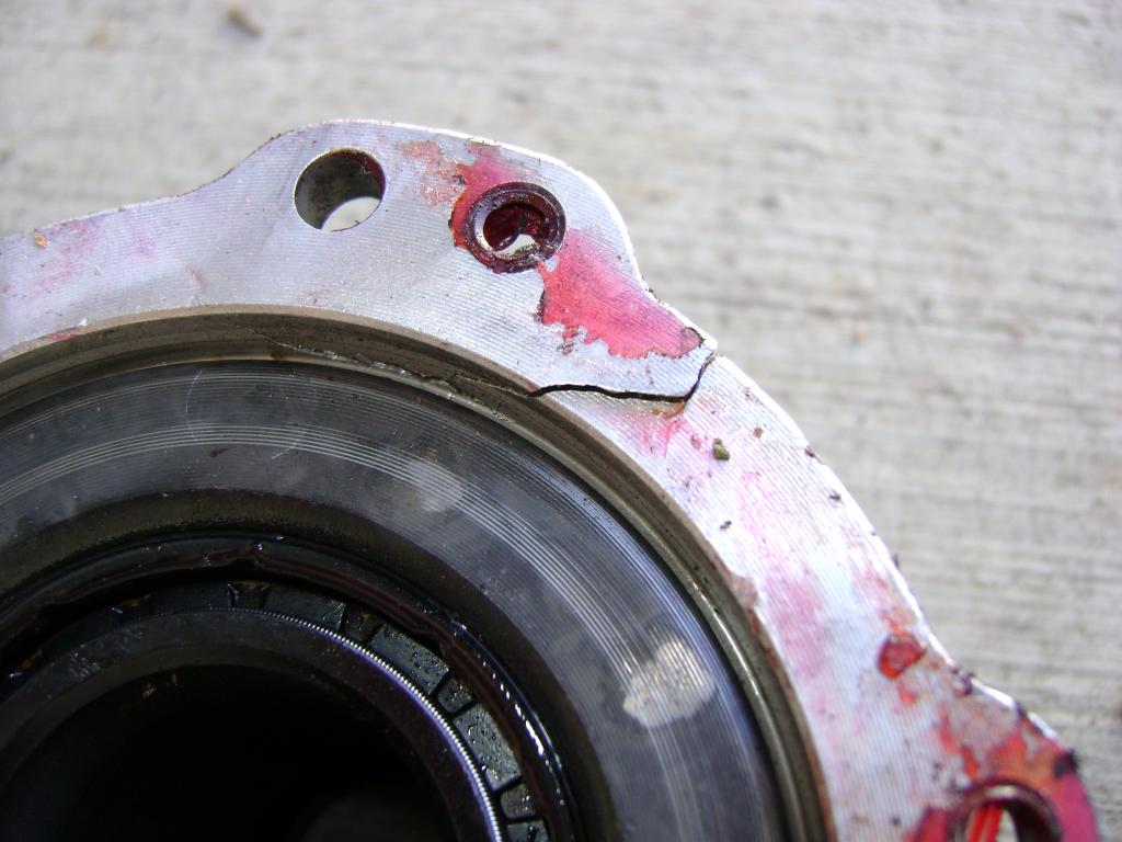

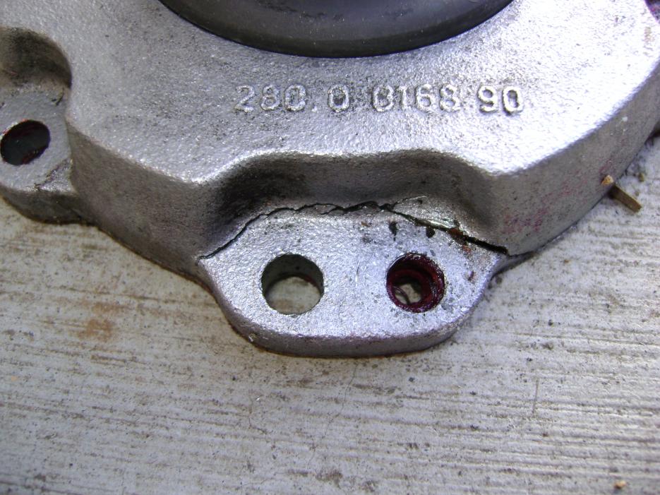

        Disaster
        I was about to bolt the transmission to the engine when I noticed some tranny fluid in the bellhousing. Unbolted the input flange and there is a crack
        There is a little round washer that sits in a recess but it moved when bolting the flange to the tranny housing. This is going to cost a few hundred bills and a week at least.

          #79
          looks like it's been patched before.
          edit, nevermind, just noticed you pulled it before.

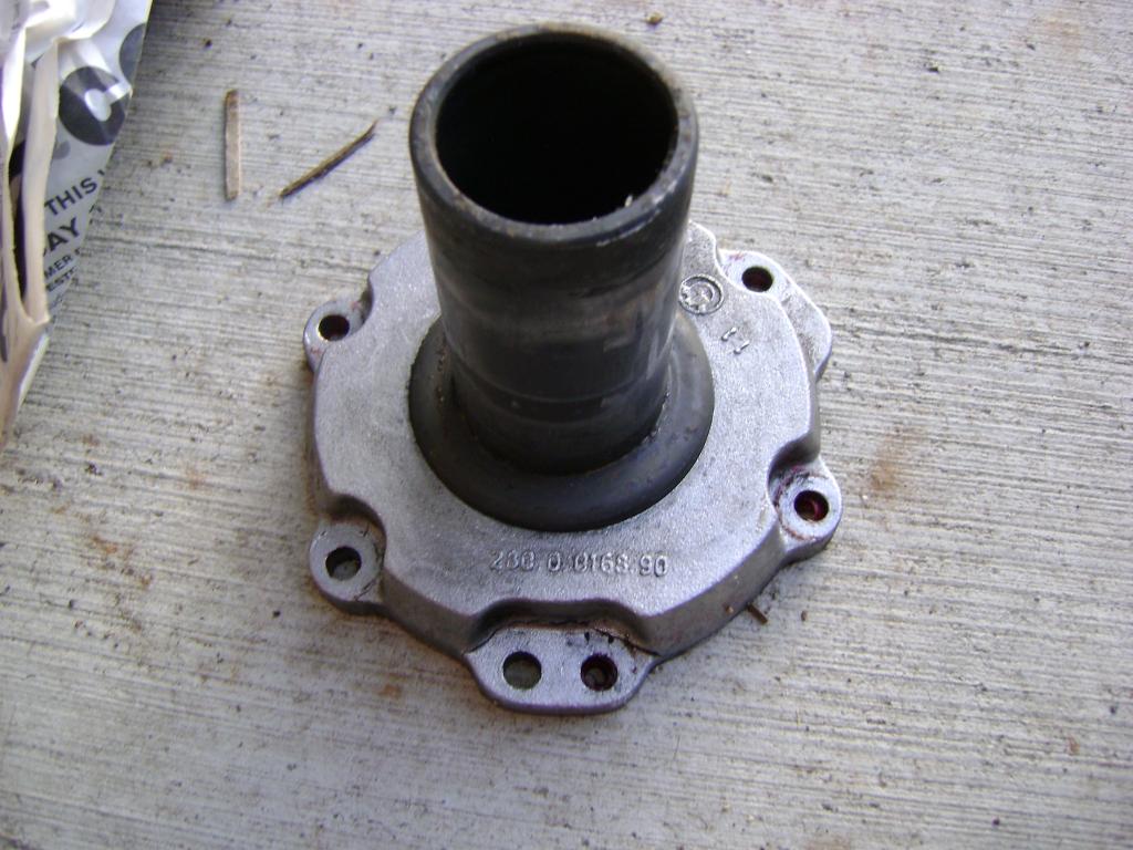

            June 3rd 2010
            It has been awhile since my last post but you will see why.
            Last update had me discovering a leak in the transmission and it turned out to be the tranny input shaft cover. I ordered a replacement from Blunt but the part had to come all the way from the motherland because BMW did not have any in the states. So as carefully as possible I installed it. In goes the tranny, it gets bolted to the engine. :)
            Engine looks good, tranny looks good.

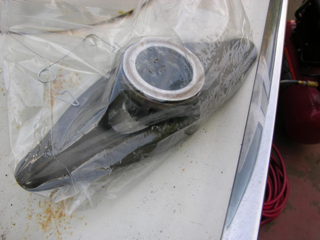

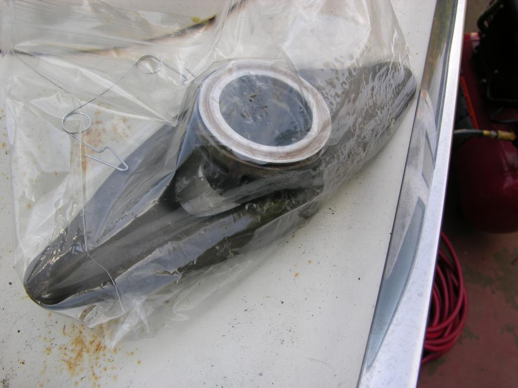

            But wait...What is this??:crazy: NOOOOOOOOOOOOOOOO!!!!
Name:	Bearing and clutch arm.jpg

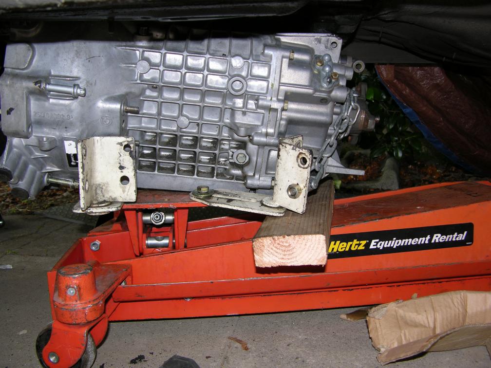

            In the meantime the company I worked for decided to shut down the plant. So I decided to go back to Cali. My whole family lives there. My E30 is always ready for a road trip no matter how.
Name:	Burrito California bound.jpg
            Finally in Cali I have time to rent a tranny jack, pull the tranny, install the TB and clutch arm. The worst part was getting the subframe to align so the bolts would go in. I hope the worst is over and there will be more frequent updates showing progress.

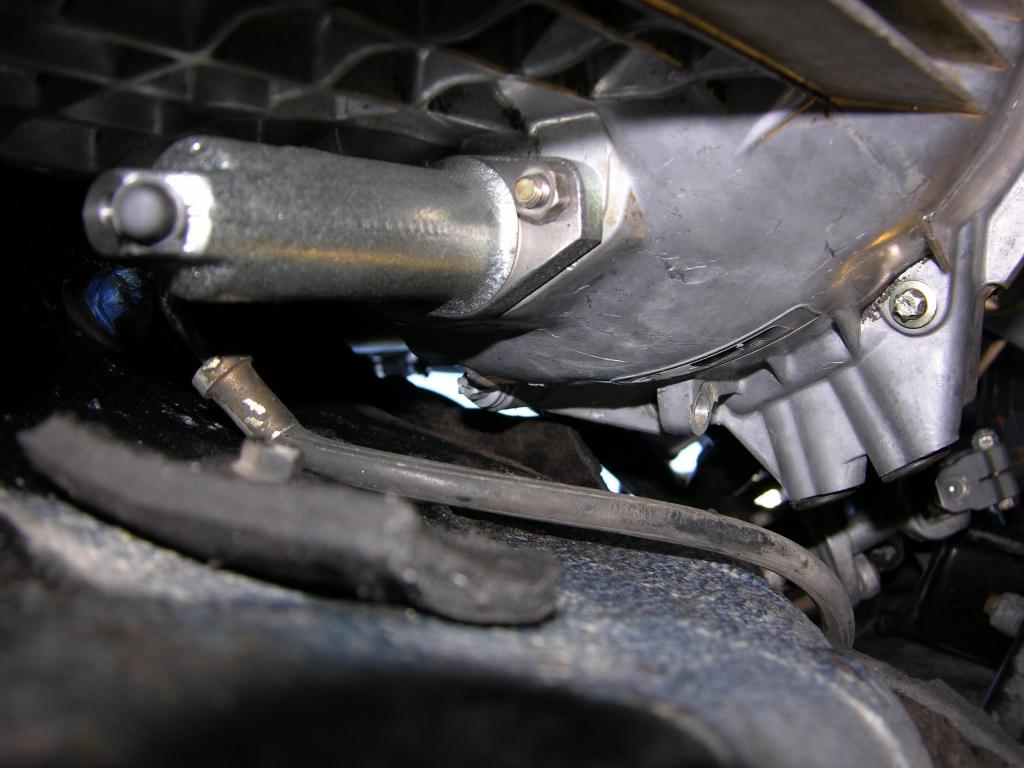

                        June 11th update
                        Swap is moving forward. Installed a new clutch slave cylinder.

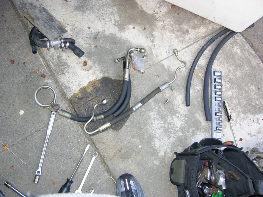

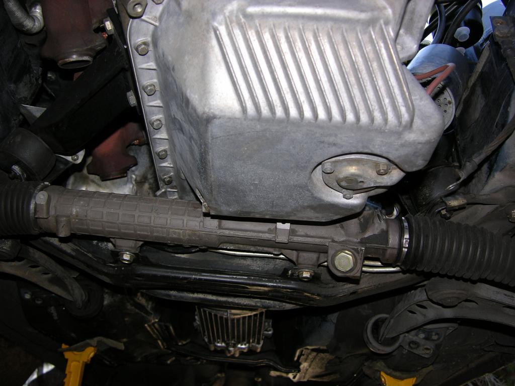

                        I'm also finishing the lines to the steering rack and reservoir. I was able to get a 95 M3 rack so there is going to be some modifications to be made to the lines.
Name:	95 M3 steering box.jpg
Name:	High pressure steering lines.jpg

                              Will that mount give you enough room for the downpipe?
                              Looks really close in that picture.
                              • 1987E30project
                                • Dec 2006
                                • 432
                                #90
                                The front down pipe has enough space but the one in the rear is very close to the firewall. Worse case I will have to use the BFH and create some space.
