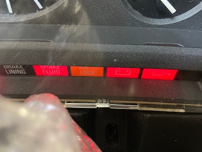

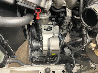

              New alternator did the trick.
Name:	lrZdbPriDjOf1rxHwTvGMAPeFq7VSsrACiWjOLt1-U7mSQ8iG2F8KMu_mjIf0zskf_y7XicR11JHEvVDJ4eocTJyXQsi7i67T3xfb2EWWU4YuwvURXoOER9T1Dc_7u6jMQPeCMBEFQ=w400.jpg
              Battery light on when car turned to position 2 and not running:
Name:	xU2inkaXjistB6UlCZYN9D4RtA5Ug7Nbp-I2WotaiGrwxCLgfMtuCpiTDutb1AU7t-afjdEGF2Dmzb436OVEEY1q-xkgKnYeouRjUwTAk-rhhW8UUFWpkx1VTglaQM4TviQs6uzfpw=w400.jpg
              Proper voltage and behavior otherwise too.
