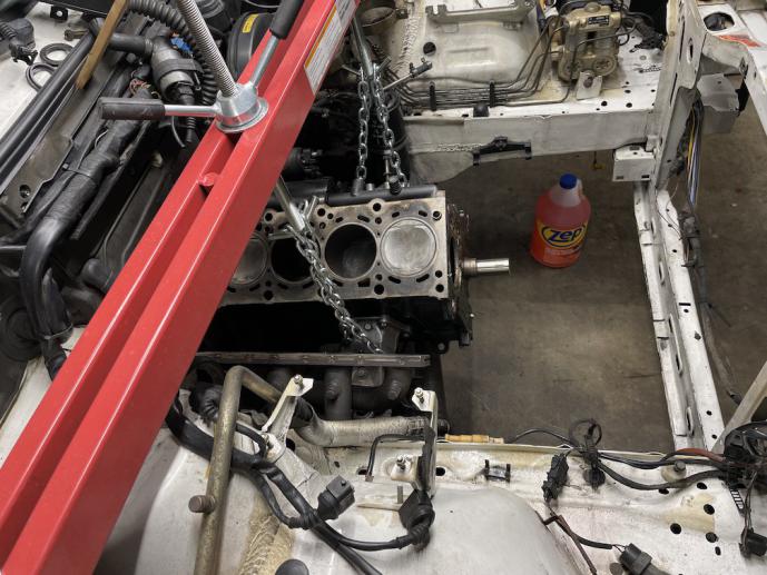

    Doing the above steps brings you here:
    Click image for larger version  Name:	IMG_4788.jpeg Views:	3 Size:	66.7 KB ID:	10029734
    Click image for larger version  Name:	IMG_4792.jpeg Views:	3 Size:	70.4 KB ID:	10029735
    Pleased to see cross-hatching in the cylinder bores.
    Click image for larger version  Name:	IMG_4783.jpeg Views:	3 Size:	61.1 KB ID:	10029736
    Head gasket doesn’t seem to have major blow outs.
    Click image for larger version  Name:	IMG_4789.jpeg Views:	3 Size:	66.6 KB ID:	10029737Click image for larger version  Name:	IMG_4790.jpeg Views:	3 Size:	64.8 KB ID:	10029738

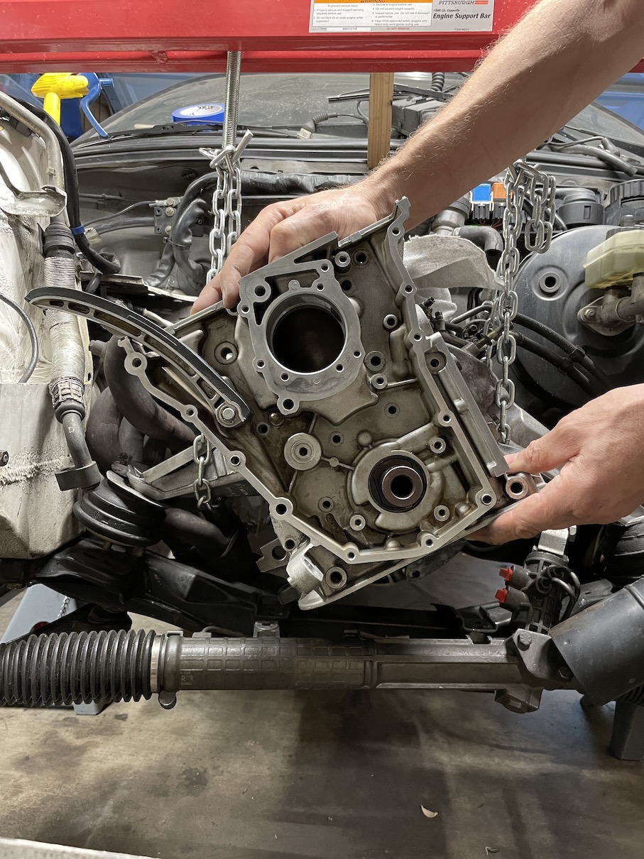

    Front timing case to block gasket looks on the way out (sooo glad I chose to do this).
    We cleaned the block and see some corrosion.
    Also a cracked lower timing chain rail. New part will be installed.

        Getting Started
        After considerable research and a mock up of the build process, we will be installing the system in two phases:
        Phase 1
        1. Lower engine timing case
        2. All components attached to the lower engine timing case (idler wheel, deflector rail, timing chain, etc.)
        3. Lower timing case cover (timing chain will be sticking out the top).
        Phase 2
        1. Profile gaskets
        2. Cylinder head
        3. Upper timing case cover

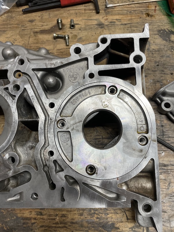

        Step 2: Install oil pump to lower timing case.
        Parts
        • Oil pump, PN 11141714611
        • Oil pump cover, PN 11141714613
        Steps
        1. Remove old pump cover and oil pump. (6mm Hex wrench)
        2. Pack new pump with assembly lube to assist with priming.
        3. Tighten bolts to M6 torque. I used a drop of blue locktite.
          • M6 Bolts - 10 NM / 7.4 ft-lbs / 88.5 in-lbs
        Here is the original. New is installed the same way.
        New installed and loaded with assembly lube. Cover torqued to M6 spec (10 NM / 7.4 ft-lbs / 88.5 in-lbs) Drop of blue locktite on each bolt.

        Phase 3 - Install the Lower Timing Case
        Pay attention here!
        Step 1: Install lower timing case gasket
        Parts
        • PN 11141739868
        Steps
        1. Test fit the paper gasket to the block.
        2. Check where it overhangs into profile gasket
        3. Trim the gasket as needed.
        Prep the block with brake cleaner and wipe down afterwards.
        Back of timing case got the same treatment, after lightly sanding (1000 grit with sanding block). Clean all surfaces (we used clean towel + brake cleaner).
        Test fit the gasket:
        Trimming not necessary as far as I could see.
        Test fit the cover just for fun.
        Ok, time to install. Spray gasket on both sides of the gasket. Do this off the car. Light spray. Don't put too much. I wasn't happy with the first try. The spray nozzle was not even, it left clumps as well as a spray. I hope this isn't a problem. We let it dry until it was sticky. If you use the same, we recommend test spraying on paper first.
        NOTE: We went back and did this again with a new gasket. I didn't photo the new gasket, the process is identical but it turned out much better.

        Step 2: Install lower timing chain case to engine block
        Parts
        • None
        Steps
        1. Mount the case to the block
        2. Install the bolts in the right locations, finger tight.
        3. Add blue locktite
        4. Torque the bolts as per below, in the order listed.
        NOTE: Be careful, some have noted that threads in the block can strip. Make sure threads are clear. Don't over torque!
        Additional reading:
        * https://www.r3vlimited.com/board/for...-request/page2
        The M6 ones are tightened to 10 Nm / 89 in-lbs, and the M8 ones are tightened to 22 Nm / 195 in-lbs. There are occasional exceptions with special higher grade fasteners, but not with any of these. If you really want to be extra careful, you could use some medium strength thread locker, although it is really not necessary.
        We used this photo for torque values from the link as reference. Not my engine. Torque in the order shown. 1 - 2 - 3 - 4 - 5 - 6
        Here we placed the cover over the gasket. Before installing the bolts, we inspected each hole to ensure the gasket was not covering threads. We installed the 17mm bolt first, after applying a drop of blue locktite. Just snug, not torqued.
        We then installed all bolts, again just snugged up. Then we followed the torquing order in the diagram listed above. #1 is the 17mm, etc.
        Be careful to pay attention to the torques! Stop if it doesn't feel right!
        M6: 10 NM / 7.4 ft-lbs / 88.5 in-lbs
        M8: 22NM / 16.2 ft-lbs / 194.7 in-lbs
        (47NM = 34.7 ft-lbs)
        We then followed the first diagram and torqued the bolts accordingly. Note that this photo shows the idler wheel installed, which is technically covered in the next step. Doesn't matter when you do it.

        Phase 4: Profile gasket and Cylinder Head
        !! Pay really close attention now !!
        Here is the TL;DR. Details on each step will follow.
        • Put tiny bit of sealant (hondabond, RTV, etc.) across the entire lower part of the profile gasket channel (lower timing chain case + cover). I mean tiny amount, very thin skim. A bit more in butt joint area. Alternatively you can add the skim to the gasket. It dries fast.
        • Immediately press on both sides of the profile gasket. Add a bit more on the actual butt joint itself (not just top and bottom, but the parts that meet).
        • Lay head gasket on engine block
        • Put another thin skim of sealant (hondabond, RTV) on the top of the profile gaskets, again a bit more in butt area.
        • Lay head in place w/o front timing chain cover in place
          • Really helpful to have a second set of hands here. You don't want to mar the surfaces. Try to lead with the side of the head that has the chain.
          • Also - I put a bunch of garage blankets/foam on the passenger side fender so that I can rest and have a place to hold the head. Really helped.
        • Thread timing chain over the camshaft ends
        • Make sure head is even and snug.
        • install front top timing chain cover gasket (Permatex light spray)
        • Install front top timing chain cover. Don't torque.
        • Oil head bolts AND WASHERS and put in place. Should be ten each.
          • Don't worry about the cam alignment yet, but they should be very close to how you want them. You can't use the tool yet b/c it will block access to the two most rear ward head bolts.
        • Torque head bolts as per directions. (see below)
        • Clamp the front top timing cover to compress flush with top of valve cover
        • Torque timing cover to spec
        Here we go:

        Step 2: Lay the cylinder head gasket on the block
        Parts
        • PN 11121721547
        Steps
        1. The top of engine block should be clean and dry. Make sure cylinder tops are clean and dry too.
        2. Place head gasket on block, writing side up, with "Front" at the front.
        3. I am choosing not to spray gasket with copper spray, etc.
        Note: I went with Goetze brand HG for reference.
        Step 3: Lay the cylinder head on the block
        1. First, rotate the engine clockwise 45 degrees so that outer two cylinders are down so as not to touch the valves. See guidance below.
        PHOTO HERE
        Additional reading:
        * http://www.m42club.com/forum/index.php?topic=11162.0
        Put your 24mm socket on the crank bolt and move turn it counter clock wise about 45 degrees to bring ALL of the piston tops down from the top of the block.
        2. Carefully place head on top of the block. It should not rock.
        3. You will need to work carefully. Have a helper move the timing chain so you can keep both hands on the block. (see step 4)
        PHOTO HERE

                We've been working on the car, mostly cleaning it, while we are waiting on some parts.
                During this time I've been redesigning this page. I've moved away from tables, the html tied to them makes it less flexible.
                I mocked up the build which led to the decision on the order of reinstallation. Was super helpful for us to understand what is happening.
                Here is how it will look once mounted on the engine, with both upper and lower covers in place. The top cover mounts to the head directly:
                And here it is without the top cover to showcase the profile gasket:
                The infamous "butt joints". There are butt joint on both sides. The two rubber pieces form an interference fit in order to properly seal. This is a primary reason for installing the entire lower case and cover on first. Doing so will allow more control over the quality of the seal. (We think!)
                I will also remove this vender tab, it's unnecessary:
                As per the guidance from the you all, we will ensure that joint has sealant.
