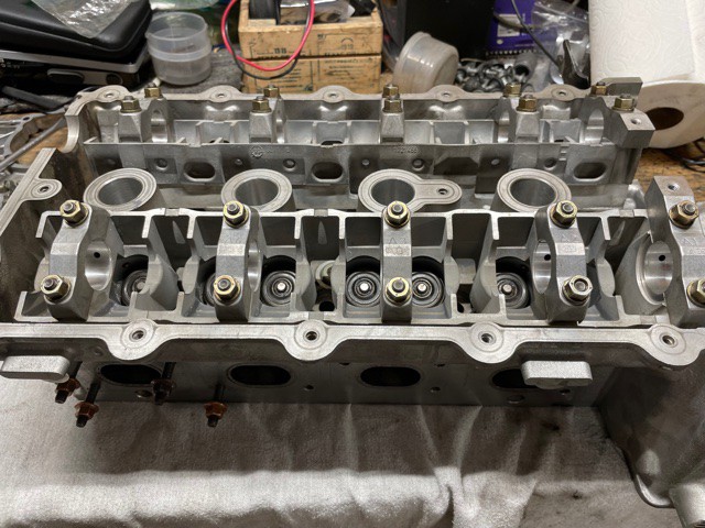

            I'm now prepping the head. Based on a blog post (referenced on page 1), I'll install the cams on the bench. When we install the head we will move the piston tops down to ensure valve/piston clearance.
            I'm going to assume that I do not need to plastigauge the valves and pistons b/c the valves when seated do not extend past the cylinder head surface. If this is a bad assumption please let me know!

              The valves and pistons are of an interference design, although if the timing is correct they will not contact. So under normal, proper operating conditions you should not need to check piston/valve clearances.

                Next question. Now that I am about to put the cams back in I see it may be more complicated than I thought.
                Looking for cam tray bolt torque specs + order of operation to install the cams without breaking them. I don't have the cam installation tool but am reading don't need it necessarily.
                $81 option: https://www.amazon.com/TT-9029-CAMSH.../dp/B01BKU40P4
                Been googling but have yet to find a concrete walk through. Anyone have something they can point me to, I'd appreciate it. I'll post what I find here too.
                Reference to camshaft bearing cap torque: http://www.m42club.com/forum/index.php?topic=13245.0 - 11 ft-lbs.
                The bigger question is the process to install the cam without breaking it.

                  You don't need the tool it's easy. To install I just snugged down nuts on one side of the caps the whole way along, then did the other side a half turn at a time, up and down the length of the cam, so it slowly pulls it down against the valve springs. I'm not sure it's the factory approved way but it works

                      #40
                      To summarize:
                      • Liberally apply engine assembly lube to rotating surfaces (both sides of journal + cam).
                      • Lay cam on tray
                      • Lay caps on top in correct order
                      • Install cap nuts, but only just finger tight. Try to keep cam even across the journal.
                      • Start on one side (either left most or right most) and tighten one of the nuts 1/4 turn.
                      • Repeat across length of cam, tightening the same nut (on each cap) 1/4 turn
                      • When reach the end, start over at the other side and tighten the other nut 1/4 1/2 turn
                      • At this point all nuts should be 1/4 turn in.
                      • Repeat again and again until you have "walked" the cam in and the nuts are against the stop.
                      • Repeat one last time, torquing the nuts to 11 ft-lbs.
                      Cam tray nut torque guidance: https://www.bimmerforums.com/forum/s...m-Torque-Specs
                      Most likely 1/2 turn is fine too. The goal is to keep the cam even, no big bends.

                        Yeah, that sounds about right. For the 3rd step, I would not necessarily even make them "snug", but rather get both nuts on each cap such that they are both barely finger tight and also holding the cap about even across the journal. Basically, don't cock the cap at a big angle at any point and it'll be fine. Risk of breaking the cam is low this way, but you also want to avoid any situation where caps are scraping on threads and making aluminum dust.
