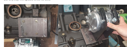

      Making your own bracket for a sanden isn't such a big issue, here's mine i made to suit a sd5h09 sanden.
      just a flat bit of steel and I bought the already laser cut universal bracket things from a local shop, I'm sure someone makes them in usa somewhere.

          I’ll give you my own experience. I spent a lot of time and hundreds of dollars having multiple Denso compressors rebuilt . They never worked, there were always refrigerant leaks from the compressor itself. I never had a functioning air conditioning system until I installed a brand new Sanden. I also replaced the condenser with a Nissens parallel flow, and got a new evaporator as well. With R134a refrigerant, it may not be as cold as R12 was when the system was new, but it is good enough and it just works.
          I got the Sanden adapter bracket and my hoses modified by Lyle at:
          Replace your inefficient, expensive, and hard to find OEM air conditioning compressor with a modern Sanden style unit. Shipping prices are accurate for 1 and 2 brackets only (second one ships free in US). If you need more than 2, please contact me first.

            Can also vouch for this bracket - the photo is from my car.
            All lines-up square so there are minimal problems down the track.
