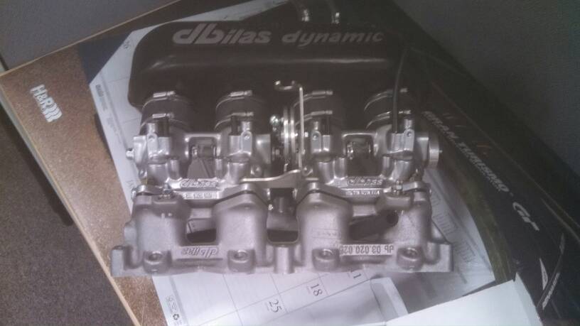

                #97
                Guess what finally showed up?! :)

                  #98
                  Itb's!????!?????

                    #99
                    Sorry for the lousy pic :)

                      #100
                      Kool!!!

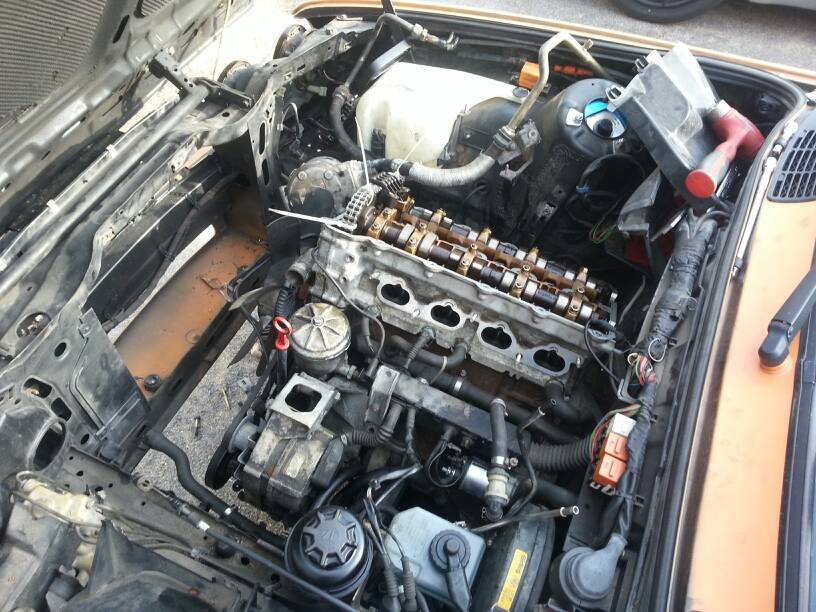

                            #103
                            Started tear down today. A/C almost gone, cooling stuff torn out, no more old intake manifold.......
                            The fun gets to be real fun tomorrow. Pulling the head and preparing for new head with cams, lightweight lifters, 19lb injectors, header.....AND ITB'S!!!!
                            Can't wait to hear this thing.

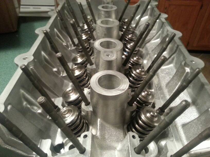

                              #104
                              Sent from my SCH-I535 using Tapatalk
