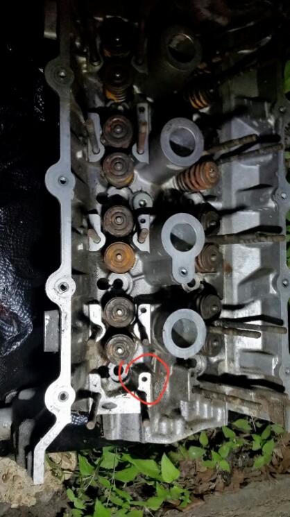

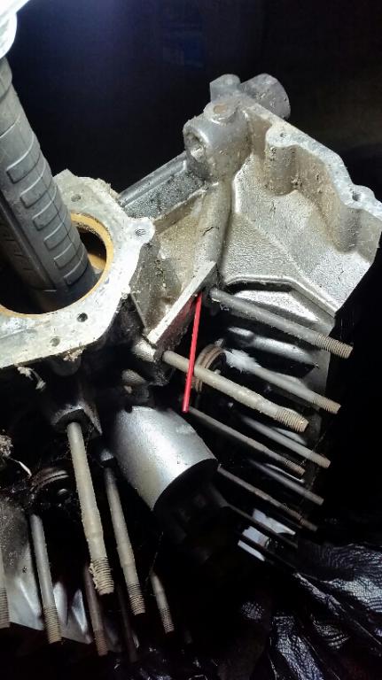

                    • uturn
                      • Dec 2010
                      • 1009
                      Took a picture of the oil passage to the tensioner. Under the exhaust camshaft tray.
                      • uturn
                        • Dec 2010
                        • 1009
                        Maybe pull the cams and chain, crank it to see if this passage is not clogged. Careful oil might spurt out of all the other passages. I'd like to see the mess it makes!

                            • bmwman91
                              • Oct 2004
                              • 3134
                              Aah yeah, you are right, the tensioner is in the head not the case. I was thinking of the oil sprayer that shoots oil onto the chain as it slides up the tensioner rail.
