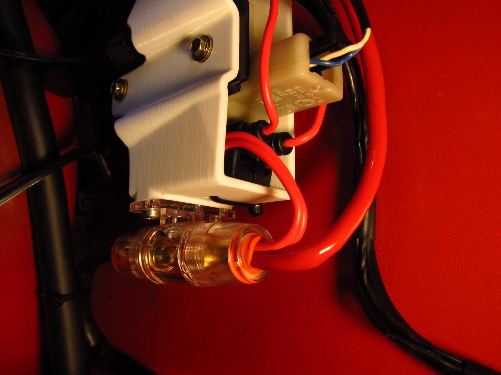

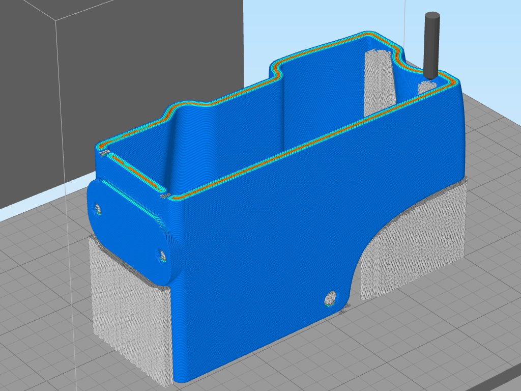

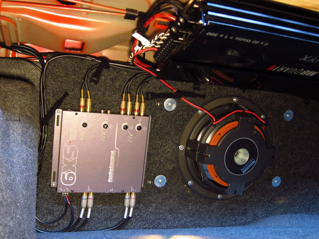

    In other news, I ripped out all the power wiring for my sound system and redesigned how I want it all to route. Everything worked fine before, but there was a jumble of fuse holders and wiring next to the battery which I disliked. I'll detail the new wire routing scheme in my car audio thread, but basically it will all run along the driver's side fender in the outermost bulkhead cavity, with a 3D printed fuse holder mounted to the gas door lock solenoid bracket. This way everything will tuck up inside behind the side panel covering, guide the cables and eliminate the mess that was by the battery (I did the sound system & wiring back in 2008/9 and was a lot less competent then).

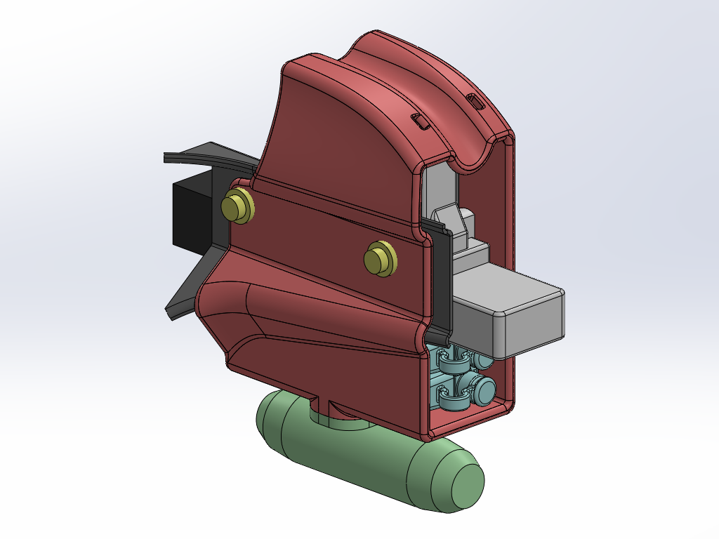

    The first version is in the printer now. The new fuse holders and power cable are coming from Parts Express, so I made models based on the existing stuff. An hour or so with calipers was all that was needed to get the lock solenoid and its bracket modeled well enough to work with. Once I get the actual stuff I will update the base models, and it should all regenerate properly since the big holder/bracket part is fully top-down parametric with the stuff around it. At ~7.5 hours per print I'd prefer not to have to tweak the design more than once or twice.
    The big green fuse holder has the 60A fuse for my 5CH amplifier, and the 2 smaller teal ones have 5A fuses for my 3-way active crossover and the RMT-200 head unit (I am running dedicated power & ground to it all the way from the battery since the factory power & ground are not entirely optimal). The red bracket ended up looking like a space ship from the original Homeworld games IMO.

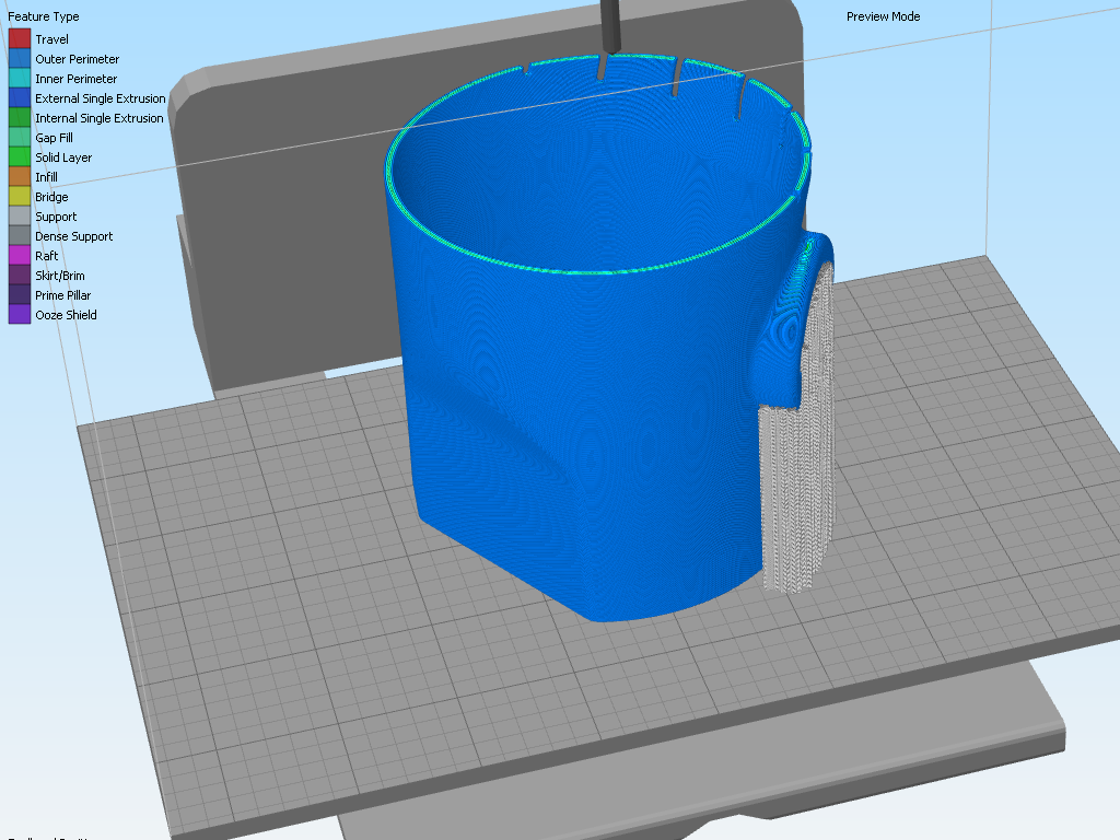

    I spent a bit of time in Simplify3D getting the slicing optimized for the part. My printer is a Flashforge Creator Pro that I have modified fairly extensively (removed second extruder to eliminate vibration, installed TMC2209 stepper drivers for smooth silent operation using custom designed PCBs, designed a clip-on dial indicator holder for precision leveling, used brass shims to remove guide rail slop at ends). It is a decent printer out of the box, but it is a lot better now with the changes and a couple of days spent optimizing the print settings with some test pieces.
    Anyway, I will continue updating as I make progress, whether it be with the actual original topic of the thread (getting the stupid thing running) or other too-much-time-on-my-hands nonsense.

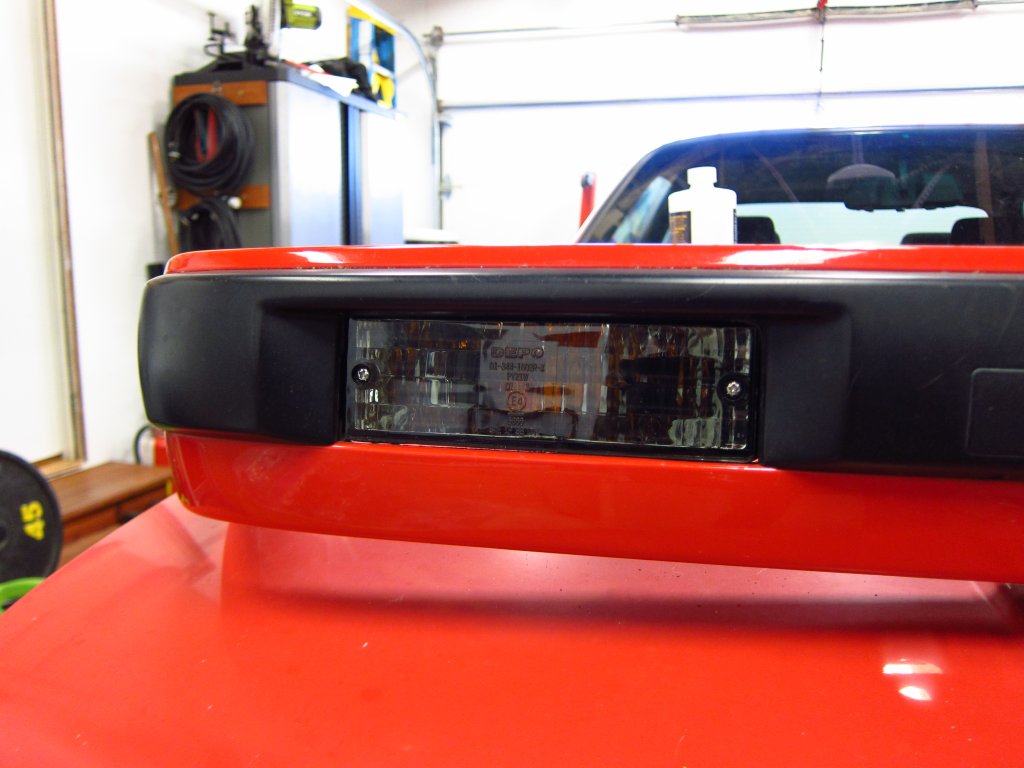

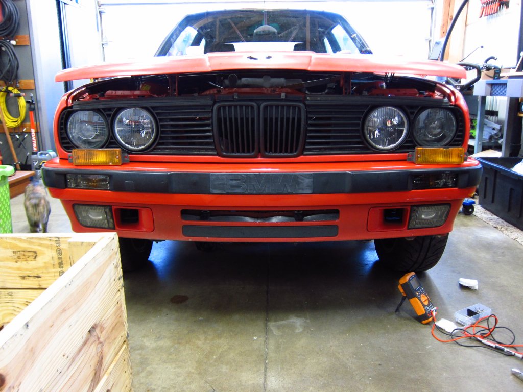

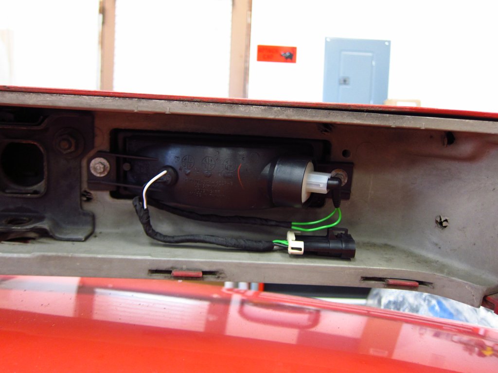

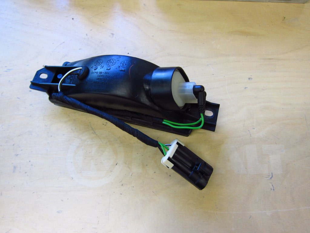

      Beyond that, I am basically done with all of the chassis electrical repairs and mods. I put the battery in today and tested out everything up front. Since the connector housings for the front bumper indicator lamps turned to dust, I mixed up the wires for the parking lights and turn signals, resulting in a fast-blink behavior. When I pulled the bumper to fix the oops, I recalled that I had some new indicator housings (bought 3+ years ago lol) in a storage box. It turned out that they were Depo smoked Euro units which are not plug-n-play, but super simple to get hooked up compared to the rest of the stuff I have done recently.
      The units do not come looking like this. They only have the black + white wires sticking out, and an empty receptacle for the turn signal. However, the US version just uses a 3-position plug. I had a bunch of the repair wires with the rubberized 2,5mm round terminals, so I built a new sub-harness with those and wrapped them with the same Tesa tape I did everything else with. Connectors are Delphi Metri-Pack, which I m sort of regretting buying so many of because they are a little bulky. Oh well, they are economical and easy to work with. The new connection to the main harness just nests neatly up inside the bumper, and the extra stiffness from the tape wrapping keeps wires formed into place pretty well.
      Overall I think that they look a lot better than the hazy 30 year old ones. These use amber-tinted bulbs.

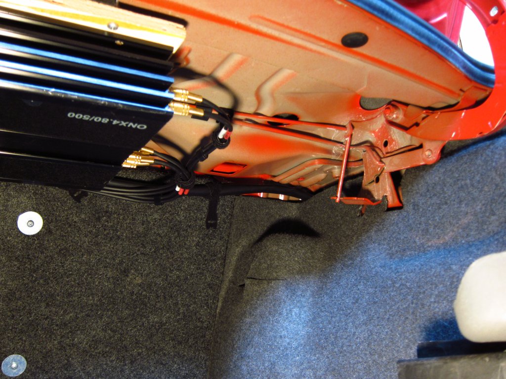

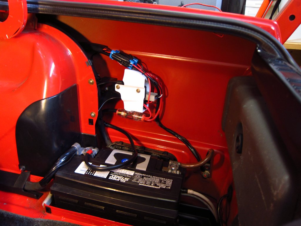

      I got the sound system power wiring in the trunk done as well, with the fuse holder bracket thingy just finishing on the printer this evening. When I get that installed tomorrow I will snap some pictures. Other stuff that I finished and didn't take photos of yet include the pad wear sensor cable and mounting all of the HID ballast stuff on the plastic baffles that conceal the headlights in the engine bay.

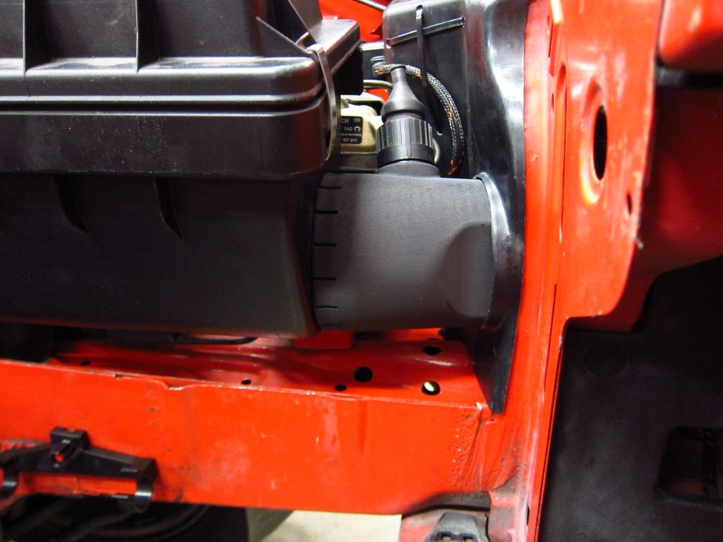

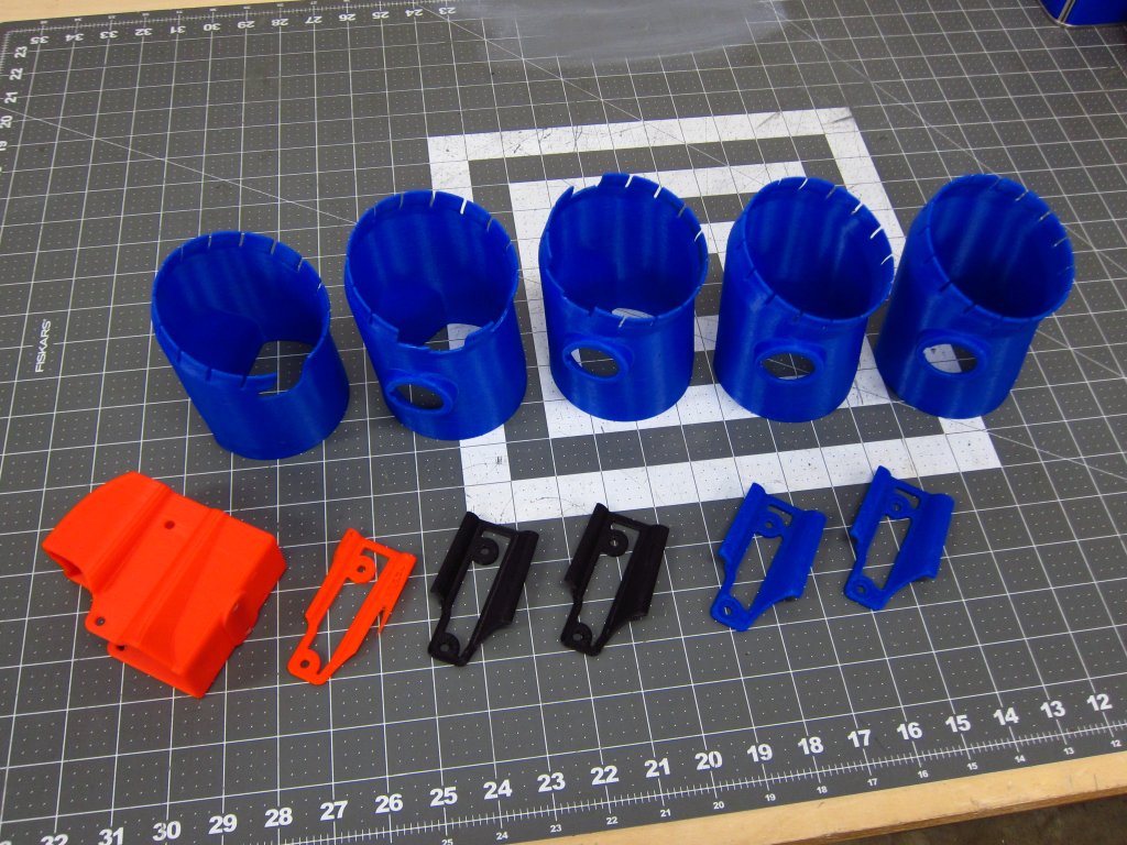

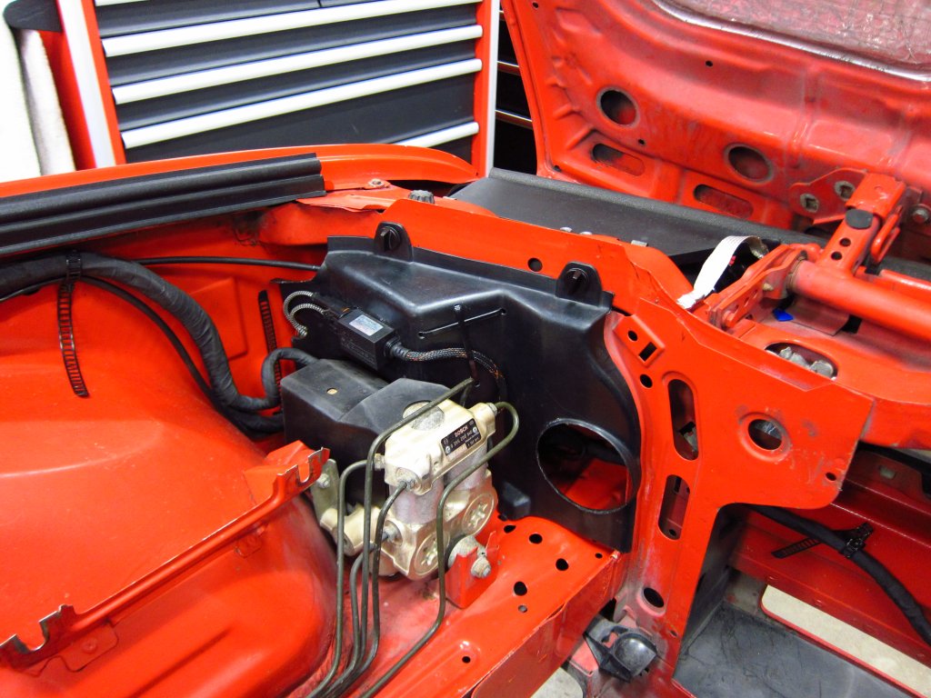

      Also, I came up with a better air flow adapter to link the M30 air filter box (65% more filter surface area than stock M42) to the baffle behind the headlight. I went through 5 revisions on my 3D printer, and had the final one fired off in SLS Nylon. The PLA parts out of my printer will not hold up to the temperatures under a hood (you need to keep them under 60°C to avoid creep and sag), whereas the Nylon will have no problems.
      The M30 air box inlet is to the side and above the opening in the headlight baffle, and the metal radiator support sort of gets in the way. It took several tries to get the dimensions exactly where they needed to be. Installation with the air box is a little tricky, and I had to design the adapter so that it would slide ~2" forward into the baffle when installing/removing the air box and then slip out and onto the inlet. I also moved the air temperature thermistors for the ECU and my MAF converter into this tube, rather than just being zip tied up inside the filter box. They were crimped into terminals and installed into the spare 4-position round connectors I have left (the same one used for the O2 sensor). In the future I will probably fully move the MAF converter inside of the Motronic case and put the thermistor into the MAF, but that is a different project for a different day. I'll get some shots of the finished part and connector arrangement in the near future.

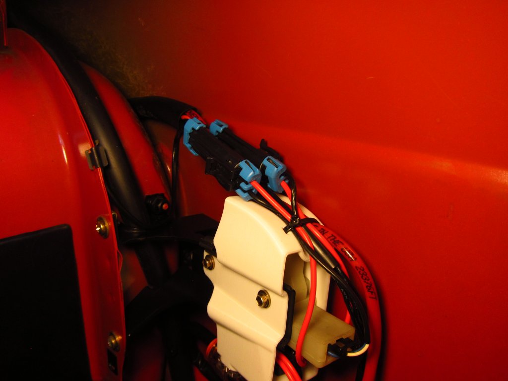

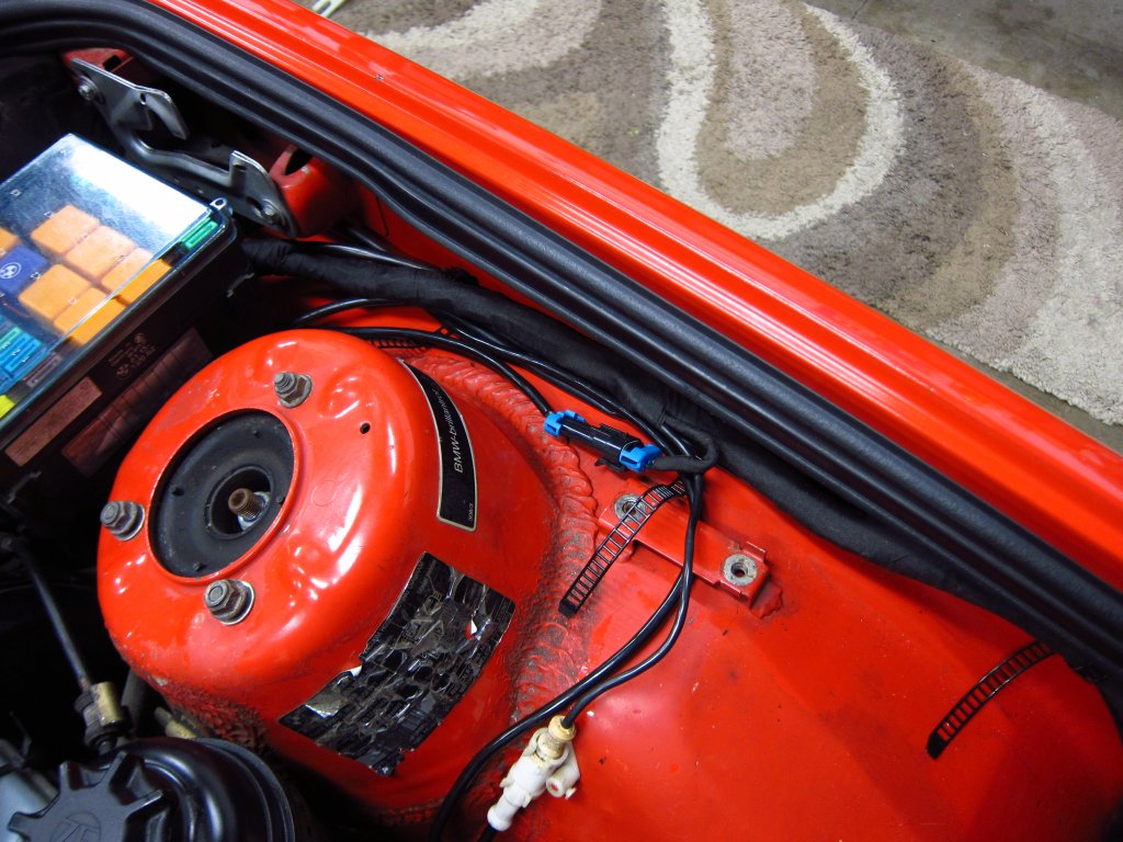

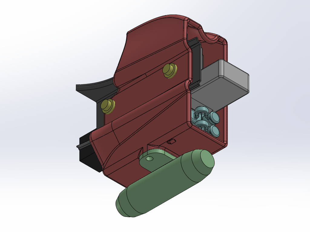

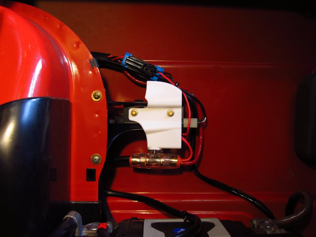

          This is the final fuse holder / wire guide bracket as it now sits installed in the car. It is not exactly OEM-neatness, but it is a hell of a lot better than what it was like before, and there is nothing rattling around next to the battery or catching on it anymore. Getting the gas door lock plunger back into the rubber bellows was also easy, but only because I cleaned it (plunger and bellows) and applied a little silicone lube to the plunger. Otherwise it would have been impossible with the fuse holder in the way since it was all sticky and gross. Also, I was going to replace the rubber bellows and mating piece on the outside, but the bellows is like $70 lol. This one is just a little old and deformed, not torn, so I put a little RTV around the perimeter before reinstalling it which should (hopefully) be enough to seal it.

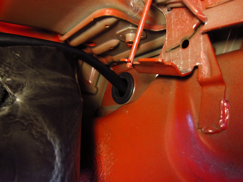

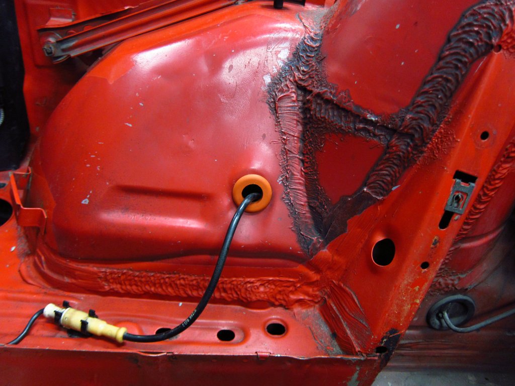

          As mentioned before, I ran the power wiring through an opening in the bulkhead on the passenger side, and through the space above the rear wheelwell. There is no grommet there normally, and the opening is 50mm in diameter, so I just bought a grommet on McMaster (9600K328) and installed it to prevent anything from rubbing on a sheet metal edge.
          And there it is, all cleaned up and no longer running on the floor of the cargo area! It used to run parallel to the main positive cable from the battery, but it was still ugly.

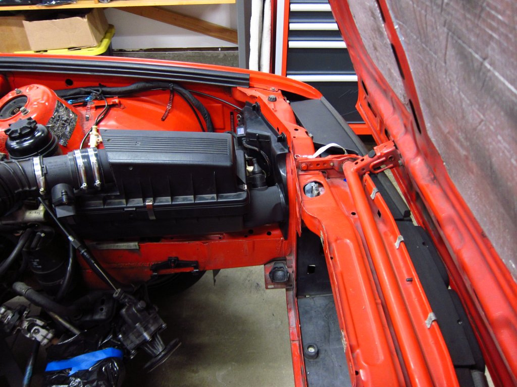

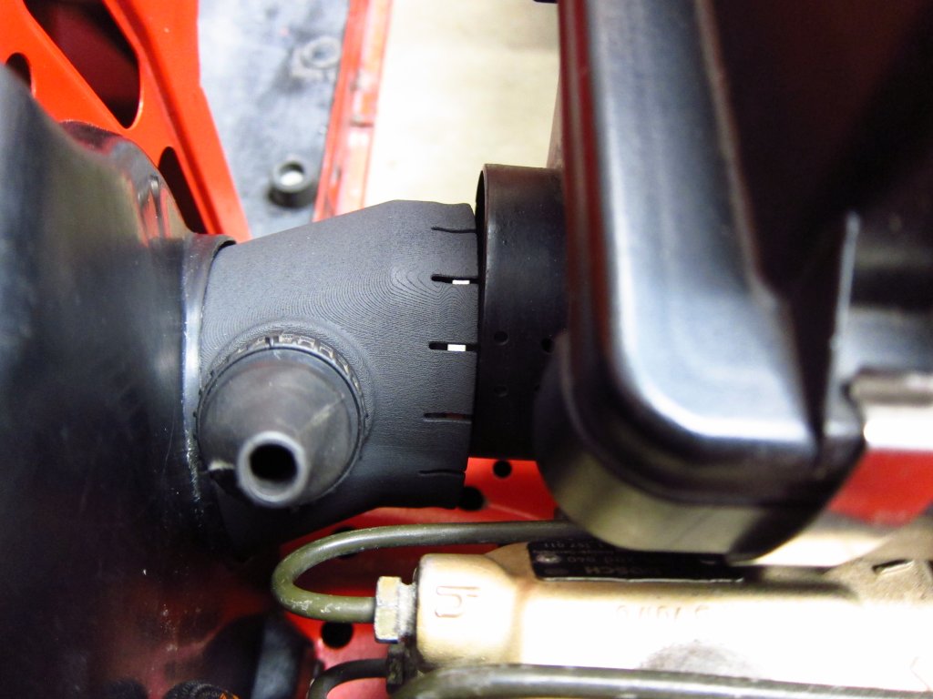

          This is the final adapter for the M30 air box. It is SLS Nylon, with some flat black paint. It also has the connector housing which I used as a holder for the IAT thermistors.

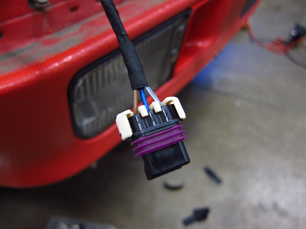

          Here it is installed with the M30 air box . The MAF is a VW unit that I developed a converter for, and lots of the other wiring I did in previous posts was to make the converter box integrate more cleanly with the factory harness.
          It is a tight fit in there, and the adapter has to slide into the headlight cover about an inch in order to allow the air box to be installed / removed.

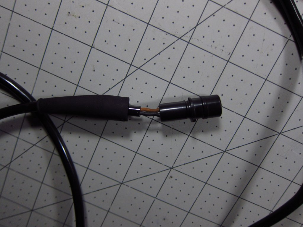

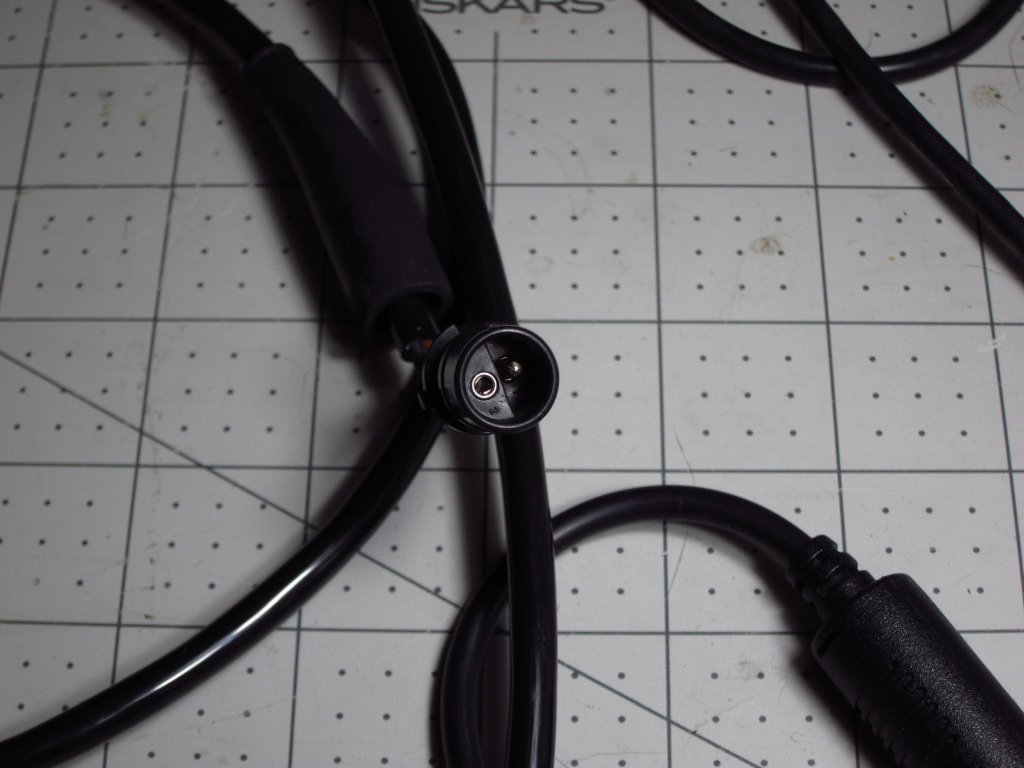

          Here is the connector that splices in the replacement brake pad wear sensor cable. I left a LOT of extra length in it (it loops up by the fuse box and then back down) just in case I need to do future repairs, or I decide to re-route it someday.
          Also, I replaced the decaying grommets in the holes that the ABS sensor and pad wear sensor cables pass through. There are also McMaster parts (1061T67), made of high temperature silicone.
