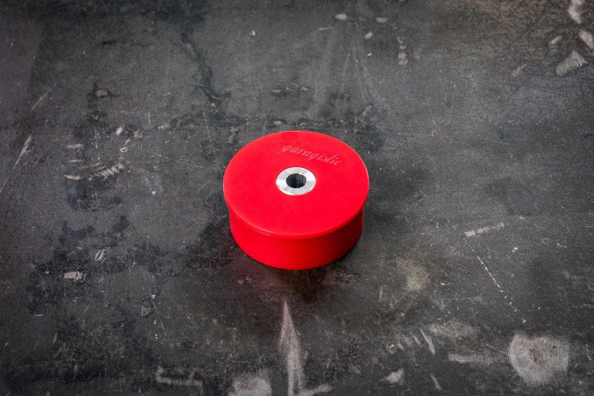

    The Z3 one is an upgrade and when you see them side by side with the original it is quite a bit stiffer. Its also way more expensive. There are poly ones that are not rough. Garagistic offers some different options.
    BMW CENTERED POLY/DELRIN DIFFERENTIAL BUSHING- 33171135242 Overview E30 bushings tend to be overlooked and do not age gracefully. Your old E30 diff bushing has seen a lot of wear and tear and time has taken a toll on your differential bushings. The importance of bushings on your E30 is not to be understated; make sure
          https://www.garagistic.com/collectio...0-e36-318ti-z3
          Ahh, yes $220 vs $80

                I think its the closest you can get without going poly. I wouldn't get anything garagistic.:(
                Id say its louder, if you're diff is loud you may notice it more. Check the ebay link, they are cheaper.
                But not as loud as poly, If concerned, id stick an OEM one in, I think sub frame bushings may transmit more sound.
