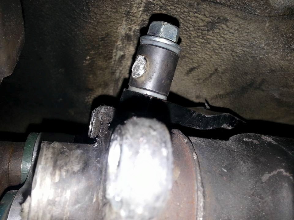

                • MonkeyMadness

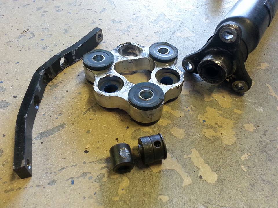

                    #624
                    And this was the total carnage of the weekend.... :blowup:
                    • silence
                      • Jun 2007
                      • 1824
                      #625
                      ouch.

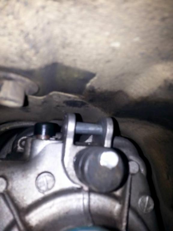

                      • CorvallisBMW
                        Long Schlong Longhammer
                        • 13039
                        #626
                        Holy shit... is that the revshift guibo?
                        • JGood
                          • Jan 2004
                          • 7959
                          #627
                          Did the bolts break, or did they come loose? There's no reasonable amount of torque that should break those bolts.
                          I did a similar thing with my old e30 track car. Guibo exploded... Broke the driveshaft, transmission case, shift linkages, etc... Costly mistake.
                          e30 restoration and V8 swap
                          24 Hours of Lemons e30 build
                          • 36brua
                            • 689
                            #628
                            yikes ! what drive shaft are/were you using ? revshift big>small guibo ? ZF > E30 d'shaft?
                            did you kill the rear trans yoke?
                            My CA legal M60 swap
                            The happening in our garage
                            • MonkeyMadness
                              • 3251
                              #629
                              Yes.. :(
                              Bolts broke... I have a feeling it has something to do with the poly inserts.
                              if you all remember I blew a center shaft bearing a while back. turned out i had the washers on the wrong side. SO i fixed it and noticed that Revshift changed there poly compound with out telling anybody...umm
                              didn't think to much of it... my bad
                              I was using a eta drive shaft with a 24v swap guibo
                              This was the most skechey part of my hold build and only thing that I bolted on with out building myself on this whole build. I took it for granted that someone else did there job.. I found my weak link an blew it up....
                              live and learn..
                              I think I'll take a page from the LS/5.0 guys an build a single drive shaft with dual u joints?
