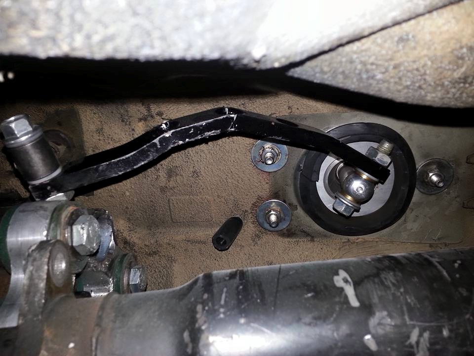

    So I was able thankfully to save my weighted shift rod...
    It looks bad in the picture it got munched hard sadly but thankfully I was able to repair it to it's splendid glory.. Out of all the carnage this was the one thing that bothered me the most... I dreaded making another one and I was so proud of it when I first built it..
      [ATTACH]100019[/ATTACH]
      How much of a difference does the weighted rod make?
        tons... this linked with an AKG it makes our stock trans box feel and shift like racing boxes...
        IF you get the right weight the throw is firm but effortless...

          #649
          Is that a crack I see in the countersink for the middle hole? It's right in the middle of the small patch of glare from the light (flash?)
          • MonkeyMadness
            • 3251
            #650
            wow looks like it, but thankfully it's just chipped paint.
