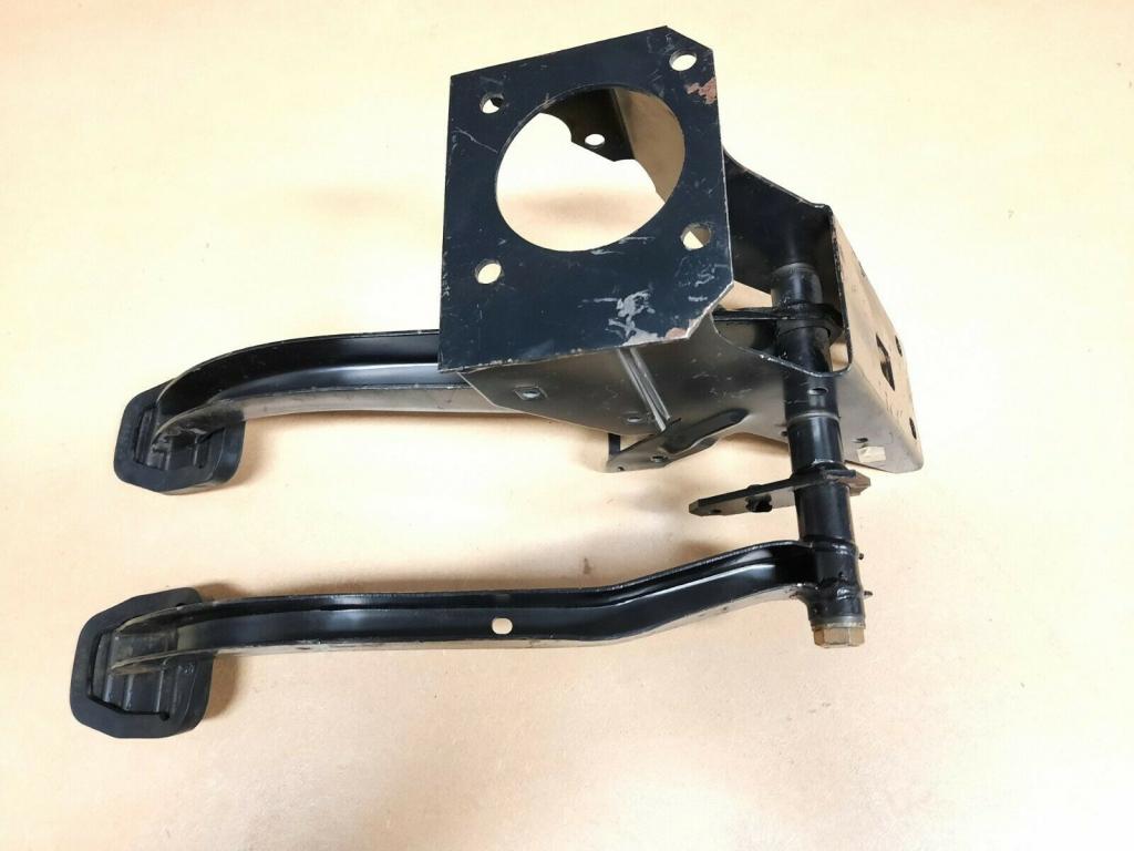

    Hey guys. Can someone please tell me where the top of this clutch pedal spring gets hooked to?
    Thank you a lot
    Thank you a lot

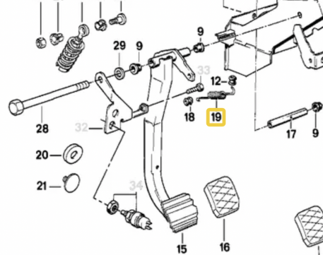

                  is this the one?
                  • zaq123
                    • Jul 2016
                    • 1560
                    Originally posted by digger
                    is this the one?

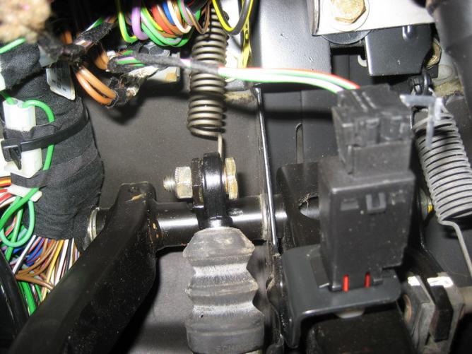

                    looks that way..Is that bracket where the spring goes bolted to the main pedal box? Here is the similar setup (pic) but no such bracket and the spring (in the pic) is clearly was used somehow. Sorry for all these questions. My car was auto so I have no idea how it supposed to look like.
                    Real OEM has some bracket shown but it's not highlighted/listed as a part (#32). Anyone has that part fiche where the part number for 32 is listed?
                    https://www.realoem.com/bmw/enUS/sho...84#35211102383
                    Click image for larger version  Name:	Screen Shot 2022-02-16 at 10.59.52 PM.png Views:	0 Size:	188.8 KB ID:	10046618
                    • zaq123
                      • Jul 2016
                      • 1560
                      found #32, it's not it WTF
                      https://www.ecstuning.com/b-genuine-...t/35111156504/

                            I think it's the hole that is on the gray brace to which the black pedal bracket is attached with bolts.
                            The hole is right in front of the black bracket.
                            I can't make a photo because it's behind the wires.

                              Thank you, is your car grey? I have metal brace (part of the column) and the body colored support where the steering column/pedal box gets bolted to. Here is a picture. I see one possible hole in the support where it can go . Is this it?
