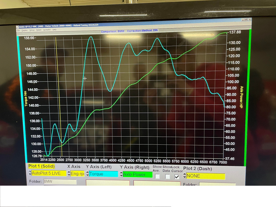

    Hi. Are there any experts or experienced people with tuning m52tub20? I drive a racing class with restriction of 2,0L engine and maximum 160whp. I currently have 137whp with this setup:
    M52tub20 engine, singlemass flywheel, exhaust headers and straight pipe, m54b30 cams and air intake, lightly ported exhaust out of engine. Chip tuned with regards to 208CC fuel nozzles with m54b30 air intake.
    After reseraching on the internet my estimate would be closer to 150-155whp with my mods, and i have some questions around this.
    I have an adapter plate that limits the b30 intake from i guess 3,25" to b20 3" to fit my throttlebody so i can have drive by cable, and not have to install a electronic gas pedal, can this be a big reason for limiting my whp gain, or what more can be changed.
    I have my dyno charts.
    I am also wondering if a better engine for me would be m52b20 because the m54b30 with be a bigger upgrade in this engine than in the m52tub20
    Hope somebody can help :D

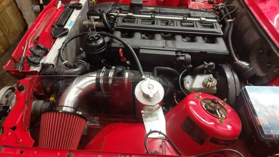

                      Picutres of setup?
                      @Zakspeed_US
                      • Norwegenbmw
                        • Mar 2022
                        • 10
                        I have siemens ms42. I have performance headers and straight pipe 2,5" exhaust with 1 sound muffler.

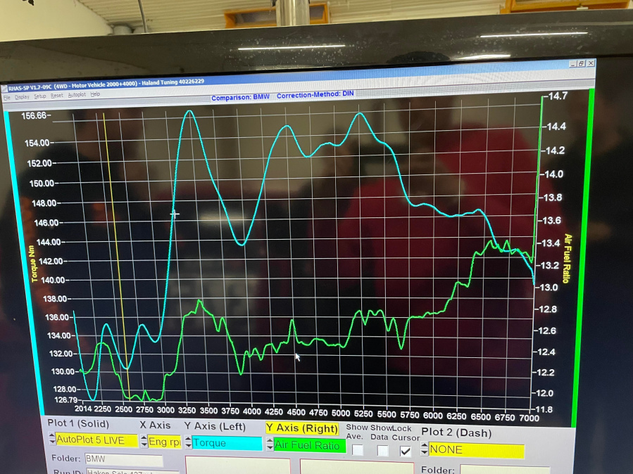

                              Hi. Just a small update.
                              I had the car on a dyno last year and got the result 137,8 wheel HP.
                              This was in 3rd gear, dont think it matters much but in my gearbox ZF 328/m3 the ratio 1:1 is 5th gear.
                              The car was running lean after 5000rpm? and the horsepower gain didnt go down when reaching the limiter, so i believe there is a few more HP still to gain?
                              I have now installed the correct 2x lambda o2 sensors pre cat and the 2x behind is removed from ECU.
                              The temperature sensor on the engine is now installed, from before it was hanging out in the engine bay.
                              I will in the next weeks recieve a new chip tuning adjusted with more fuel on top and also rev limiter to 7200rpm.
                              Hoping this can better the air to fuel ratio and free up some more WHP.
                              m52tub20
                              Exhaust header, straight piped
                              m54b30 intake and exhaust cams
                              m54b30 intake but m52tub20 air intake boots
                              Chip 7000rpm, hardcut, 98octane fuel, better ignition,
                              Single mass flywheel
                              Car weight 1050kg
                              Click image for larger version  Name:	297685075_1364375450720475_5902859821304344383_n..jpg Views:	0 Size:	266.8 KB ID:	10081394Click image for larger version  Name:	297937292_765703021409619_9082115923933204541_n.jpg Views:	0 Size:	308.7 KB ID:	10081395
