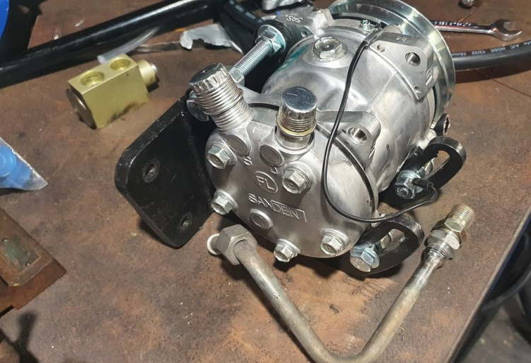

        buy one of these as well as a brand new sanden compressor to suit. i made my own braket here in australia, and used an SD5h09 compressor. its tiny and very light compared to OEM.
        Replace your inefficient, expensive, and hard to find OEM air conditioning compressor with a modern Sanden style unit. Shipping prices are accurate for 1 and 2 brackets only (second one ships free in US). If you need more than 2, please contact me first.

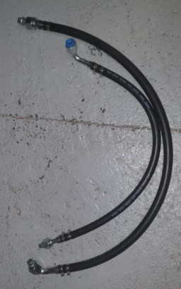

        - make new hoses to suit. I made my own hoses using a hand crimp kit. they have to exist in usa too somewhere. or get a hydraulic shop to make them. its not rocket science, im sure you can find someone to make them, even if they have to do it remotely.
        Making my own hoses cost me like 200bucks. This is the supplier I used, but its in Australia, but there has to be something similar local to you.
        I had to braze a fitting onto the oem hose, local shop did it for cheap.

              I just found some photos for you I put in in here,
              Yes the compressor comes with either a V belt (mine has 2 belt pulleys in one). and there is one for the more "modern" ribbed belt. You can see in the photos that i used the most forward v belt pulley, and it only just fits with the crank sensor. I think i mention in the above thread i made a mate of mine one, for his car and i placed the compressor lower for more clearance. I am not sure exactly which sanden the LC wylie co bracket suits. but its a sanden something. edit: Just saw they offer a complete kit, that's not a bad deal really, hard to beat if its a bolt on affair.

              and yes the crimping of the lines really was that easy. The crimp tool they supplied me was about 40bucks. I cant find a photo but it wasn't that special. you can see in the fittings in the above link, they have 2 rubber orings on the fitting itself, then you put the pipe over and you put 2 crimps on, which you can see in my the photos in the link. honestly it took like 20mins to do all of them and they have been working fine for years. But you have to get a fitting welded/brazed onto the OEM lines as bmw use some obscure connection. I was going to get lines made up but i'm a tight ass so went the DIY route, that has worked out well.
              The low pressure side is one size of pipe/fittings, and the high pressure side is another size. I cant remember which was which but you match it to fittings on the compressor.
              Its high pressure but it isn't that high. ~300psi is up there, but its not thousands of PSI like hydraulics.

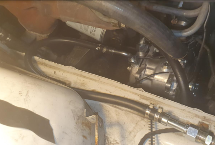

              couple of other photos below. The photo of the compressor on the bench, you can see the OEM bmw hardline from the dryer, that I had a generic AC fitting welded onto. I did on the same on the hose that wraps around the strut tower.
              There's plenty of ways to skin a cat as they say. but this is the way I did it.
              its up to you but i would not at all bother with the OEM compressor. they are so big and chunky. I tried for ages to find someone to rebuild mine, or even buy rebuild parts, just too old to find anything. Specialist companies seem to be able to do it, but it costs a bit, and you are sitll stuck with an old heavy compressor. Swap to one of these sandens, they are like 200bucks usd brand new, maybe even less. then if it ever breaks you can swap in a new one and keep going.

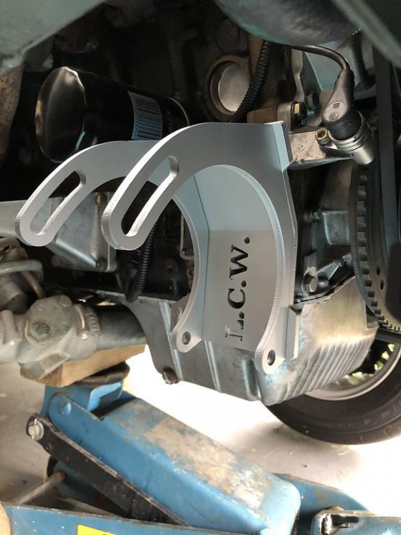

                    Another happy LC Wylie customer here. Lane was great to work with. His conversion bracket is well engineered and made. He can sell you modified soft lines with updated hose and fittings for the compressor. He can also help you buy the correct Sanden compressor and correct belt.

                              +1 L.C. Wylie kit. He is very helpful and answered all of my questions. Yes, you can save money piecing the kit together yourself, but it's the custom made lines that will be an issue tracking down. The kit is worth the price and saves a lot of headache.
